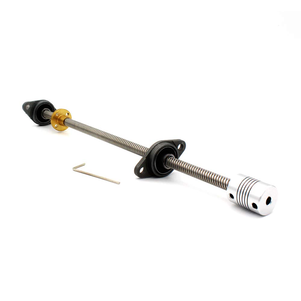

- It's probably best to use a leadscrew, pillow bearings, and two limit switches (not shown) in the horizontal drive mech.
-- It's far more durable than a scotch yoke .
-- Used in the Z-axis of many 3d printers and CNC machines.

- The lead screw coupler connects directly to the motor shaft to power the horizontal drive train.
- The lifting arm will use 608 roller bearings, so that part will be very quiet.

Made an OpenSCAD 3d printable mount for the lead screw bearings shown in the first pic below.
- Fully parametric.  Change any of the 12 variables to alter the part as desired.
- Part renders in the correct orientation for the strongest print.

You may want to avoid this type of bearing.
This type is the better choice.
- Less hardware to mount. (2 screws per bearing vs. 4)
- Stronger mount.  (A flat vertical spacer is less likely to break than the L-shaped bracket posted above.)
« Last Edit: August 27, 2019, 12:03:10 am by PL1 »
