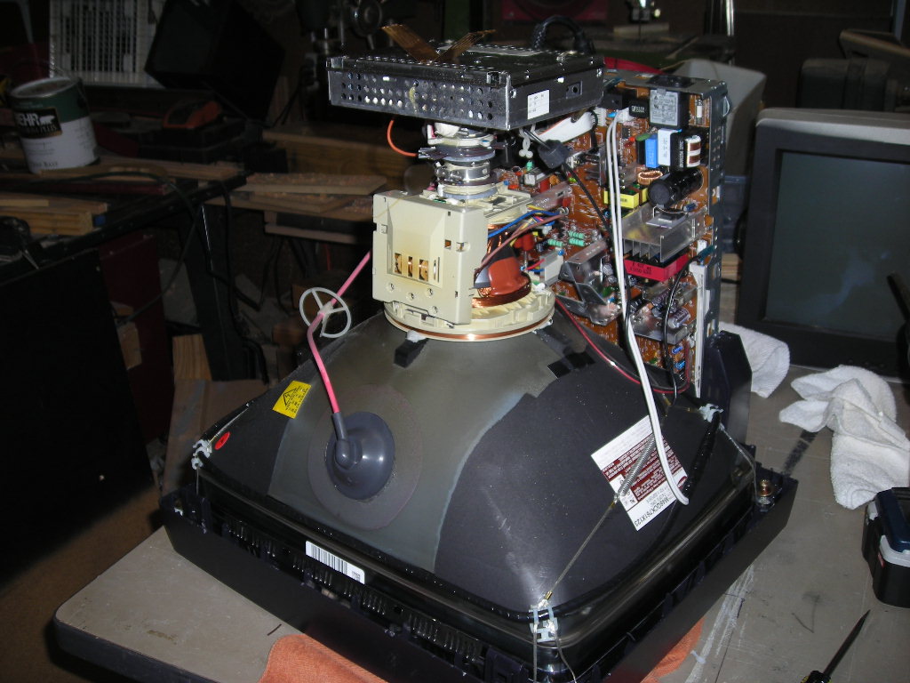

I replaced the monitor of my New Astro City with a Kortek (aka Betson Imperial) because the original monitor had scratches and burn in.  The monitor is mounted vertically.  The bottom right corner is a lot darker than the rest of the screen.  It looks like it needs degaussing, but degauss doesn't help.  I moved the arcade around to a different location, but that didn't help either.  Any ideas how to get rid of the dark corner?
To make the Kortek fit in the New Astro City, I had to swap the mounting frame with the original monitor.  Some tall and large metal things (heat sinks?) exist on the PCB near the dark corner.  Is it possible I mounted the monitor's PCB too close to the tube, causing this issue?

Maybe dark corner is not the best description.  The corner changes its color depending the color displayed.  The corner is black for white, red for blue, green for red and blue for green.  The issue goes away when I tilt the arcade.
Here's an image of the corner where I mounted the PCB.  Is it too close?

« Reply #3 on: September 10, 2013, 09:03:32 am »
The issue is related to magnetism! Keep in mind, the monitor was likely built and tested in the normal Horizontal mode... you have now changed it to vertical/Portrait mount.
A good degaussing may help, but the best fix is to re-adjust the purity rings.
Few simpler band aides... if the monitor has a "Rotation" control, try that other wise a small magnet in the bad corner.

« Reply #6 on: September 14, 2013, 03:23:19 am »
I don't think the monitor is intended to have the brightness cranked way up... Give it a try. :afro:
Indeed they are not.  Doesn't stop them from shipping them that way, of course.  "Brighter is better" after all!
The brightness (black level) probably needs turned down, but the contrast will affect this more, if there's going to be a setting like that that affects this.
It does look like just a purity issue probably caused, as Rick said, by it being rotated.  Some monitors will "dome" due to heating of the shadow mask.  This is caused by them being cranked up WAAAAAY too high.  The Makvisions are commonly shipped in this state, but the Betson/Korteks don't seem to do it as badly if at all, even at the default "cranked" settings.

« Reply #10 on: September 16, 2013, 11:30:02 pm »
can u provide a not so close up picture of how your degauss coil goes around the back of the picture tube (it looks sort of bent in a non-standard way?)   maybe repositioning the coil is all you need to do.   eg. see pic below... try to get the coil very close/touching the glass if possible.  of course just incase you are not aware, any adjustment you make, you will need to wait for the tv to completely cool down before retrying, as the degauss circuit only functions from a cold start

Thanks all.  I couldn't get the magnet to work so I did carefully adjust the purity rings.  It took me a lot long than 60 seconds, but I was able to fix the issue.  The purity rings were not sealed, but they were locked.  After loosening the lock a tiny amount, it was easy to adjust the rings.
