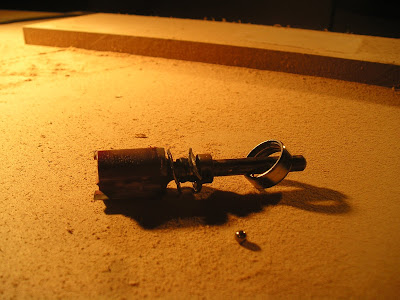

Last night I was cutting out some openings in an MDF panel and I had some clean up to do on the edges.  I typically use my pattern bit and a straight edge to do these types of cuts.  Anyway, there were a total of 6 edges to clean up and right in the middle of cut #4 my router bit basically exploded.  Check it out:
I am lucky that I didn't get hurt and also that the router did not cut into the panel and ruin it which could have easily happened. I only found one ball bearing (I have no idea how many were actually in there). The ball bearing casing just gave out - the bit is a few years old but it was still cutting well. I learned a valuable lesson without getting injured - ALWAYS wear safety glasses.  I swear this was the first time ever I didn't have them on because I was trying to make a very precise cut and I can't see as well when I am wearing them.  Never again!

Buy Amana or FS Tool if you want quality carbide tipped bits.  If you can't find them, let me know and I can hook you up with a high quality bit.  I distribute both brands.
MDF dust wreaks havoc on bearings.

Ensuring to clean out the bearing races, or at least make sure the bear ing is smooth running before any cutting should cut down on this...
I've got some nice ones i've got from Stew-mac guitar shop supply (i repair guitars professionally) But i did catch one of them with some grit in the bearing race, I blew the grit out and then lubed the bearings. it has been fine for months since then... But small steel balls dropping onto a metal bit spinning at high speed would be unpleasant.

This is the exact thing that happened to mine.  Porter Cable, from HD.  It was my fault for not keeping up with the oiling in between cuts.  I have to say the one tool that keeps me on edge is when using my table saw, especially for smaller pieces.

I'm not sure who makes the Porter Cable bits.  I'm fairly certain they're just private labeled though.
His carbide was fine (correct me if I'm wrong), it was his bearing that crashed.  MDF dust is BRUTAL on bearings.  I have customers that cut MDF every day with flush trim bits and they change the bearings once a week.  They'll buy one bit and a 10 pack of bearings.
So is my bit salvagable?  You are right - only the bearing broke - the bit is fine.   :cheers:

If only the bearing was damaged then your bit just needs a new bearing.  I would carefully inspect your carbide for chips though just to be sure.
What you need to know is the I.D. (inside diameter -- probably the same diameter as the shank) and O.D. (outside diameter -- should be the same as the diameter of the cutting edge portion of the bit).  The bearing goes on the shank and then a stop collar goes on top of the bearing.  The stop collar should have a set screw in it.  Loosen the set screw in the stop collar, put a new bearing on, put stop collar back on and tighten.
From your picture, it looks like you have a 3/4" Cutting Edge Diameter x 1" Cutting Edge Length x 1/4" Shank.  You can see that bit here: http://www.amanatool.com/routerbits/pattern-template-routerbits-45481.html
If my guess at your dimensions are correct, take a look at tool # 45464.  Just for reference (no idea what you paid for your bit), we quote that bit at $27.60.  Replacement bearings at $4.35, and replacement stop collars at $3.75 each.  Keep in mind the Amana bits are some of the highest quality carbide-tipped bits you can buy.  They are made for heavy industrial use and their price reflects that.  Also, those are wholesale prices as we are a distributor not a retailer.  That bit would probably be near $40.00 off the shelf at a hardware store.  FS Tool (made in Canada) and Whiteside Machine (made in North Carolina) are also high quality bits.  We distribute both of those brands as well.
