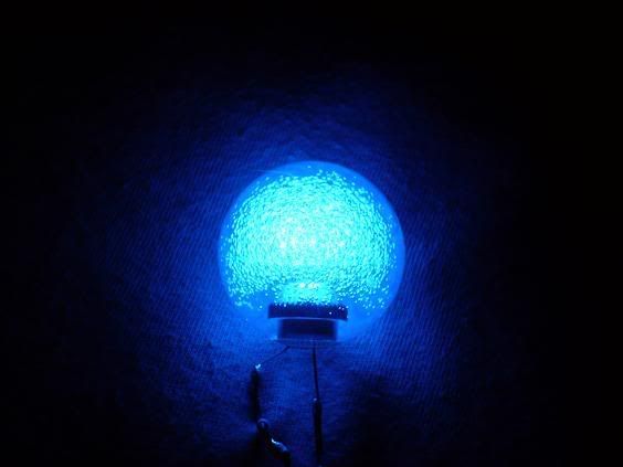

I took one into work with me this morning and also some LEDs I bought from ebay. As you can see from the picture below the insert nuts in the balls are open ended, its a good job other wise no light would have been able to shine though to the ball.
I test fitted one of the LEDs in the ball and the main body of the LED fit nicely inside the bore but it it stopped on the shoulder of the LED. It makes sense really as the thread is M6x1mm so the bore of the screwthread is 5.1mm. This wasnt really a problem as you can easily remove the shoulder with a fine file. Once the shoulder was removed the LED fitted all the way inside the ball leaving about 5mm of thread. This would probably be enough to hold the joystick shaft but I wanted a bit more for it to hold on so I ground of the top of the LED on a bench grinder although you could easily do it with a file, I was just being lazy. The (very bad) picture below shows an untouched LED, one with the shoulder removed and one with the shoulder removed and about 4mm taken off the top.
Once the extra material was taken off it allowed the LED to fit further into the ball which will give the shaft more to grip on.
I then attached a resistor and soldered some wires onto the leads (excuse the soldering, im pretty crap at it but I have 100 or so LEDs to solder for my project so that will give me plenty of practice  :)) Obviously thee will be heat shrink etc on the wires and leads when I do them properly, I was just eager to see the result!
I then gave it 5v from a PC PSU and shazzam!
 :D  :D  :D
That picture really doesnt do it justice, it looks beautiful, you can see every bubble and the brigtness is spot on.
