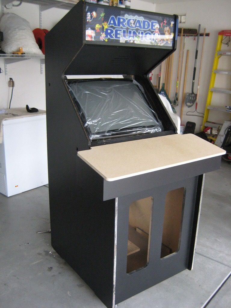

I have a billabs BL27CB0P 27" flat screen monitor that I would like to mount in my TMNT cabinet. Theres plenty of room in the cabinet but the original monitor sat on a angled shelf that I dont think I will be able to use with the new monitor. So I thought I might get some sort of metal angle to run across the top and bottom of the monitor to bolt the monitor to. Does have any pics of this monitor mounted in there  cabinet? Heres a link to the monitor I have. http://www.billabs.com/bl27cb0p.htm

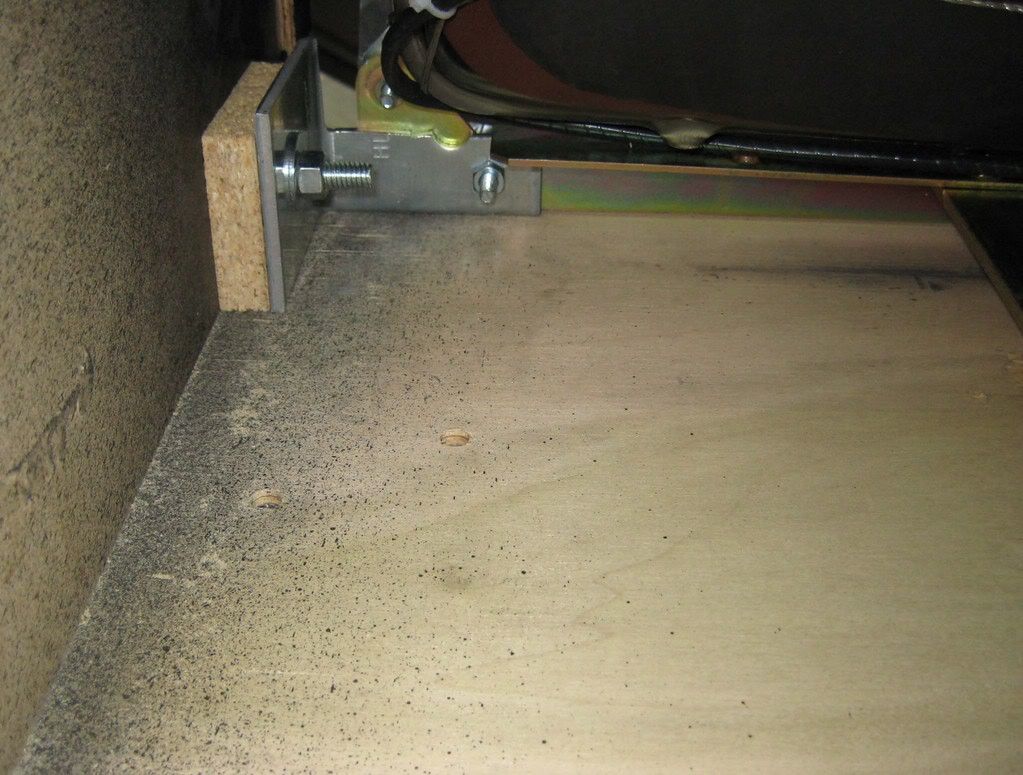

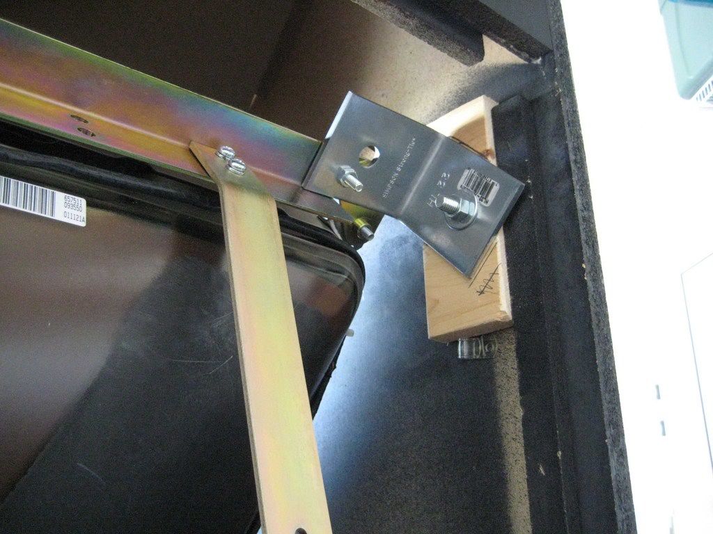

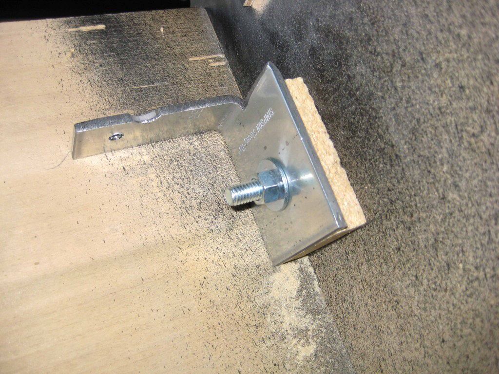

I just picked up a Betson 27" monitor and was getting ready to mount it.  Luckily there were already pieces of wood inside my cab (complete with bolt holes) to mount the monitor.  However, the mounts are for a 25" inch monitor and they have to be moved slightly to accommodate the larger 27" size.  I haven't made the modifications yet, so I can still take pictures of the monitor mounts as they are.  Unfortunately, I'm not at home at the moment, so I can't right now.    :(
However, I will post the pics as soon as I can.  In the meantime, I will try to describe it.  Basically, for the top part of the monitor (3 bolts) the cab has a block of wood on the left and right side which is screwed in from the inside of the cabinet.  (The screws used do not go all the way through to the outside)   Then a piece of plywood is screwed into those pieces and goes all the way across to either end.  On that piece of plywood is 3 holes with bolts.  The monitor then bolts into the plywood.  The same is true for the bottom.
Since the cab already had these pieces of wood in there (originally from when it was manufactured) I'm pretty confident that they are strong enough to hold the monitor.  However, since it's a 27" and a bit heavier than the original 25", I plan to also put pieces of wood or brackets under the monitor for additional support once the monitor is mounted.
Again, all of this can be accomplished by screwing in small pieces of wood from the inside of the cab without having to have an unsightly bolts on the outside of the cab.  The screw should be long enough to make it through the wood you are screwing to the cab, but short enough to not go all the way through to the outside.  When I post the pics I will also include the size screw I used.
** UPDATE:  Pictures posted  **
(excuse the wood filler - I'm preparing my cab for painting)

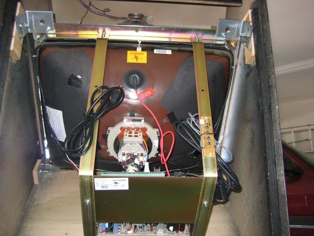

Hey Lakersfan, does your monitor stick out the back? I cant tell if you have the back door on in the pictures.
Sorry about the delay in response. I have been out of town for a few days.
No, the monitor does not stick out in the back. The back door fully closes. However, I did need to remove the brace from the back and mount the main board to the bottom where the monitor sits. I did this once the monitor was installed. I'll post some pics if you need me to, but you'll have to wait until I get back home on Weds...

Lakersfan, Yes I would like to see pictures of that. Do you think with removing the back brace/frame that it would weaken the overall mounting of the tube?
Ok, here are some pics. The Betson monitor has a back support brace that goes from the top brace, around the back of the monitor, attaching to the bottom brace. On the brace itself, the system board is attached to it. I removed that back brace that was holding nothing but the system board. It is a big stabilizer, but once the monitor was in I could easily uninstall the brace without harm to the monitor since it was now fully secured. I then attached the system board to the wood where the old monitor used to sit. Hope these pics make sense of what i am saying....
The back door now fully closes. It does not touch any part of the monitor. It really close, though. Also, as you can see on the last pic, the back door has a little bit of an indented area that was already there (not sure if yours has the same thing). The indention is there, but the neck of the monitor does not use it. I'll be happy to answer any other questions!
