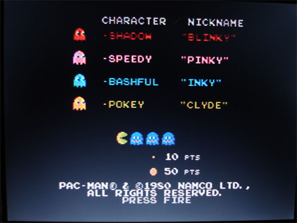

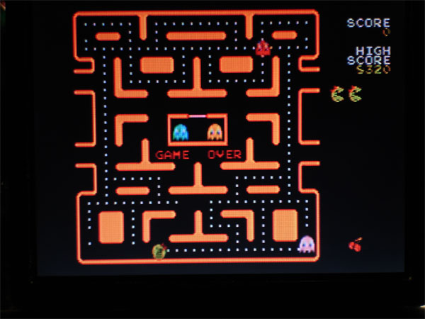

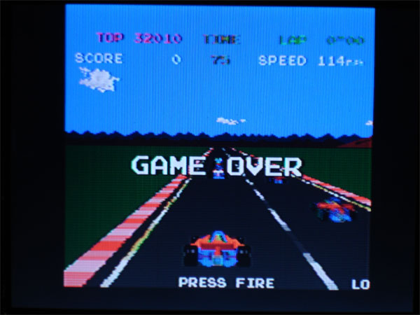

I needed to go color and I had an old PSone 5inch LCD from my CarPC hacks in the bucket-o-parts so I dug it out and hooked up a temp solution.  It works better than I could have hoped for.  My plan is to use a Tornado Terry's Happ Joystick, two buttons, and either hack saw the pole position shaft and add a spinner knob, or if I can combine the controls into one using the atari pot.  I'll attack that when I get to the control panel build.
Here are some shots to kick this off (Sorry I got a little picture crazy):

Pac-man Main Menu on LCD:
Pac-man Menu Button, thinking of including this on the CP.

Ms. Pac-man:

Pole Positon:
