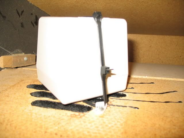

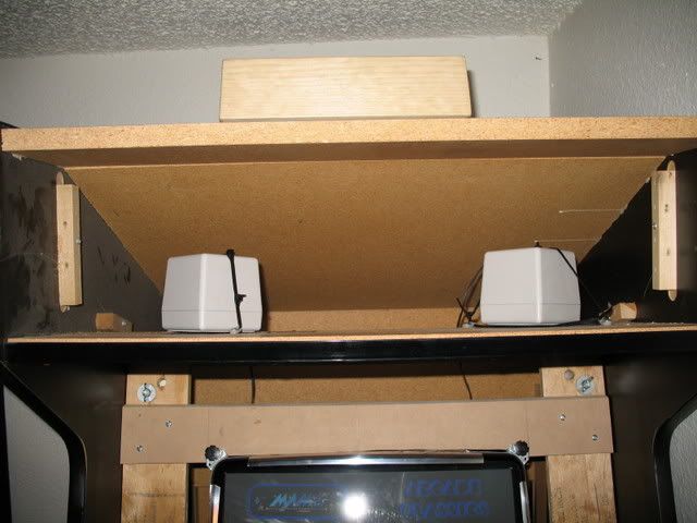

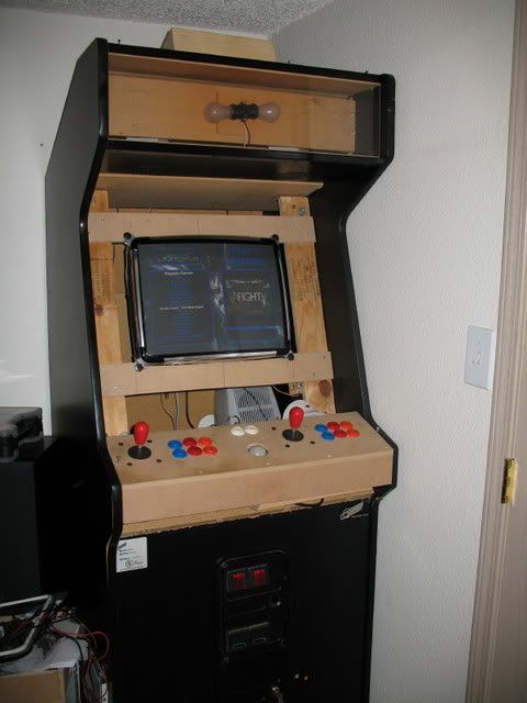

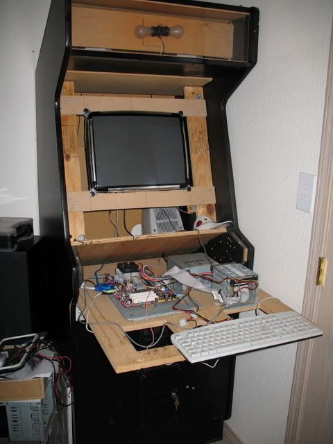

I found a free cabinet on Craigslist here in Seattle a while back and picked it up.  Since then I have been fiddling around with it and planing my attack.  I already had a 19" computer monitor and reasonably powerful computer sitting around earmarked for an emulation machine, and I had recently finished my desktop control panels so I decided that I would use some the computer in the cabinet and prototype the CP using the guts of my CP project.
Here's my progress so far:
This first picture shows the 19" computer monitor de-cased and mounted onto the boards used to mount the monitor in these HS-5 cabinets.  You can also see the "drawer" feature of these cabinets which I think makes them awesome candidates for emulation machines.

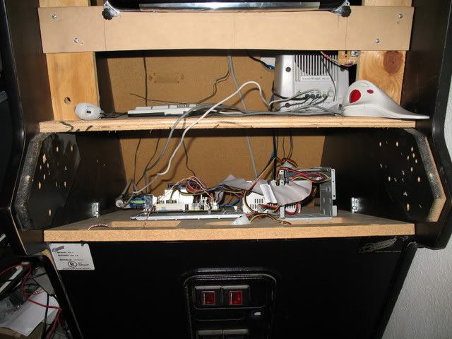

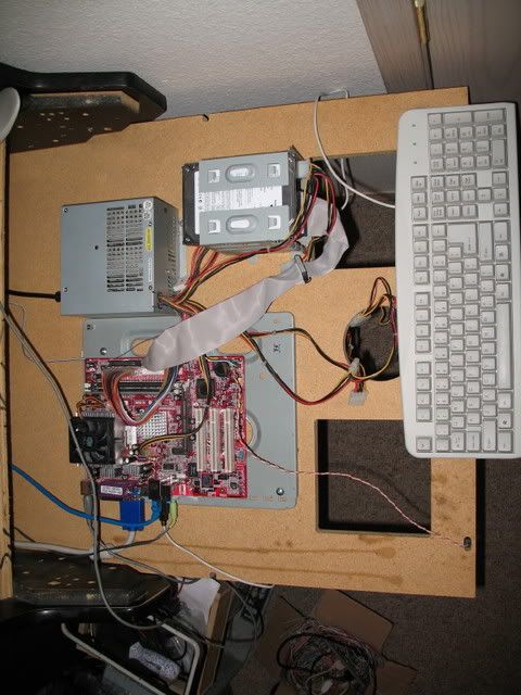

I ripped apart both the extra tower I had and the case my primary computer were in so that I could use the nicer of the two cases for my desktop computer and the parts from the other for mounting my components in the cabinet. The drawer in this HS-5 cabinet provides an excellent place to mount all my hardware and it slides back down into place very easily.  The drawer also gives a nice work surface when it is in the table orientation seen in the first picture.  I have not cleaned up any wires yet, but once I have the final CP constructed and hinged to the drawer I plan on routing everything much cleaner.  I also have so many cd drives sitting around that I may mount one in here to make any software installations more straight forward.  I am using my network for transferring large files and groups of files but I want to install You Don't Know Jack and some other games like that, which I think I'll have to install directly.
Here's a shot of the drawer back down inside, it is latched in with some barrel bolts and CP gets mounted on a hinge to the front lip of the drawer.  You can also see my sub woofer from the computer speakers I am using in the cabinet sitting at the back of the shelf below the monitor.

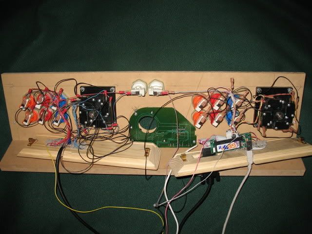

This is the underside of my mock-up CP.  The rats nest of wires and the pine boards are courtesy of my desktop cps, I will be replacing all that with a KeyWiz and some new terminal strips eventually, but this has worked out great to find out if the spacing of everything worked.  I have my hacked trackball mounted in the center, but unfortunately it only fit in rotated 180 degrees from where it should be.  I installed it thinking that it would be easy to find some software that would flip mouse travel, but apparently nobody with any programming ability has ever had this problem, because I can't seem to find a solution.  I think that I will be able to shift things around enough to get it in the right way on my finished CP, but I'm not quite sure yet.
Here's a picture of the cabinet with the CP in place and it is playable, it works fairly nice I just want to round over the leading edge of the CP since it can dig into your wrists a little bit.  I also find that it feels like I am going to get carpal tunnel syndrome while playing standing up.  I think the panel is mounted at the same height and angle as it would have been originally in these cabinets so I wonder if that was always like that.  I can't think of a good way to change the angle so I may just have to always play from a stool.  You can barely tell the coin buttons are lit in this picture but that is because of the flash, even with the room fully lit they glow really nice with the stock 6v bulbs running off of my 5v rail on the computer power supply.
The last two pictures of the cabinet show the rest of my progress on the modifications I have done so far.  I pulled out the one speaker that was mounted in the speaker panel and used zip ties to hold my Cambridge Soundworks speakers in place, these speakers have a really nice sound with their sub woofer and I hope that it will stay nice when I get the monitor bezel in place, you can't see the off-white speaker boxes through the slots in the speaker panel so I am not going to paint them.

Those little Cambridge Soundworks speakers are great; hope you are driving them with enough power. I use a pair of those as my rear surround speakers in my 5.1 theater setup and they really sound good.

I am running the speakers as they were originally meant to be run.  I am using the whole 2.1 set, the amp is built into the sub, which I have sitting below the monitor.

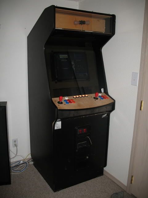

Very Late Update.
I rushed to make the cabinet more playable by July 4th and never managed to update the thread.  Now that it's looked like it does for about 1 month I figured I should share with y'all.
That July 4th deadline was because we were having company over for a BBQ and I thought this would be a good source of entertainment, and for the people who actually played it I was right.  Not as much interest as I had hoped, but successful none-the-less, and the deadline meant I got myself in gear.
Here it is as it looks now:
As you can see it has a new (still prototype) CP, and smoked plex.

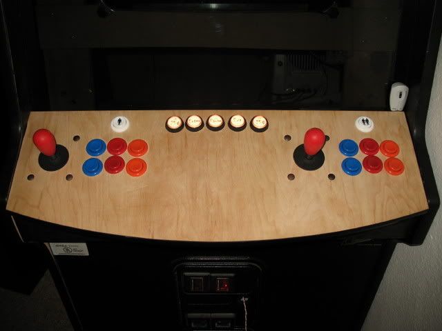

This is the top of the CP:
You may notice that there is currently no trackball mounted in the CP. I have however solved the space problem for the trackball by shifting everything else as far out as it can go, when I mount the TB I won't have to try to flip it's axis of travel anymore.
The illuminated admin buttons were a last minute solution.  I had originally intended to use some Electric Ice buttons from GGG with the disk inserts also offered there but the results were not satisfying.  I thought I wanted the labels to be stealth when the lights were off so the standard translucent buttons or the NovaGems seemed wrong for the job and in MikeDeuces button disk thread there was a picture of an EI button with some fairly readable text inside it, but in my test the button does too good of a job diffusing the light for the text to be readable.  These admin buttons have a built-in light and diffuser, and allow for a printed graphic to be inserted under the clear cap on the top.  I like the versatility of using photo paper and graphics of my choosing, so I think I will keep these buttons.  I will be removing the credit buttons though in favor of rigged up coin return buttons, and I think I'll even make that an option that can be turned off with a switch inside the cab.

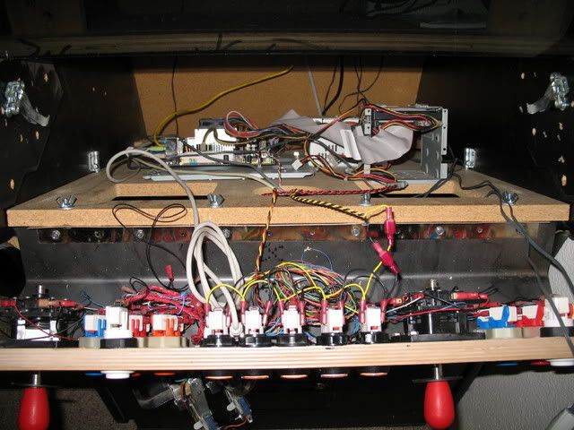

This is the underside of the CP where you can see that my wiring has been completely revamped:
I purchased a Keywiz from GGG so that I could return my GPWiz and all it's accompaning wires to the "DorkSticks."
I also used a Molex tool borrowed from work to create a custom harness from my PC power supply to the illuminated buttons and coin door.

OK, now I've updated.
Questions, comments, ideas, ridicule?

Hello bfauska,
would you mind telling me what are your admin button?
from what I can see on the pic it seems to be:
coin1 - ??? - pause - exit - coin2
Jay

The missing admin is "Enter"  I chose to add that one simply for ease of use for outsiders.  I still have the player 1 and 2 buttons set to work for selection in both mamewah and mame, but the enter button keeps folks from asking.  I am not sure if it'll stay on for the final product.

Any chance you can post pix of how your illuminated buttons are connected to the PC power supply?
Thanks

« Reply #58 on: January 14, 2008, 12:02:36 am »
Here's a brief update and progress report on my super-slick-power-on-button.
First a picture with some mock-up artwork installed. I printed these out on a color laser printer on plain paper so they don't back light well or hold up to CPO abuse, but they gave me an idea about the look, I think after a few minor touch-ups I'm ready for printing.
Second is a picture to try to explain how I hooked up my "Enter" button on the CP to power up the cabinet and then return to it's mild-mannered-life as a lowly "Enter" button.
This same task could be accomplished easily if your MB supported power-up from password, but since mine doesn't I had to wire the power-on header to an arcade button (nothing new I know) and then I wanted it to become the enter button when in the frontend (that's the new part.) In the future I will also use this relay to power on the speakers and marquee. As for now, it's wired as shown in the picture. When the relay is off (no power to the coil) the MB power is connected to the button on the CP, when the button on the CP is pressed it turns on the computer and the coil of the relay is powered up from the PSU, switching the connection to the button over to the encoder instead of the MB. I initially hooked it up to only use one leg of the switch and leave the ground hooked up the whole time but that didn't seem to work, so I switched both legs. I should be able to switch one leg of the power for the marquee and speakers later and still have one pole of the relay left so that I can illuminate the power button from a wall-wort or battery when the computer is off and then connect it up to an LEDwiz when I power it up. I shut the computer down using a shifted key combination and windows shutdown, so I don't need the power button while the computer is running. I did leave the originally PC power button wired before the relay so that I can always use it if the computer locks up.

So, after several years sitting dormant in my basement I've actually hauled my cabinet into the office at work to keep us busy on breaks and during long hours of being here to be available. The tagline for "The Reactivator" is "bringing arcade classics back to life" and now it looks like it's time to breath some new life into "The Reactivator".
The first thing I realized is that the standard width CP just isn't going to cut it if I want to add a trackball and spinner (I know, too many controls, I also don't care) so I'm going to use the 4 player CP box that came with the cabinet when I picked it up 8 years ago.
Here's my progress so far...
Since I said some time ago when someone was looking for a 4 player Dynamo HS5 CP box that I'd measure mine I decided to make a 3d model of it in the computer. I still don't have a dimensioned drawing but if anyone wants the 3d model let me know, I still plan to make the drawing from which a metal shop could easily duplicate the box but I just haven't yet.
Next I figured out what I think I want my CP layout to be. I've chosen the 7 button layout based on having a 4 button row available, the Mortal Kombat 5 buton setup nearly replicated and a standard 6 button as well.
I think the 4 player panel has provided plenty of room to allow the controls to not be too tight.
Anyway that's my update for now.

I will be CNC cutting it for sure. Since building the CNC I seem to have gotten pretty rusty at good old fashioned wood butchery. I'm also planning on doing some things that, while possible, would be absolutely silly for someone with a CNC to do manually.
One example is the way I'm mounting the trackball. Other than WP34's Tron Legacy I haven't seen any glowing rings around trackballs that I really like or that would work with a HAPP trackball, and I want RGB so I can't do EL sheet and doing it without the mounting plate is going to help make that possible, it is also cheaper to do it without the mounting plate and I'm a cheap skate so here is one reason I'm using the CNC to do this panel.
I'm also planning on doing glowing rings around the spinner and joysticks which will benefit from access to the CNC as well.
