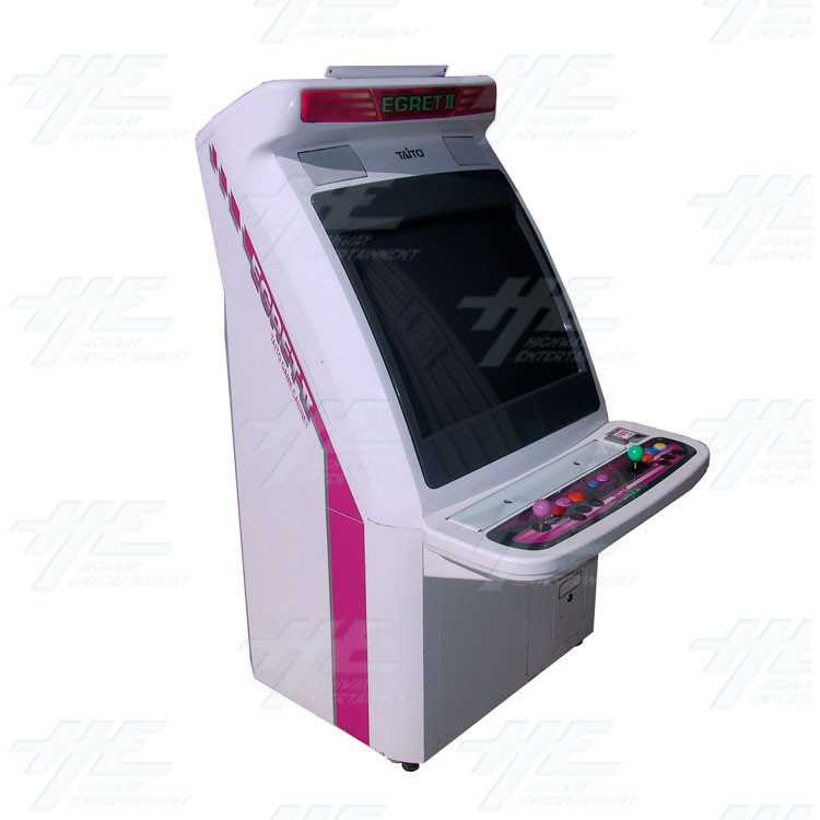

So, I've been looking around, and I'm curious if anyone has had any experience trying to build one.
My situation, the wife has finally agreed to let me build a cab (yay!) but she wants something a bit smaller than a full-sized arcade.
Just wondering if anyone has had any experience or has any ideas about it. I'm planning on building from scratch (with the help of my father with some of the woodworking).
Here's an example that I think I'm going to try and mimic.

Those Candy cabs are made with plastic skins and metal control panels.  You might have a space issue if you try to follow the measurements too closely while building with wood.  Another option is a cocktail style cab or a bartop model.

Right, I know they're rather thin. I honestly _don't_ need that much space though. I'm still deciding if I want to go with an LCD for the display or if I want to drop some coin in a TV.

Again, I'm just using the Candy form-factor as more of a starting line. The actual cab will probably be more streamlined than your typical candy cab.
The real debate is that I have a 19" LCD available for use now, at no cost (my current monitor). I could either use that, or look at getting a TV. A TV would more accurately give the big monitor right in your face feel, but I'm torn. I'll probably prototype a few things.

The one measurement I would highly recommend that you disregard is CP depth.
Make sure you leave yourself room for whatever controllers you decide you want.
Almost all the candy cabs are made for the thin Asian sticks/buttons.

The first project is all sorts of awesome, though it is really tiny. Looks like a baby Tekken5 cab. ------->
Second one is really neat as well, looks like he's using a 20" CRT in there, which my 19" LCD should have about the same viewable area. Granted, 27" would be a hell of a lot nicer =P
I'd really like to go TV, but I worry about how much larger that is going to make the cabinet. What I'm shooting for right now in the way of controls is 2 "Street Fighter" setups, a 4/8way in the middle with a few buttons, trackball, and _maybe_ a spinner. I was wanting to go 4 players, but that'd be just too much real-estate. Plus, It'd be rare that I have more than two people over at a time anyways. So yeah, disregard the tiny CP. Check.
