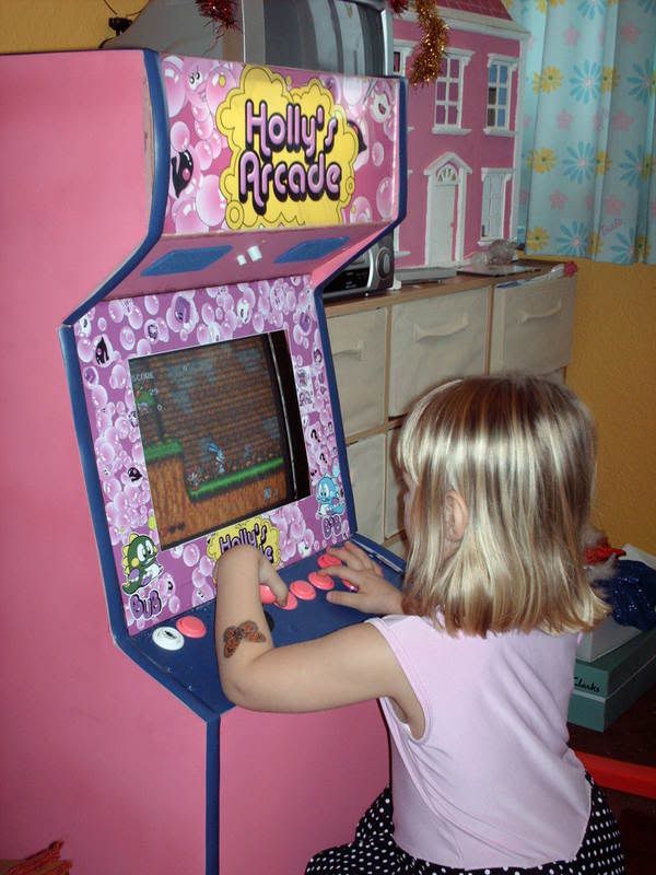

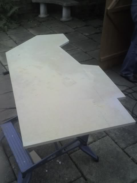

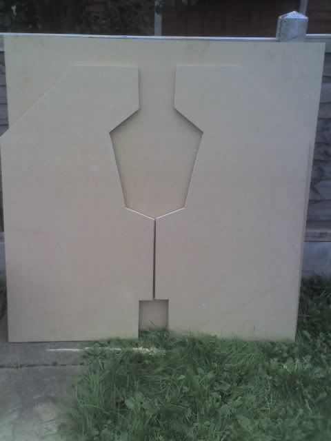

Decided to build a minimame cab for my neice as a Christmas present using the plans from minimame.com.  Obviously it's got to be a little bit girlie so i decided on a pink & purple colour scheme, mainly pink with purple T-moulding, purple CP with pink joystick and buttons.
This is my first cab building project and having not done any woodworking since leaving school a good few years ago things went alot smoother than i anticipated  :)

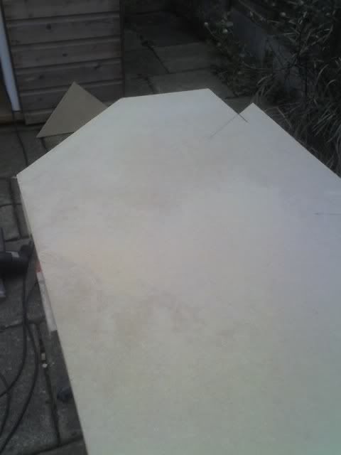

Planning the design
When i started to draw out the side panel dimensions i soon realised that the minimame was going to be a little bit too mini for my neice (even though she's only 4), so i decided to keep the plans as a rough guide and just design my own panel. As you can see from the pic i laid the monitor out to help me make sure that the angles and depth of the cabinet were ok.

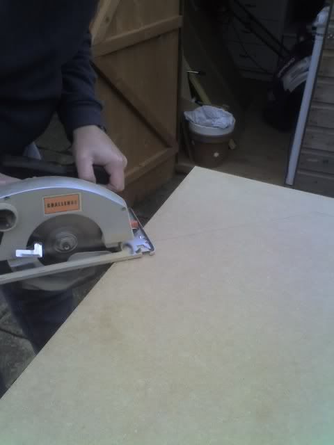

The First Cut
My first time using a circular saw! You can't see in the pics, but it was securely clamped.
Starting to Take Shape
One Complete Side Finished
Felt rather good when i got to this stage and i still had all my fingers intact which was a huge bonus. But I am very pleased with the overall dimensions and shape
Where I Finished
Managed to get the other side completed before the weather took a turn for the worse and rained me off.  Hopefully next weekend if the weather holds out i should get all the panels cut and get the basic cab together.

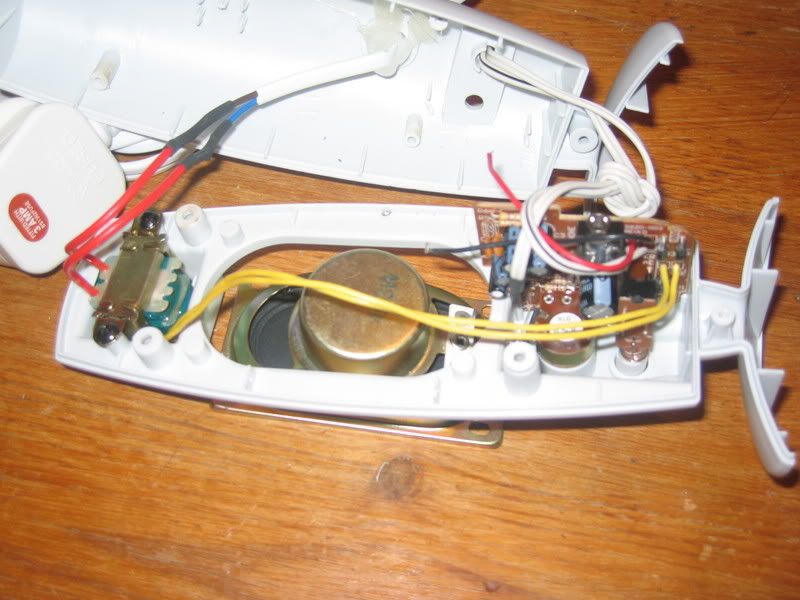

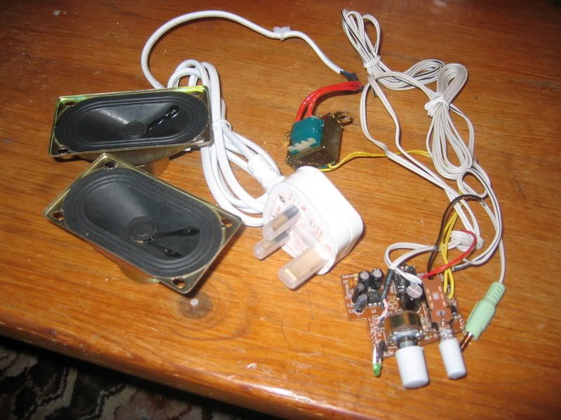

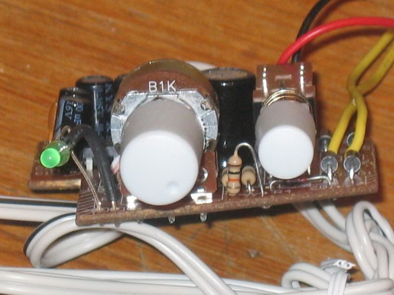

So what i did while it was raining was rip some PC speakers apart ready to fit in the cab.
I started with two of these
Pulled the speaker front off, undid screws and pulled it apart to reveal

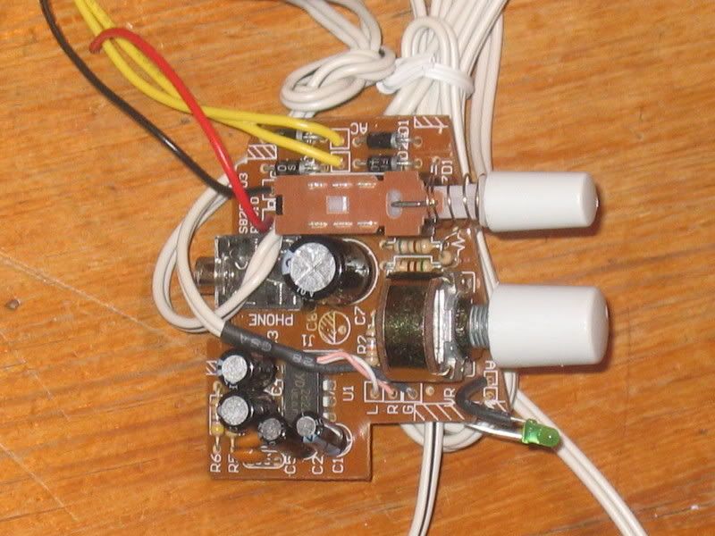

Luckily the board that has the power button and volume control came out in one peice so i'm going to mount this somewhere on the cab so the volume is easy to control externally.
So in the end i was left with

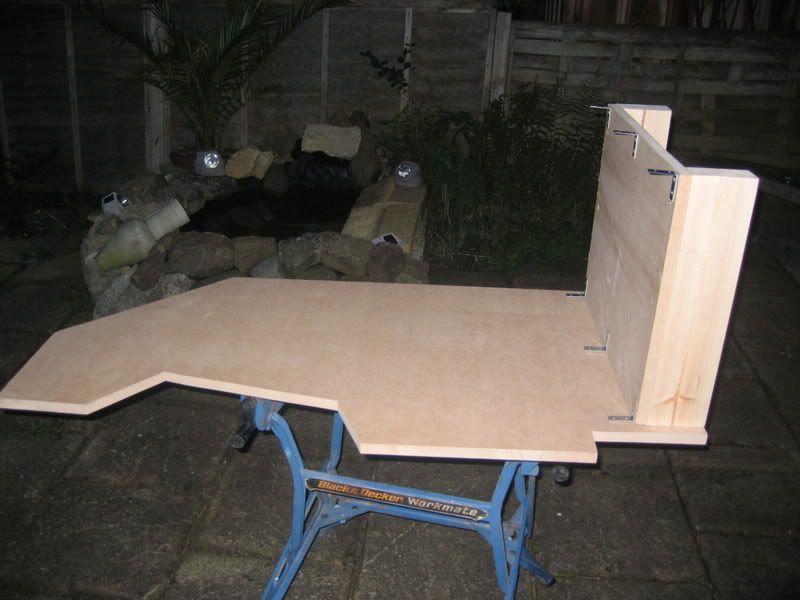

Well by this time the weather had impoved slighly, but it was getting dark so i made an effort to get at least a little something acheived.

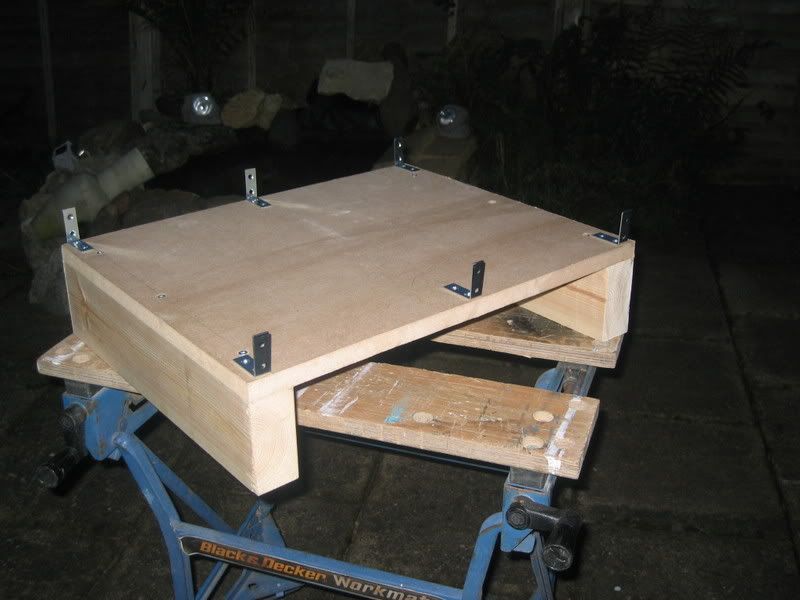

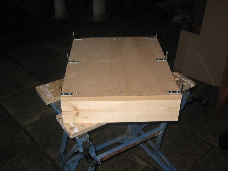

So i put the base together
and get one of the sides attached (before no light stoped play lol)
It's a really good feeling to see it finally starting to take shape, rather than be a few peices of cut mdf in the shed... For attaching the sides etc i've decided to go with L-Brackets rather than using wooden battons - what are peoples views on this.

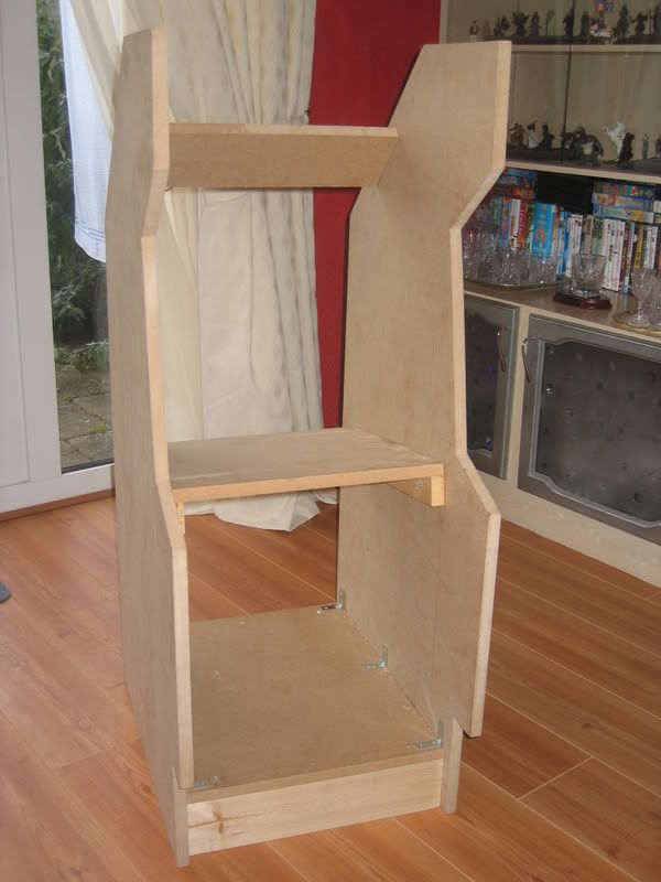

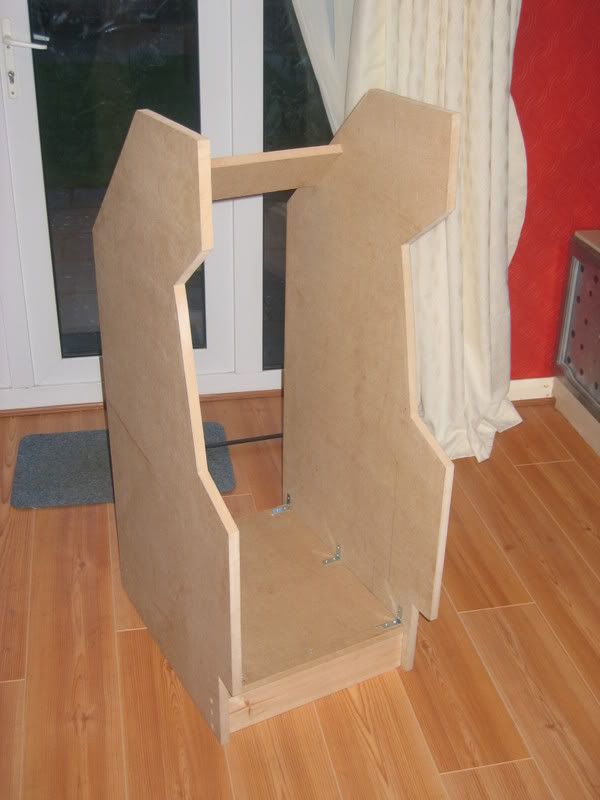

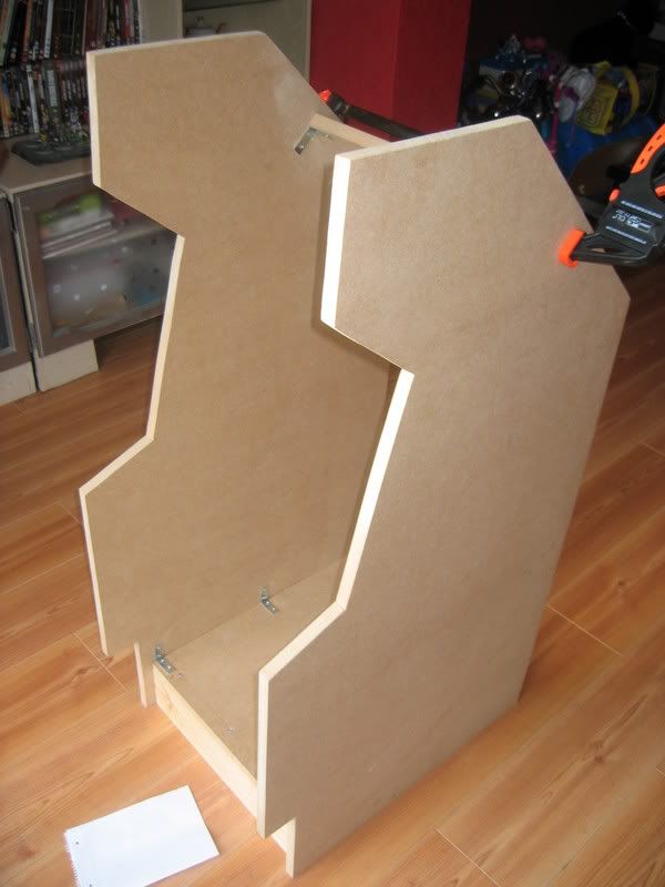

My view? A mistake. I've done both, and I can tell you that the brackets are a far worse solution. The ONLY advantage is that you can take it apart if you wish, but that's just not a concern for me.

I'd go with battons as well, unless you have some very strong fixings in the middle and the top I can see being a little weak at the bottom, a sudden fall or push on the sides and it will probably sway and bend to either side.
Mines got bolts and screws along the battons and it still felt a little wobbly until it was all put together.

Don't worry the bottom will be screwed to the 2x4 aswell. 3 screws in each corner.
There'll also be a support piece running parallel to the back diagonal for a bit of extra support as well as the monitor shelf, and a shelf slightly lower down that will act as the top for a vertical slide out shelf that the PC components will be attached too..
So hopefully with all that it should be rigid enough..

Rather than trying to mount the speaker circuit so the knob sticks out, you can bypass the pot and wire in your own.  If you look at the PCB, you should be able to find the leads that go into and out of the pot.  You can solder wires around these points, leading to your own pot, then you can easily mount it anywhere you like.  I'm sure my PCB was different than yours, but I wrote it up somewhere on the PartyBox thread listed below.  I think it was on page 2.  Another approach is to unsolder the pot from the board and run wires to it.

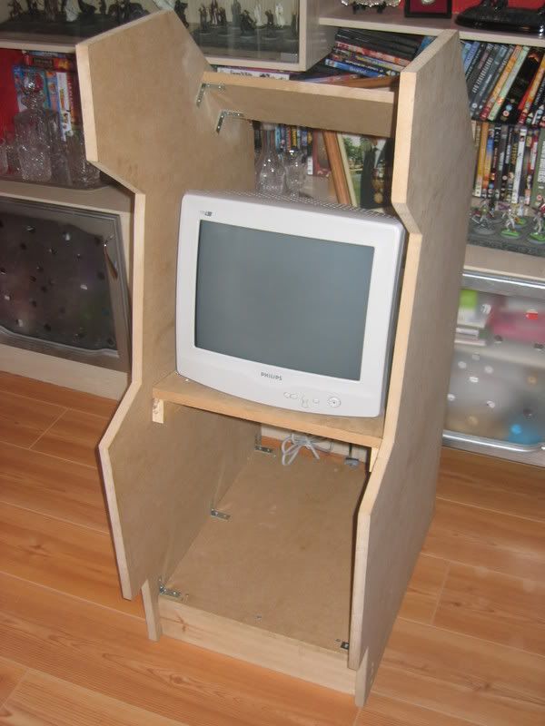

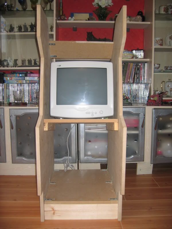

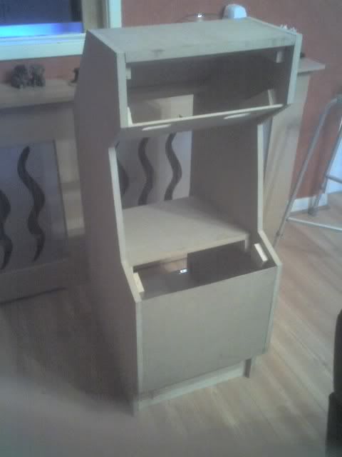

Well managed to get a little more this weekend, only really did a couple of hours on Saturday and a couple of hours today, as i went to the remembrance sunday service and then pub, with my parents.

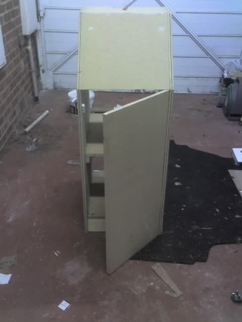

So i managed to get the framework together.  With the help of some clamps
So after removing the clamps it was free standing and starting to look alot more like a mini cabinet
I then took it upon myself to install and test fit the monitor shelf.  This was a little tricky as i was working on my own.  What i had to do was actually lay the cabinet on it's side, marking where the top of the mdf shelf, and the batons should be on one side.  I then fastened the mdf to the batons inserted it into the cab, taking care to line it up with the previous markings, checked with a level and square to make sure all was well and then screwed it into place.  I then flipped the cabinet over, made sure that the shelf was level and square again and screwed in into place. Leaving me with something like this
And with the monitor in place

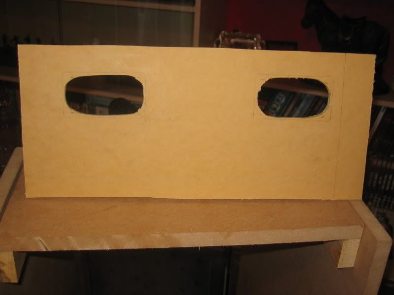

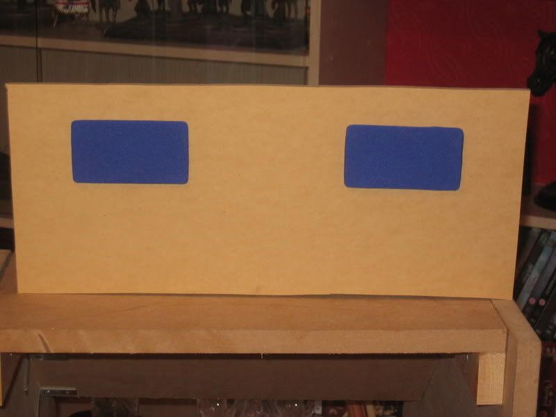

I then made a start on the speaker panel.. I decided that as the speakers were only small that i would use a thinner piece of mdf (about 1/8" ish) just cut out a rectangle slightly smaller than the speakers, fasten the speakers to the back of the mdf and that would be it.  However that looked horrendous and i didn't like it one bit.  So i shaped the holes that i had made making them slightly larger and oval-ish so that the speakers could be fitted from the front with the magnet and the cone protruding at the back.. After covering the speakers with some blue-lilac speaker cloth and test fitting them, i was very pleased with the result. Bearing in mind that the speaker panel will be pink i think the colour of the speaker cloth will look great..
Speaker shelf 2nd attempt
And with speakers and speaker cloth

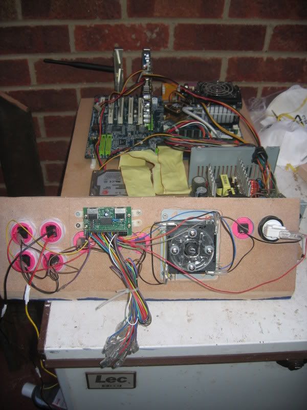

mini-pac arrived on saturday. So will be mocking up my CP ready for routing out the recesses and cutting the button holes.  I'm using pink sanwa snap-in buttons found here with a width of 29.5mm will a hole of 30mm be ok or is it better to cut it slightly smaller???

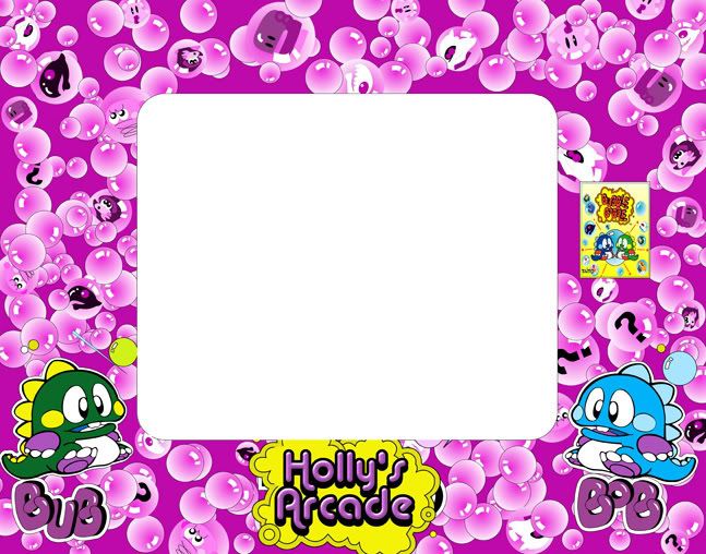

Marquee Artwork:
Bezel Artwork:

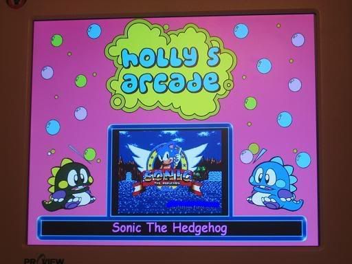

Mamewah Screen:

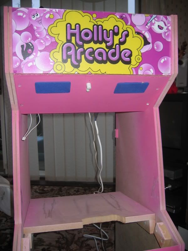

« Reply #20 on: December 19, 2006, 04:12:31 pm »
Well i've been that busy with trying to get this finished and with getting everything organised for Christmas, that updates haven't been very forthcoming. SO this will be quite a long post with plenty of pictures (even though they are crappy phone ones), to remedy the situation.
Well the T-moulding and slot cutting bit finally arrived from the States, so i set about routing out the slots for my T-moulding... I measured the depth i needed to make the slot at the centre of the MDF, then practiced on a scrap piece; flipping the piece over to make sure the slot was dead centre, and what do you know it was.  So i took the cabinet outside and laid it on it's side to cut the slots (rather then dismantling it)

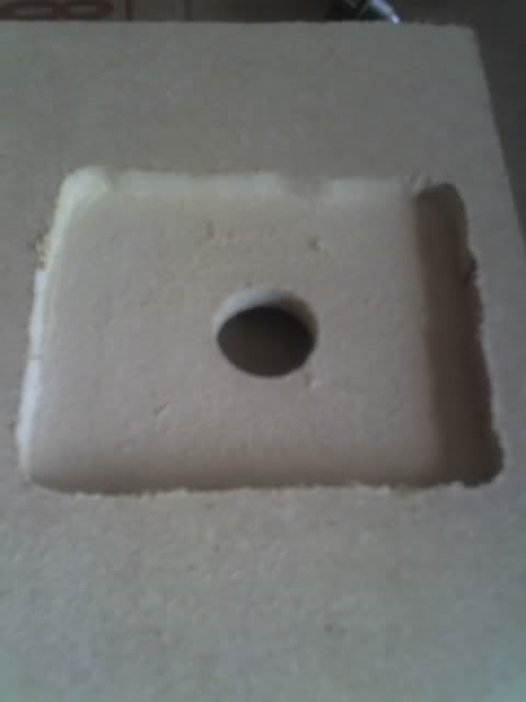

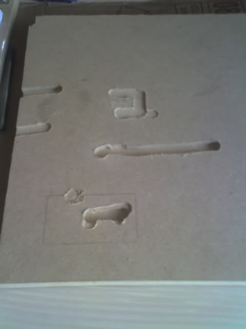

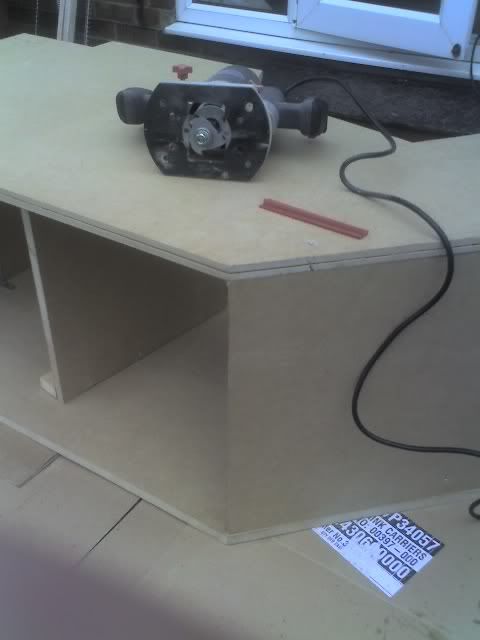

I then decided to practice using the router bit i that would be used for recessing the joystick into the control panel. (bearing in mind i had never used a router before this day)
I couldn't find a bit with a bushing on it so i had to cut the recess freehand so it wasn't overly neat, but it did the job.
So now the cab looked something like this, all i needed to do was put the back on.
The back is fully hinged, to make access easy if i need to get at the insides at any point. Got the cab back from my parents (where i was building it) and it's now stood in my garage waiting to be painted. At this stage i have just used wood filler to cover over all the countersunk screws.
Rather than using primer for the mdf i've actually used white emulsion, as i've got absolutely tons of it. I've obviously given the bits i've sprayed more than one coat to make sure that it's been absorbed properly by the mdf and i won't be getting a blotchy finish.

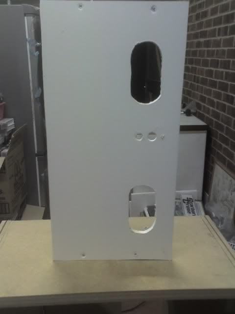

Speaker Panel

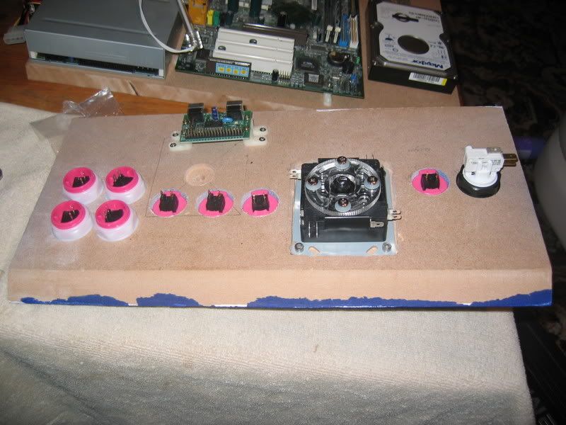

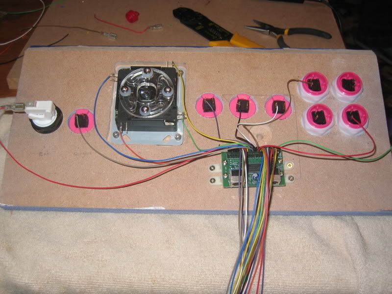

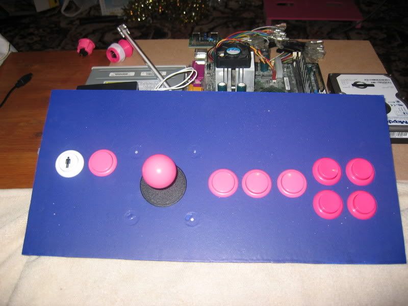

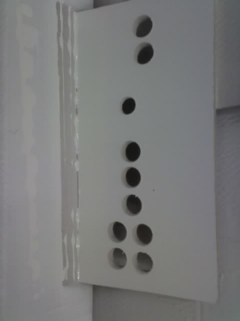

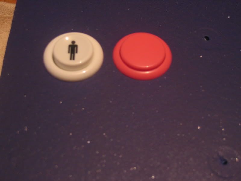

Control Panel
When looking at the picture of the control panel the two holes at the top will be on the left of the cab.  These are the 1P button (used to select the game from the mamewah list) and the other is the  button that HazeMD recognises as the megadrive start button. The next hole is for the joystick shaft, followed by the three action buttons.  The cluster of four buttons, when viewed in the correct orientation will be as follows
top left - turns everything on
top right - pause
bottom left - exits game
bottom right - exits mamewah and turns the computer off.
The computer when turned on is set up to boot straight into mameWah

Nice progress!  If I were you though I'd rethink the 4 admin button cluster you have on the right of your CP.  If you put the "exit to front end" button so close to the action buttons I'm afraid you will accidentally hit it in the middle of a high score run in Donkey Kong or something!
Also, for future routing tips (without a template or straightedge clamped to the workpiece) you could use a razor and straight-edge to score the lines where you are going to remove the material.  Then if you are careful you can run the bit close to the edge and the wood will pop out and you will get a clean line.  You have to route about 1/8" deep at a time but the results are worth it if you are anal like me (even though no one will ever see it).

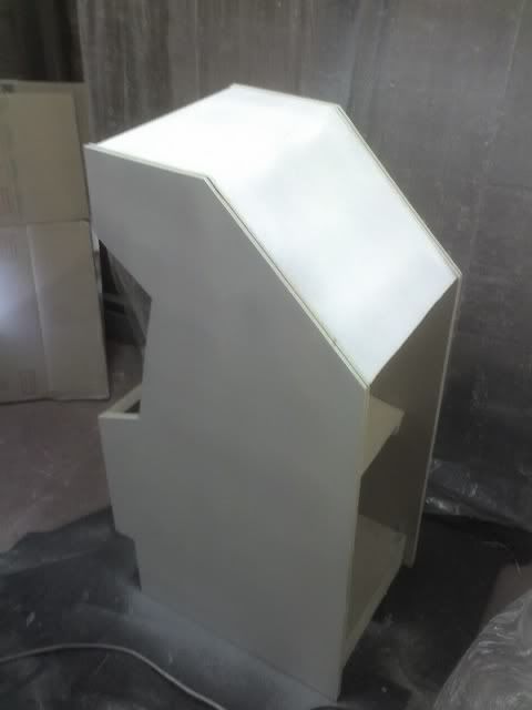

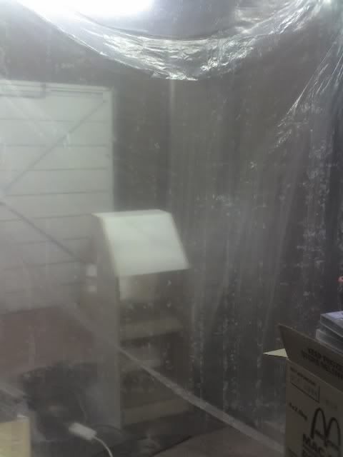

Well guess i'm just like a bus - No updates for ages then two come along at once.
Managed to get my spray booth set up tonight.
And also managed to get a couple of coats of the undercoat on... This is a pic after the first coat.
Will sand coats tomorrow when they are dry to make sure they are nice and flat/even then i'm going to colour :D can't wait

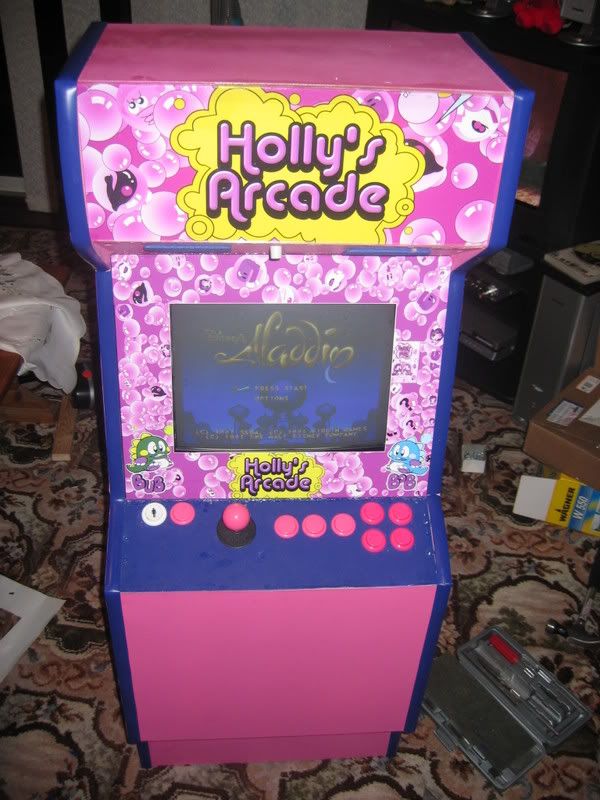

I'm not sure how big it is TBH, i just cordened off about 1/3 of my garage using some plastic dust sheets i bought from a local hardware store.  I didn't cover the roof, just the sides.  Think it was something like 12' x 9'.

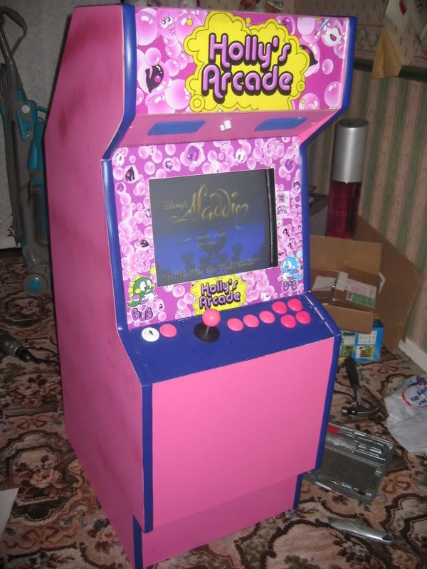

Well what can i say..... In the final week, if something could go wrong, it did go wrong.  I was right on schedule uptil saturday, and thats when i hit the first of my setbacks....
The painting had gone exactly to plan - the pink colour looked superb and i got it painted in good time. It contrasted well with the purple of the control panel, which matches the purple of the T-Moulding.
I even added a touch of silver glitter spray which loked great on the purple..
Finished Control Panel
Close Up of Glitter Effect
The picture looks a little dark, as i had to take the picture without a flash to capture the glitter effect.
I then had the great job of wiring it all up, so underneath looked like this to begin with.
Then i started wiring the controls. As it's only a small CP i decided that i would actually snip and solder the wires from the minipac as otherwise they were WAY to long.
Start Of The Wiring Procedure
I also sorted out the motherboard components and fixed them onto the drawer that would fit inside the cabinet.
Fully Wired CP & Component Shelf
Now this is where i hit my first snag......
I connected the CP up to my laptop to program all the buttons i needed like so
Programmed all the buttons which was easy, started up Mamewah on my laptop, tested the joystick and buttons everything worked great...  Turned the laptop off, re-started it, loaded up mamewah and............ Nothing:mad:
Thought it may be my soldering skills that were in question, so i unsoldered everything then proceeded to solder each button and joystick microswitch one by one testing it using the winipac programming utility making sure each one worked.  By now a half hour job had taken well over and hour and i was still in the testing phase.  The newly soldered CP worked great, until i turned the laptop off then i encountered exactly the same problem.  Everytime i re-started the laptop i had to re-program the minipac.
By now i was starting to panic... Was it a faulty board, was i doing something wrong, was my soldering naff.. I'd even tried programming it direct to the EEPROM using CTRL+ALT+P and that didn't work either!!!
"I know, i thought.  I'll try it on my desktop PC" so i plugged the CP in and away i went and had exactly the same problem.  At this time, I'm not afraid to admit that i was almost close to tears :( Thinking my neice wasn't going to have a Christmas present.  So i was posting on the mamewah forum, and hoping to get some help to remedy the situation.  Anyhow, just on the off chance i unplugged the CP from the front USB port and plugged it into one of the ports on the back directly connected to the motherboard. Low & Behold after programming and re-starting the computerit had kept the settings:D!!  By now i had wasted well over 5 hours trying to get this sorted and decided that i needed a break and would finish everything else up on christmas eve..

Once that was done, i fitted the speaker panel and the marquee and lights, so at this stage it was looking something like this
You can also see the space i routed for the minipac.

The Fully Finished Cab

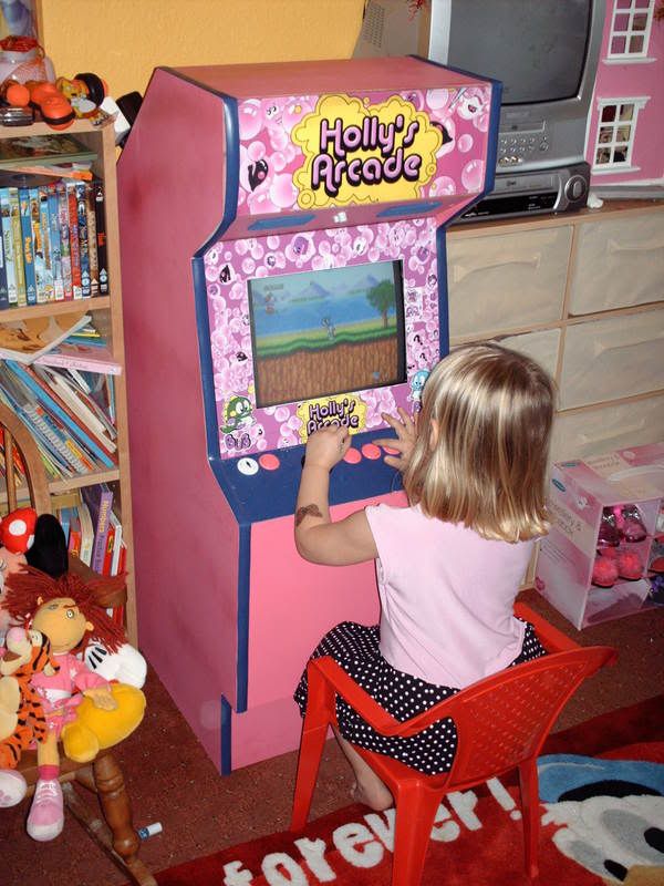

These next pictures are what made the whole process worthwhile.
Holly's Arcade
It's not exactly perfect, but i don't think it's too bad for my first attempt, and my neice loves it!!!!!

Wow!  Very nice job - everything seems like it came together and I'm sure your niece loved it!  How many coats of paint did you put on there?  Did you put a clear coat or something over it?  I'm trying to decide how to go about painting mine (in the 40 degree cold  :-\).  The glitter is a really cool idea... hmmm... you've got me thinking now...
Also, what types of pink buttons did you use?  The admin buttons look like the Dream Arcade ones that I have but the action buttons seem to be a slightly different shade of pink (which I actually might like better than the ones I have).  Where did you get them?

Awesome job Uncle! Good luck trying to top that next christmas!

Looks great.  I really like the marquee and bezel.
I also had a Christmas deadline for my little pink one, and finished things up around 1:30 AM.  I also hit a few small snags at the final hour, but overcame them.  Glad to hear you were able to do the same.
Hope you only have one neice :)
I used the Sanwa Snap in buttons for the action buttons, which are the lighter pink (which the paint matches). I got them from Gremlin Solutions. The admin buttons are also Sanwa, but i got them from Sealslayer on here so not sure exactly which type they are.
I used 3 coats of the general white emultion as undercoat and it only needed 2 coats of the colour. I didn't use a clear coat as the spray glitter also adds a clear coat.  It was a case of killing two birds with one stone.  I have loads of the pink colour left, using a spray gun to paint it was one of my better ideas.  Quick, easy, great finish and you hardly use any paint for the surface you cover.
Icesurfer...I'm sure that in her mind it is better than perfect.
