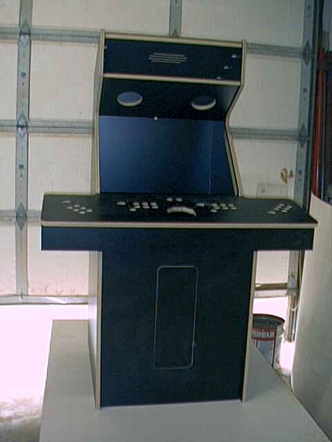

btw,
This is an attractive option.
http://www.arcadeshopper.com/images/front.jpg
also a finished version
http://www.arcadeshopper.com/images/mame/fullleft.jpg
tempted....

Only problem with those cabinet-kits is thie price.  $550 for that kit.  Ouch!  You can get a used full game of the same size for $300 or less.  (I got my TMNT for $375 at an auction, and that was spending too much just to get the darn thing.)

The arcadeshopper cab is the one I originally wanted, but the best he would ever do was about $450 plus shipping would be close to $200.  That's why I ended up making my own of the same Simpsons style: http://www.newwave.net/~flanham/wlanham/arcade/
The very last picture at the bottom of the page shows it practically finished.
I considered having a local shop cut these out for kits, because I'm pretty sure I could beat arcadeshopper's price by a good margin.
Back to the topic.  I used a D9200 27" in my cab.  The inner width of my cabinet (between the two large side pieces) is 27", and my monitor BARELY fit with a 2x4 frame around it.  We actually had to put some small notches in the 2x4's to get the monitor to fit.  If you made a thinner frame, there would be plenty of room.  There is 1.5" of space on each side of the monitor (in my cab, the 2x4 frame takes up this space).
