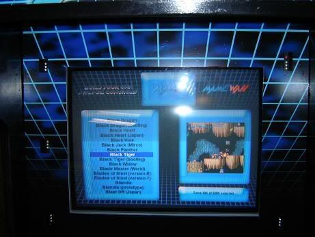

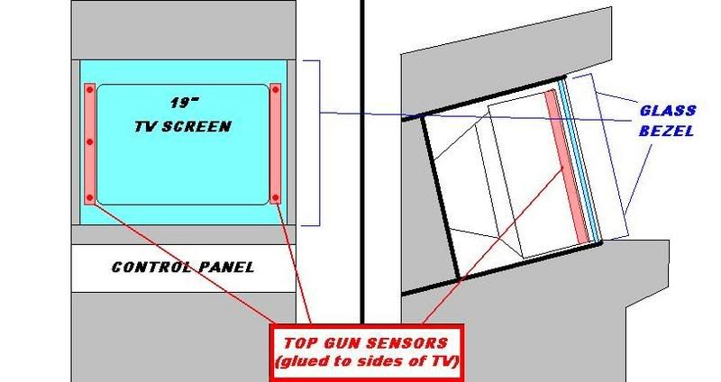

A little more info on my situation:
Sorry about the crappy pic, I'm at work. As you can see, the TG's LED strips are attached to the sides of my 19" TV, and are directly behind a glass bezel, I have tried both with and without the glass bezel on to the same effect so the glass isn't my issue.
Not that I'm looking for any help, but I figured some of you might be interested in how I mounted these guys internally so they dont stick out like a sore thumb.
I'll get a real pic up tonight.

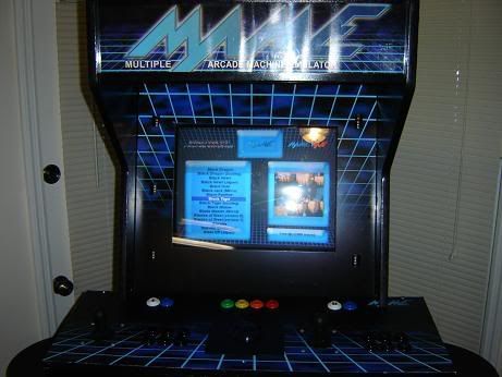

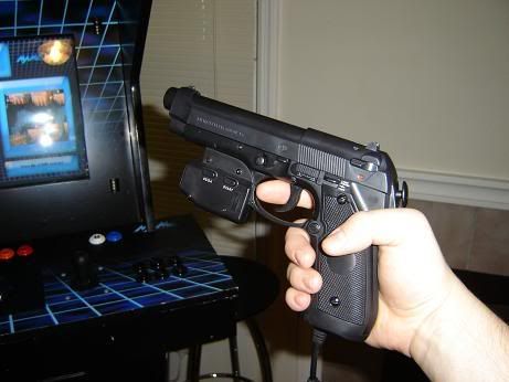

Re: LCD Topgun distance requirements kind of crazy...
« Reply #19 on: September 14, 2006, 07:31:26 pm »
Here are the pics as promised of the integrated LCD's:
« Reply #20 on: September 15, 2006, 08:28:57 am »
If you are still having problems, it is due to the lighting.  I assume that some of the reflections shown on the photos are related to the camera flash, but there appear to be other light sources reflecting in the screen.  These WILL seriously degrade the performance of the gun.  Turn off all light sources that may reflect in the screen and try the gun.
I would bet that you will be able to get closer and the gun will work better.
