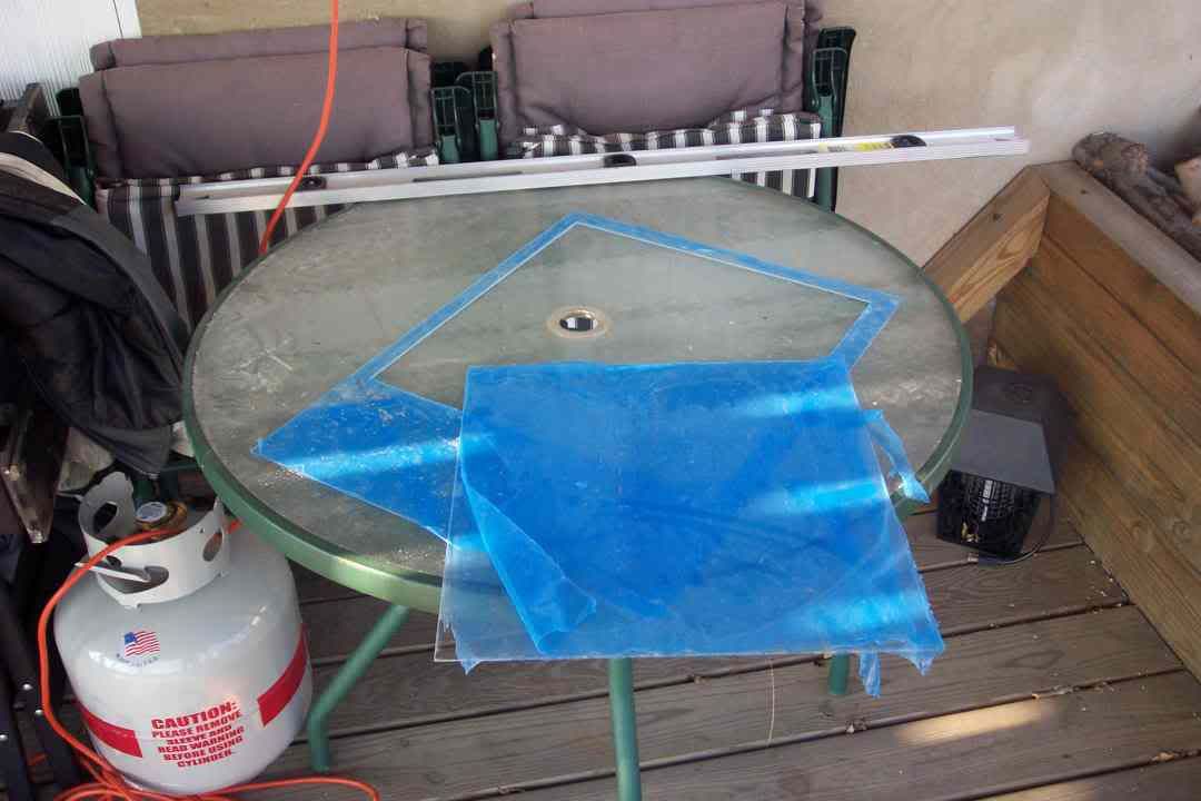

I had to get some plexi cut today so I decided to take a pic to share with you guys.
The master sheet is a standard 18x24 from Home Depot. The cut out is a perfect 16 x 16 5/8 for my bartop project. It took me just a few minutes to lay out the piece in the CAD app and the total cut time was just under 1 minute.
