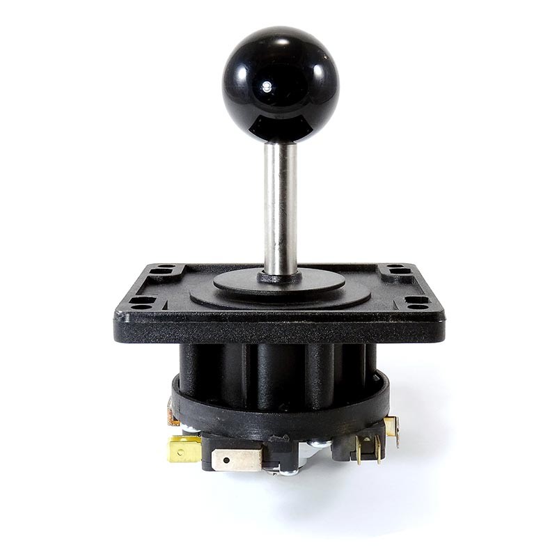

Hello.
I would like to replace the shaft on my Galaga/Ms Pacman Happ 4-way stick with a longer one, and with a nicer, bigger red ball top.  The one it comes with is too small, a dull red color, a flattened bottom, and has a visible seam in the middle.  I've seen joysticks with smooth, shiny red longer ball-tops and fully spherical (mostly).
I have not been able to find a stick like that, specifically stating it work with the Happ stick, so if anybody knows of one, please let me know.
For that matter, I'm also toying with the idea of doing the same with my old Happ Competition joysticks.
I would appreciate suggestions.
If nothing else, you might be able to:
- Remove the ball from the old shaft using a lathe or drill press.
- Find a local machine shop that can cut 6mm threads.
- Add a shaft extender and/or shaft cover if needed.
There are more options for this approach.
You've probably already checked Paradise Arcade Shop and Focus Attack, right?
https://paradisearcadeshop.com/collections/joystick-actuators-shafts?page=1
https://focusattack.com/spare-parts-tools/by-part/joystick-shafts/
Another possible option is a balltop IL Eurojoystick 2 shaft replacement or balltop stick from IL.
https://www.arcadexpress.com/en/joysticks-accesories/338-12658-eurojoystick-2-to-ball-conversion-kit-stainless-steel-shaft-industrias-lorenzo-il.html
https://www.arcadexpress.com/en/joysticks/222-405-il-eurojoystick-2-ball-top-happ-arcade-joystick-industrias-lorenzo.html

I'm inclined to get help from a friend who has a CNC machine and see if I can just fabricate a new shaft to my specifications, and then add a Sanwa or Seimitsu ball to that.  Replacing the joystick will need to be a backup plan.
Digging a bit deeper, it looks like your stick is based on a Happ Super. (scroll down to Replacement Parts)
- The part of the shaft where the actuator mounts is 10mm diameter, right?
https://na.suzohapp.com/products/joysticks/50-6084-1125R00
You might want to ask Bryan if one of these two options meet your need.
https://paradisearcadeshop.com/products/il-eurojoystick-6mm-hollow-shaft
https://paradisearcadeshop.com/collections/joystick-actuators-shafts/products/iki-ilhapp-led-joystick-shaft-hollow
- The listings don't specify if they will work with a Super, a Competition, or both. (same 10mm diameter, different distance from the bottom of the actuator to the top of the pivot)   :dunno
- You might want to calculate the desired distance from the bottom of the pivot stop to the base of the balltop before you contact Bryan.

I did see that shaft last night but since most of those websites don't show much in the way of dimensions, I assumed it was only for the Eurostick/Competitition, and did not bother looking into it further.  I can ask them about it.
The shaft diameter for my 4-way stick is indeed 10mm.  I measured it last night.
