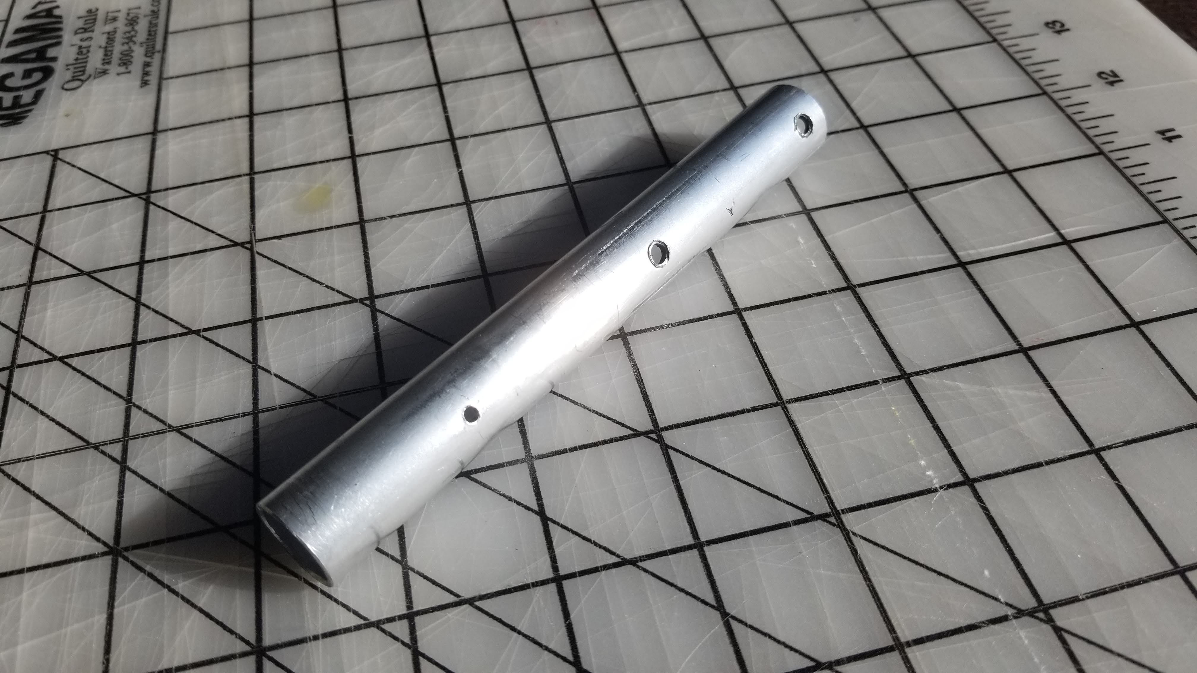

The handles mount on a 19mm (3/4”) tube.  I ordered some 19mm OD aluminum tube, with a 15mm ID, and another that’s 10mm ID.  I planned to tap the holes to directly screw the handles in place.  If the thin wall wouldn’t hold threads, I could go with the thick.  Cut the tube to 150mm because Amazon sold it in 300mm lengths and I wanted to get maximum use out of it.  The tall handle combined with the short tube meant I had to make sure there would be enough below the panel to actuate the switches.

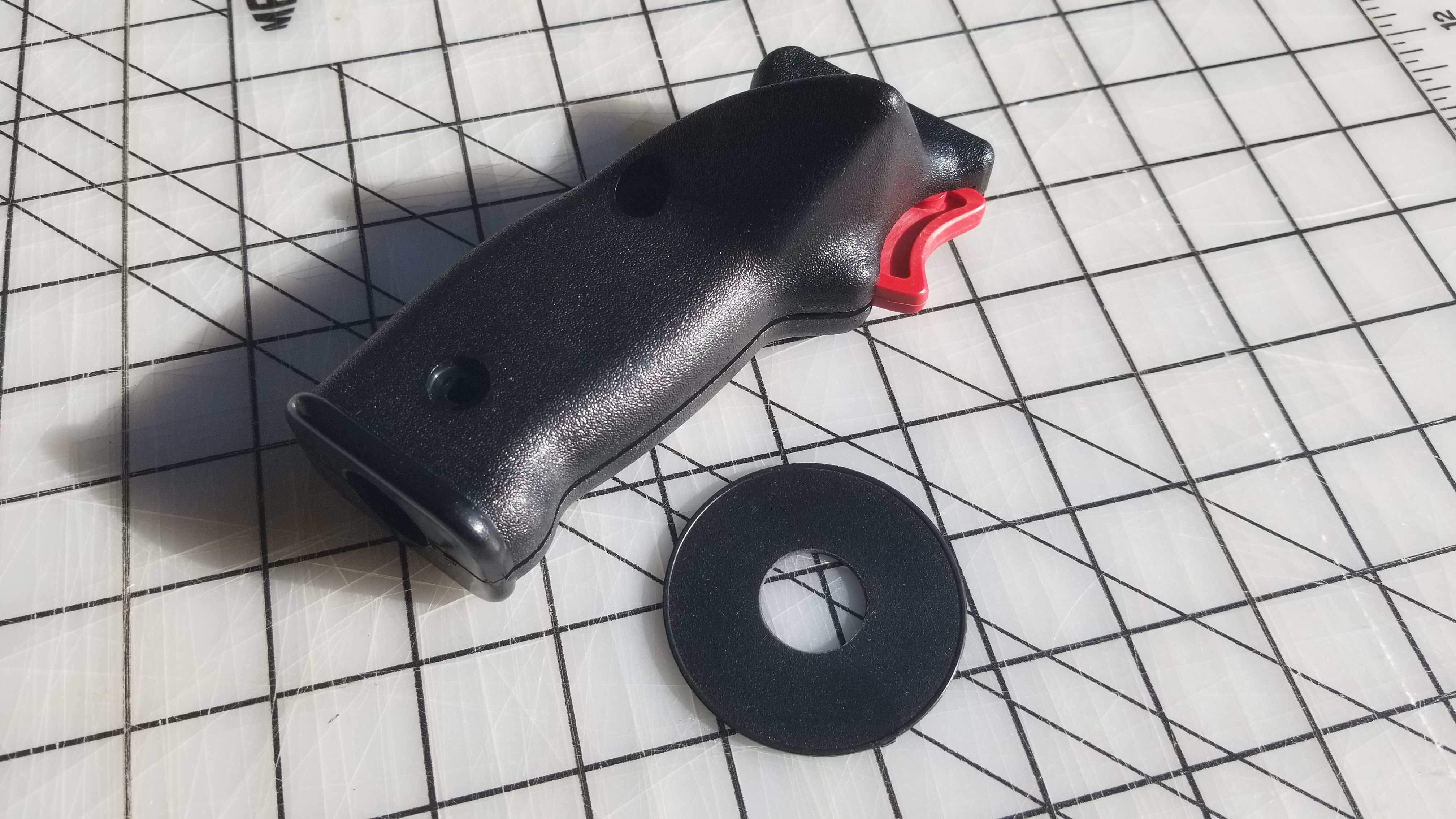

Starting out:  I had the genuine handles, and a dust washer from an old stick.  (I actually planned to make my own dust washer, but drilling out the old one to 3/4” worked perfectly.

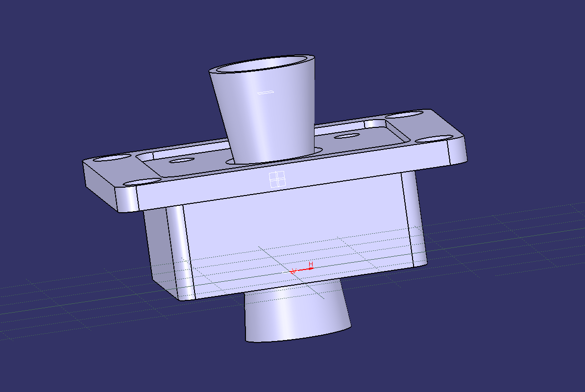

My fighting sticks have 8 degrees of movement.  I originally printed a version with 8 degrees, but with the long handles it felt like way too much movement, so I redesigned with 6 degrees.  In CAD I visualized the movement as a tapered stick…
I tested a flexible pivot design, and it worked really well.  Seemed a little weak, so I thickened it up and it was just about perfect printed 45% fill in flexible TPE filament.  There might be a better cross section for this, but it worked on the first try so why fight it?

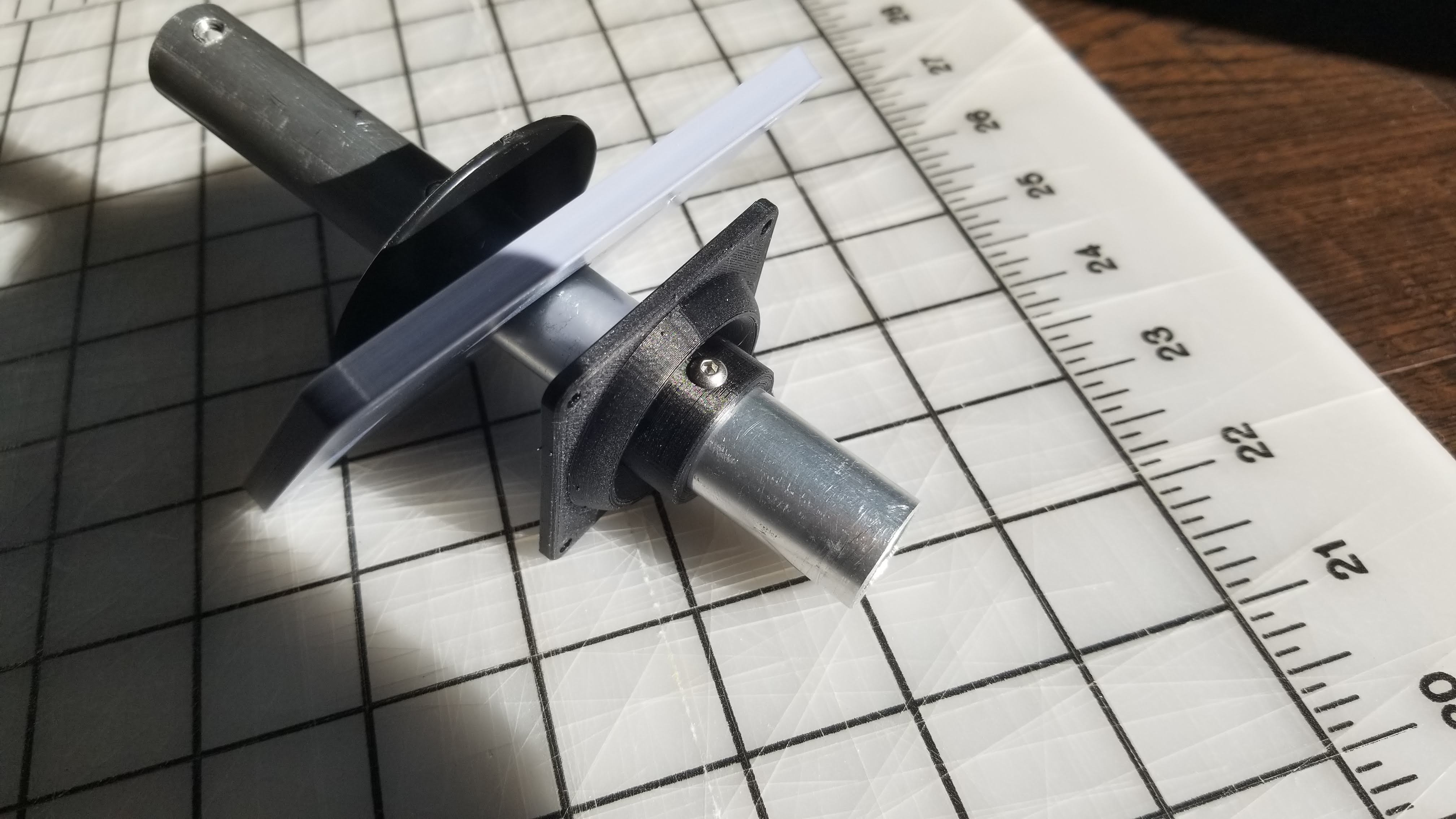

I don’t like to print with supports if I can help it. So printing in separate pieces was going to be the plan.  I sandwiched the flex pivot between the mounting plate and the base.  Then I added the restrictor plate from the other side.  That works well since I’d like the option to swap restrictor plates in the future.  It’s hard to see, but this is actually an 8-way restrictor plate with indentations that really let you feel straights and the corners.  I may just go with a 4-way in the long run, it depends on the list of games I choose for these sticks.
On my IL-Happ sticks the actuator is tapered 8 degrees so it’s pushing flat on the switches at full throw.  I thought about printing a tapered actuator, but decided it was simpler to just use the tube as the actuator.  I set the switches at a matching angle so they’re pushed straight at full throw.  The layers are sandwiched together with some M3 bolts and embedded nuts.
Gotta remember to put the dust washer on before assembly.  I forgot that on the first one.  I’ll take it apart before mounting.  The flex section slides in place and is attached with two M3 bolts.  Those bolts and the flex pivot both hold the stick in place, and provide the anti-rotation.
Switches are mounted with standard screws, and then handles are installed.  The wiring will have to wait until the cabinet is further along.  Here’s a left and right pair.  There will be two sets for proper Vindicators play.
