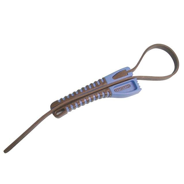

I want to have a different color than red for the balltop, but I know the balltops on these were locked on there pretty tight out of necessity.  Has anyone ever removed one of these?  If so, how did you do it, and what balltop did you use as a replacement?

yeah, I replaced one of those
I got it off with one of these from sears wraped around the ball and a big screwdriver on the other end*EDIT* put the middle of the shaft with the flat sides in a vise to keep it from spinning
You can use any 35mm balltop for a Sanwa or Semitsu

« Reply #2 on: October 05, 2008, 11:54:44 pm »
Andy told me it can't be done, but I guess Bender has done it. I've already discussed this with Andy. It's on there with locktite, and he says the plastic will break before the ball will unscrew. I wanted to do it so I could put the dust washer under my CP. So as a result, I had to special order a new handle without the locktite. I guess it may be worth a try - it either breaks or it works.
The reason he makes it impossible to remove is because of the 4/8 way switching. He was concerned with people having trouble with it unscrewing since it uses a fair bit of twisting force. I'm hoping that I can get it on there tight enough with teflon tape or something. I'd rather not have to use locktite because then it would be on my panel permanently.

« Reply #3 on: October 06, 2008, 12:02:32 am »
I was on there pretty tight but the locktight will give out way before that brass insert, you can be sure of that
also there was some leftover locktight on the threads and I just left it on there and that was plenty to keep the new top on tight, though they make different grades of locktight one of which is less permanent, and that may be a way to go

« Reply #8 on: October 07, 2008, 09:59:21 pm »
No, I think mainly people would try things like pliers and such, which concentrate the pressure at points on the sphere making it easy to crush and break. A belt wrench distributes the contact and makes for much more available torque. They can sometimes slip, though.

« Reply #10 on: November 28, 2008, 09:48:22 pm »
Tried Bender's suggestion yesterday, and it worked great.  Thanks again Bender!   :cheers:
