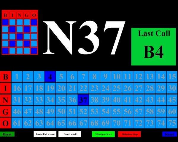

Change the lightboard to a video display using a cheap widescreen TV or projector like this one. (they were on sale for around $25 several months ago)
Write/download/buy software to handle the inputs and output display(s).
- Caller might want a small display to confirm what's going on without looking over their shoulder.
- This software has a pretty decent layout (selectable win pattern, current call, last call, grid of all calls), but terrible color design.  :puke
If you roll-your-own software, the inputs can use your choice of a 5x15 matrix encoder for inputting the calls (B, I, N, G, O on the left + 15 column buttons along the bottom) and several dedicated admin buttons (win pattern select, reset, next call, bingo, and an "oops" button to undo a wrong call or a mistaken bingo claim) and/or mouse clicks on a GUI.

This looks to be useful, super simple, and free. https://wildgoosechase.net/technology/bingo-display/
Mirror a laptop's display to a big TV and there it is. Since the whole thing is in an HTML and a CSS it should be possible to change the fonts, colors, and sizes. Open in a browser and hit F11.
Now if I knew about javascript I could add a pattern display, a 2 digit counter etc. Just expanding the height to fill the display height would be useful.
Still going to be looking into modernizing the old hardware, but they might be swayed towards picking up a used flatscreen and a laptop.
