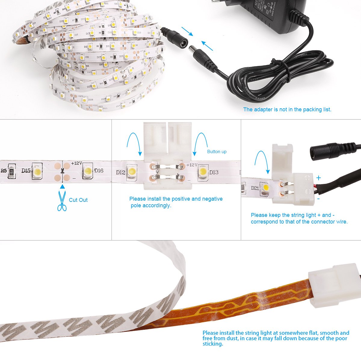

I've never found defusers to be necessary. I literally just put my marquee between 2 pieces of clear plexi. Works perfect with these behind it:
https://www.amazon.com/gp/product/B00HSF65MC/ref=oh_aui_detailpage_o01_s01?ie=UTF8&psc=1
Also, only used about 4-5 feet of the LED lighting.

This is probably a stupid question... but can you just cut it?  Or do you use the extra length to run to the power source?
I’m going to have to make a plan on how I’m going to run power for that and my speakers- is there any references you can point me to for power wiring plans?
  • Posts: 9734
  • Last login:Today at 05:10:51 am
Re: How far should the marquee recess into the arcade cab?
« Reply #9 on: May 07, 2018, 09:04:20 am »
Yes.
Cuttable and linkable. Easy to cut and use with Lighting EVER accessory. It can be cut every 3 LEDs along the cutting marks, without damaging the rest strips.
There are jumpers like these or you can solder wires to the tiny pads.
I used a tiny drill bit to make through holes for the wires on this addressable RGB LED -- ignore the yellow data wire.

Literally just put them on the top, bottom and both sides, in one big loop. Very simple. It has adhesive backing too so they just stick in place. I added some hot glue in a few places to help hold it in place forever.
