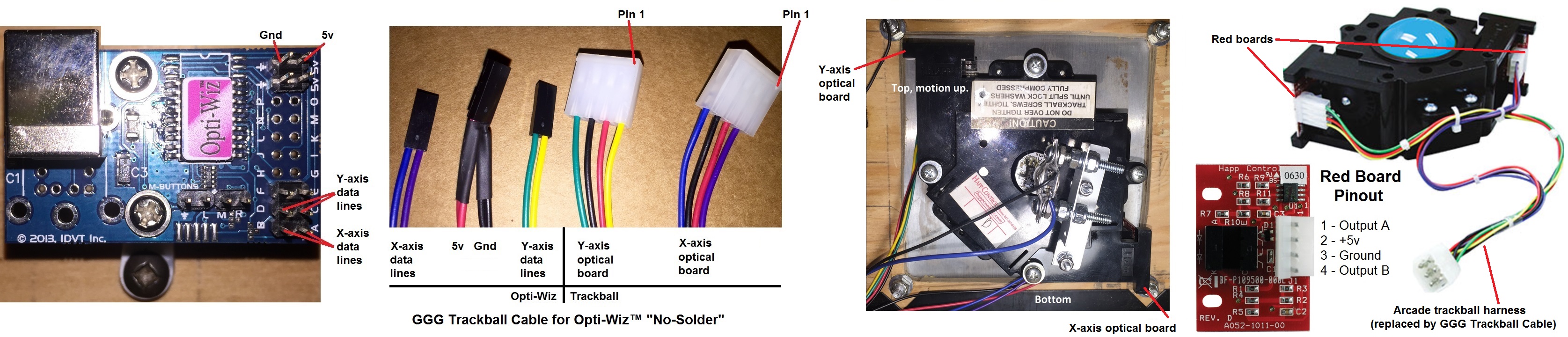

Groovy Game Gear has the Trackball Cable for Opti-Wiz™ "No-Solder" cable that replaces the Molex harness you are holding in the pic and connects the two green optical boards (P/N A052-1010-00) to the Dupont pins on your I-PAC 2 I-PAC Ultimate I/O encoder.
What are the pinouts of the Optic Sensor pcb A052-1010-00 and A052-1011-00 used on the trackball or trackwheel or 360 steering wheel ?
These alll use the same Item # A052-1011-00 Optic Sensor Board. The connections are as follows.
Pin 1 - Output A
Pin 2 - +5V
Pin 3 - GND
Pin 4 - Output B
The image above shows the newer red optical boards (P/N A052-1011-00) and an Opti-Wiz, but the trackball cable will work the same way for your encoder -- just lift the tiny lever and pull the female ground pin out of the 5v/ground Dupont housing since 5v and ground aren't on adjacent pins.
Trackball pins are top center, just left of the LED power jack.
  5v to 5v.
  Gnd to G.
  X-axis data lines to X1 (purple) and X2 (blue) -- if the axis moves backward, swap the data lines
  Y-axis data lines to Y1 (yellow) and Y2 (green) -- if the axis moves backward, swap the data lines
