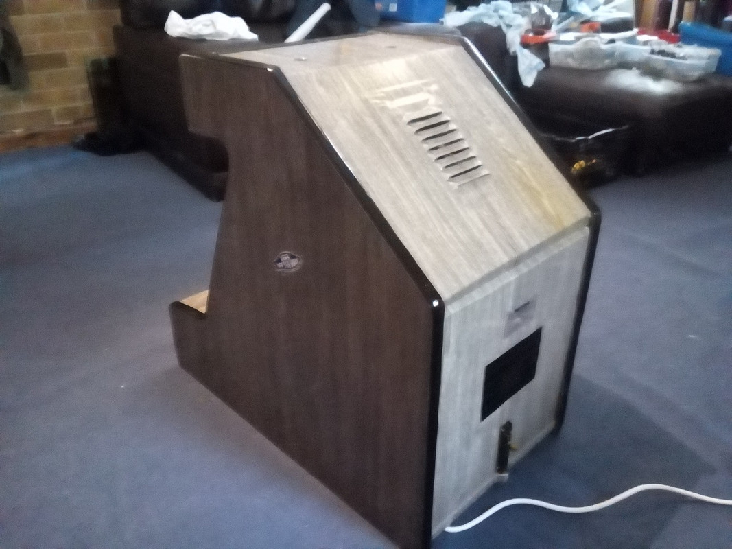

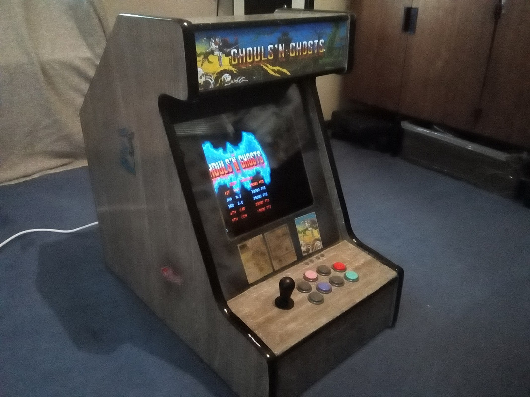

« Reply #44 on: May 23, 2020, 09:09:47 am »
Finished the cab! ...So thanks again guys for all your help :cheers:
See pics below, and sorry the quality of pics is pretty crappy...
My aim with the cab was for it to be true to a real arcade cab, ..as in the type of cab you'd see back in the day at a funfair or whatever, so it's CRT of course, tinted glass front, tatty exterior, strong, tilted screen for better viewing angle, and so on.
Thinking of putting cigarette burns on the control panel (just kidding)... Total cost for everything was around £165
