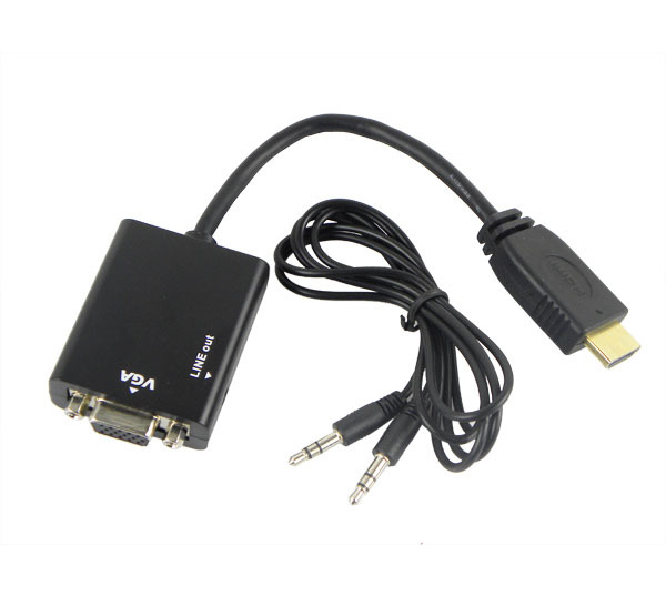

I noticed how bad the analog audio jack was too.  My solution was to use HDMI audio, in part because I also needed VGA output for my arcade monitor.
So I plugged in one of these:
Audio is nice and clean from the analog headphone jack on the converter.  While I had to edit boot/config.txt to get SVGA video to work, I didn't have to do anything special for audio, it just works.
For anyone else struggling with noisy audio.. I'll also mention that I had terrible, show-stopper noise issues with my old power supply.  I plugged in a new one and the noise was gone.
