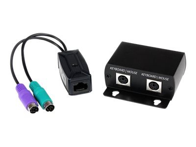

IF you are sure it is due to the distance the signal is going - you could get a ps2 range extender they aren't cheap ( $45 +/- )but are designed for this type of application (lets you send the PS2 signal over a distance of up to 100 meters using CAT5 cable )
http://www.newegg.com/Product/Product.aspx?Item=9SIA0ZX2C37089&ignorebbr=1
« Last Edit: June 10, 2016, 10:50:38 am by JDFan »
Yes, this looks quite interesting.
However, I'm not sure it would really solve the problem.
It looks like it just sends the PS2 signal through ethernet. I don't see an alternate power source though. Perhaps it even takes its power from the connected PS2 plugs, making the power situation worse.
Even if this product has an external (own) power source, I'm not sure that would amplify the too low and too weak signal of the Tankstick to what a PC requires. Perhaps it might just send the PS2 signal through ethernet, with it coming out just as weak and useless as the Tankstick puts it out?
But the general direction seems good. What I need is some kind of PS2 amplifier, or signal booster or power booster.
