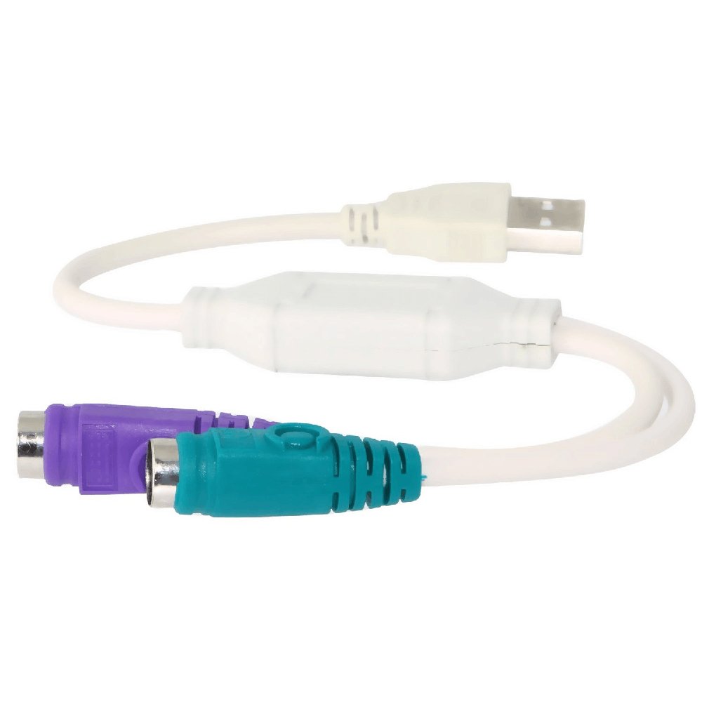

Just wanted to follow up on this question -- I went ahead and ordered a $4 USB to PS2 Adapter for keyboard and mouse ( SInce I have one of the $99 kangaroo PC's that I might use in a build soon so wanted to see if this trackball would work with the USB adapter. Bought this type rather than just the cheaper single adapter for the mouse and ordered from an amazon seller located in Texas for $3.99 + $0.25 Tax rather than wait for the $3.15 one from China.
Received the adapter today - Hooked it up and It did not work ( Made the USB device plugged in sound but then failed to load any driver and said it was an unknown device) - Figured it wasn't going to work - so decided to take the thing apart to see what it actually looked like and also to see if the USB connector and ps2 connectors were worth salvaging for the parts box -- Upon taking the PCB part in the cable apart the insides were badly corroded and the corrosion had shorted several of the solder pads --- Took out an old toothbrush and small solder cleaning tool and cleaned things up - put it back together and when I retried it the thing worked fine ( came up as soon as it was plugged in no driver install needed) !!
So seems the trackball will work with a USB converter and is hot swap-able when used this way (doesn't need to be connected prior to boot like the PS2 devices do) - but you need to make sure the converter actually works !!
