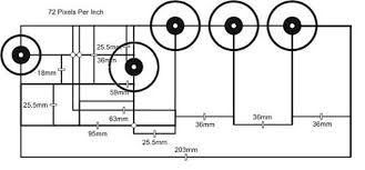

On bartops you need to plan for control depth.  Hard to know if your panel depth is enough unless you know what sticks and buttons you plan to use.  I kind of like the Taito thing you have going on with the shape.

Like he said, those buttons are for a metal CP.  As in a single sheet of metal.  They snap into a hole.  You can use them in a wooden panel, but they won't be as sturdy that way since there will be nothing except friction to keep them in the hole.

Those buttons will work fine in wood also -- just make the holes the proper size and the piece made to click into tplace below the metal CP will hold against the wood and keep the buttons in place well ( they'll be tight enough that you need to push from the bottom to release ) I used the same type of set in my Simplistic Galaxian Build http://forum.arcadecontrols.com/index.php/topic,139689.msg1444799.html#msg1444799[/url] using 1/2" MDF and a Namco PacMan plug and play and they worked fine.

Choosing either screw-in or snap-in can be pretty straight-forward. If you are using a thinner, sturdier, precisely-made panel, snap-ins are an option. Screw-ins will work in any situation. But snap-ins can be used in thicker panels when thinner acrylic glass is used on the top layer; the panel below has to be given notches to fit the securers; the buttons are not necessarily very secure when this is done. Since snap-in buttons do not have nuts in the way, they can be given a layout that is a bit more compact.

I think I'm pretty much finished with the cabinet and cp layout. The control panel will have a pocket cut in it to fit the acrylic so the buttons will have something to snap into. I'm guessing this will work. Most of the mdf panels will be glued into pockets in the mating panels.I'm not sure how the bezel should be attached.I put some ears on it so it can be screwed into place but open to better suggestions. The only colors that are set is the red for the t molding and controls. Still haven't decided on a theme for the rest:( way too many options.Also wondering how to attach marquee panel. I have a 3d printer. Maybe something with magnets?

Vertical Monitor but you still want 8 buttons  :whap

I'd also be sure that the bottom front edge of your marquee doesn't obscure you seeing the top edge of the monitor.
That viewing angle looks pretty tight.

why not something more like this?

What is a typical viewing angle for verticals? You're right.It's pretty tight. How many buttons do you suggest? It's a vertical cabinet but i might play horizontal games on it too. I can't think of any games that need 8 buttons though:) just using them cuz i have them but thinking about moving 2 buttons to the sides for pinball maybe?

Virtual/Visual pinball is overrated if you ask me, plus it might create space problems in your panel that require compromise.
If you like fighting games, do a four button neo geo layout or a six buton Capcom layout, any more is for console support and doesn't make sense with your build (in my opinion)

Ok. Can i find templates online for these layouts? Sorry for newb questions... The four should be God

There is no "right" viewing angle. I just noticed that that top portion of your monitor might be obscured.
Just wouldn't want you having to hunch over to see the entire screen. Depending on the height of the table you put it on, it looks like you might have to hunch a bit. Just see if you can render it on a table height and put your viewing camera at the same height as you eyes.
