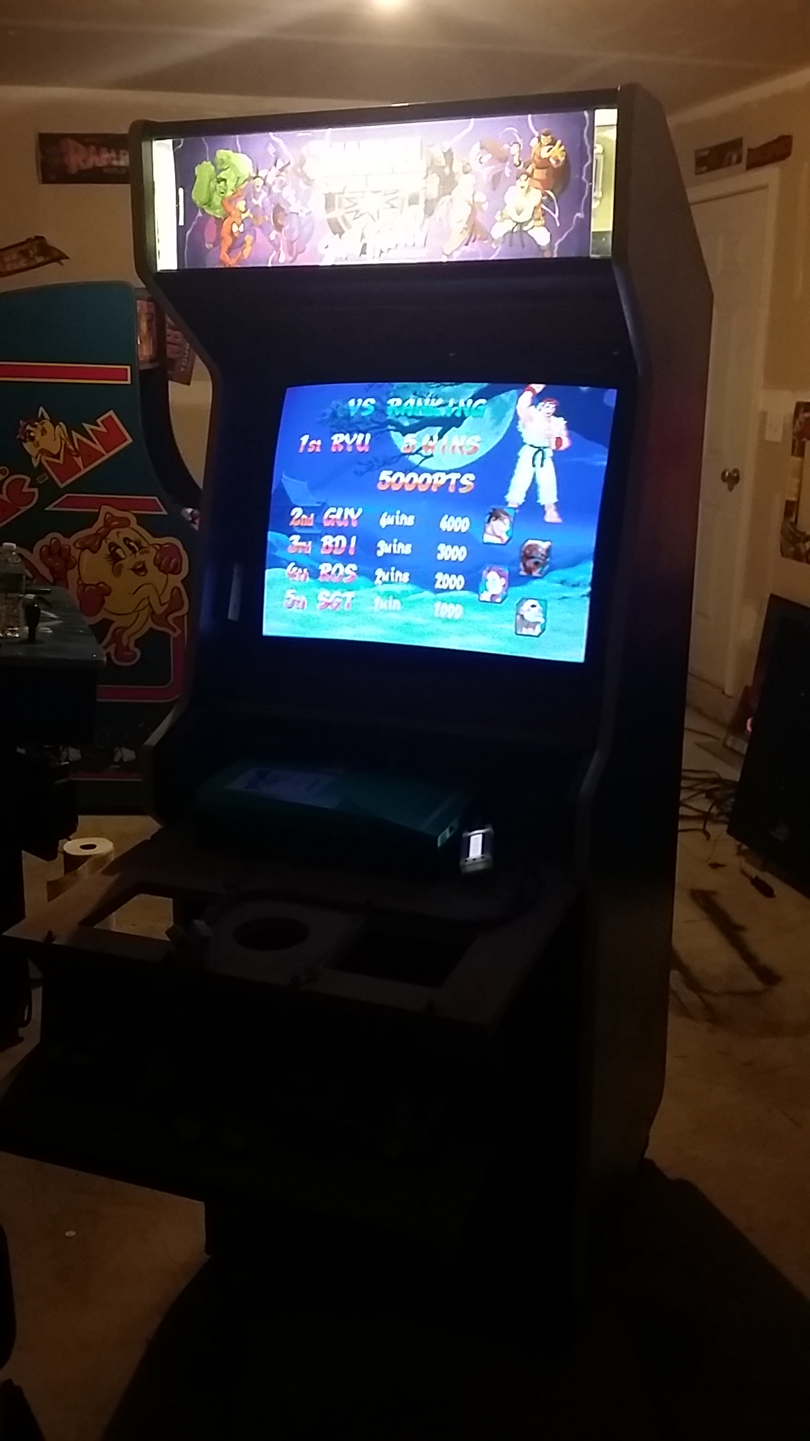

So here is how I got it:
and a nice full frontal picture:

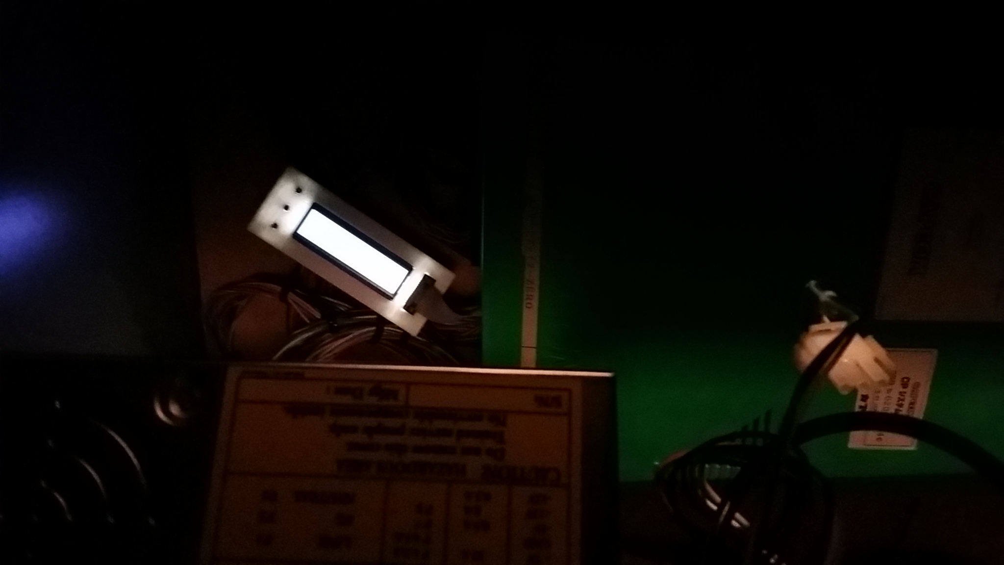

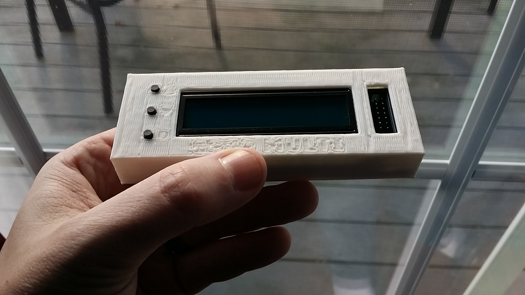

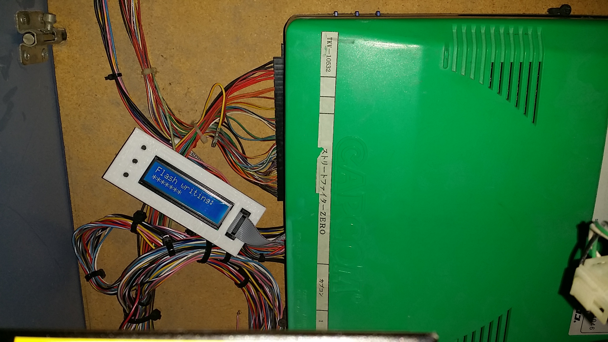

As for a fun game, its all 40(?) or so CPS2 games in 1. Everything from Mars Matrix to Puzzle Fighter, Pocket Fighter, the Street Fighter Alphas, Dungeons and Dragons,etc Every cab I own now plays at least 2 games (except my MKII, but Im considering re-drilling the run button and picking up another UMK3 board)

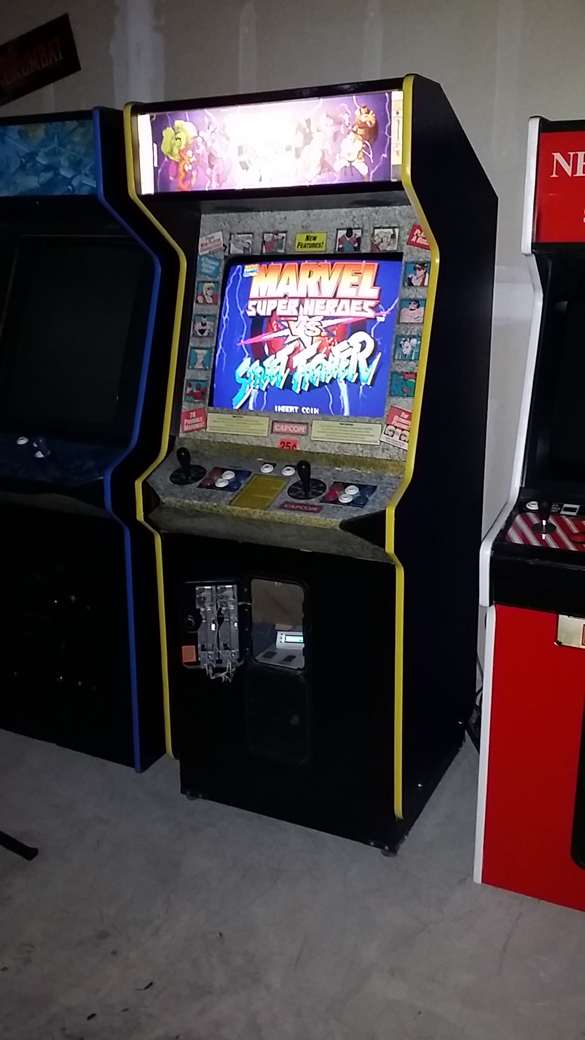

This is my old HS5:
She's still going to get a face lift though, even if I havent decided on colors.

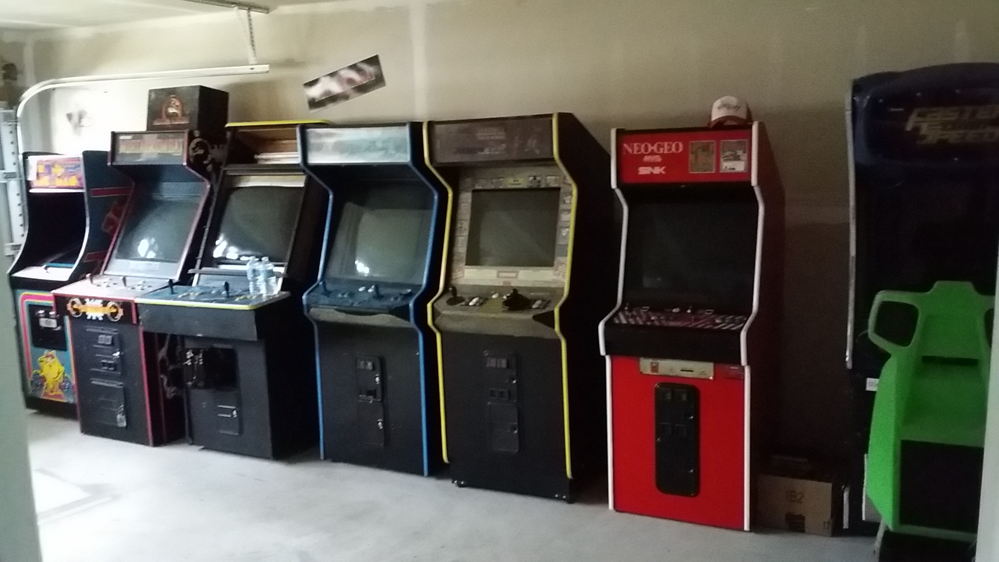

BONUS PIC for PBJ of my rape dungeon!

While waiting for the replacement monitor, I pulled the 27" tri-sync from my MAME cab:
I removed the top 2 monitor brackets, swapped the sides they were on, and rotated them. This raised the mounting bolt up about an inch and the holes still lined up with the ones in the cab, so no new holes were made.  After that I trimmed the bracket on the monitor frame, then put the stock washer and wing nut back on:
pardon the dust!
Screws in the bottom for stability, screen burn is delicious, and you can see the Darksoft kit writing the flash:
Before and After of monitor color, size, position, brightness, and contrast adjustments:
Still need to finish my custom art and get it printed. The wooden frame is a good enough for now bezel, lol.

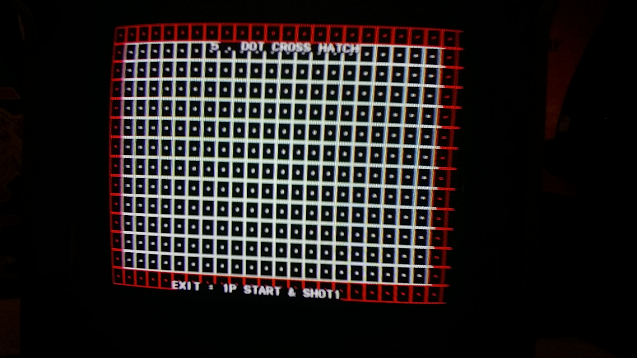

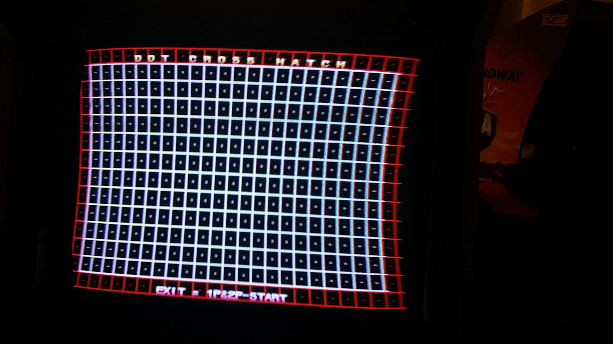

So, squared away the monitor, bought an untested k7401 chassis from ebay , told the guy 75 for the chassis and $20 more if it worked. Got it, it worked, looked NOS, so I sent him $25 as a paypal gift.
At first I put it in and the grid pattern looked like this:
Then I noticed my old non working chassis had a mini adjustment board that his lacked, transplanted that to the new chassis and:
To note, this monitor is a 27" and not a 25" like originally came with the cab.
Adjusting the monitor:
And moving it into it's final stop in the line up, between my HS5 clone cab running Strikers 1945 and my NeoGeo restore:
Heres the 3D printed case I made at work:
Its a little rough, I didnt want to wait long, and its completely functional.
Darksoft kit in action:
Kinda neat how the case is like a nightlight inside:

Here's the complete line up, for now:
not pictured is my Cruisn USA which is on the opposite wall.
Box of NeoGeo carts next to the NeoGeo :)

   Ha, that's a fun story over the monitor, You should get yourself a real pattern gen. however they are like cheap as dirt anymore and really can zero in on issues.....Quite a collection your getting there. 8)
