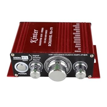

Kinter MA-150 is the worst amp I have ever experienced.  Only really puts out a couple watts.  Unacceptable distortion at any level.
I will not touch another Kinter.
Token
  • Posts: 490
Re: Recommend an amplifier for use in a Mame/Hyperspin Cabinet?
« Reply #8 on: September 15, 2015, 11:13:10 am »
So far the Kinter MA-170 I linked above sounds great. Loud and clear through my cab's car speaker set-up.
Only had it a few weeks, for what it's worth...
« Reply #9 on: September 15, 2015, 11:18:14 am »
I haven't had any issues wi th Kinter either, but BadMouth's post is a good reminder that YMMV.

http://www.oldschoolstereo.com/2011/11/chinese-mini-amp-invasion-kinter-lepai.html
RMS power is the number you're looking at.  The "MAX" is pretty much whatever the manufacturer wants to write on it.
The MA-150 scored an "n/a"  :lol
If you look at the blog entry for that test, it actually achieved 3.4w at 4ohm and 2.1w at 8 ohm.
I drove it at 14.4v for my testing, so I was actually getting a little more out of it.
