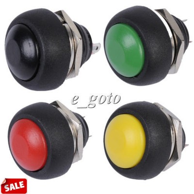

I have added these to my custom steering setup.
They don't light up, but they're small and have a good feel.
