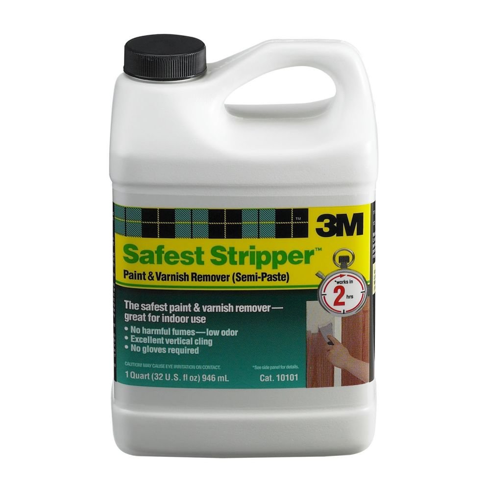

« Reply #17 on: July 14, 2015, 05:56:53 pm »
I use 3M safest stripper. It is very mild and I have had great results with it. Brush on, wait and scrape off with a plastic scraper.
http://www.amazon.com/3M-Stripper-Varnish-Remover-10101/dp/B00002NCJK

« Reply #18 on: July 14, 2015, 08:41:44 pm »
    **Jennifer gets all amused**..... If you put that on your cab you may want to plan on repainting it when your done. If there is a nice factory finish hidden under that paint it WILL be removed.... Before I leave though, It should be pointed out (and you may already know this) that a faulty arcade cab can store a  nasty charge even when unplugged, I once took a jolt that literally blew a filling out of my tooth, Just by touching the frame, Rare Yes, but it does happen, So you may want to read the monitor discharge sticky before you start poking around back there.
