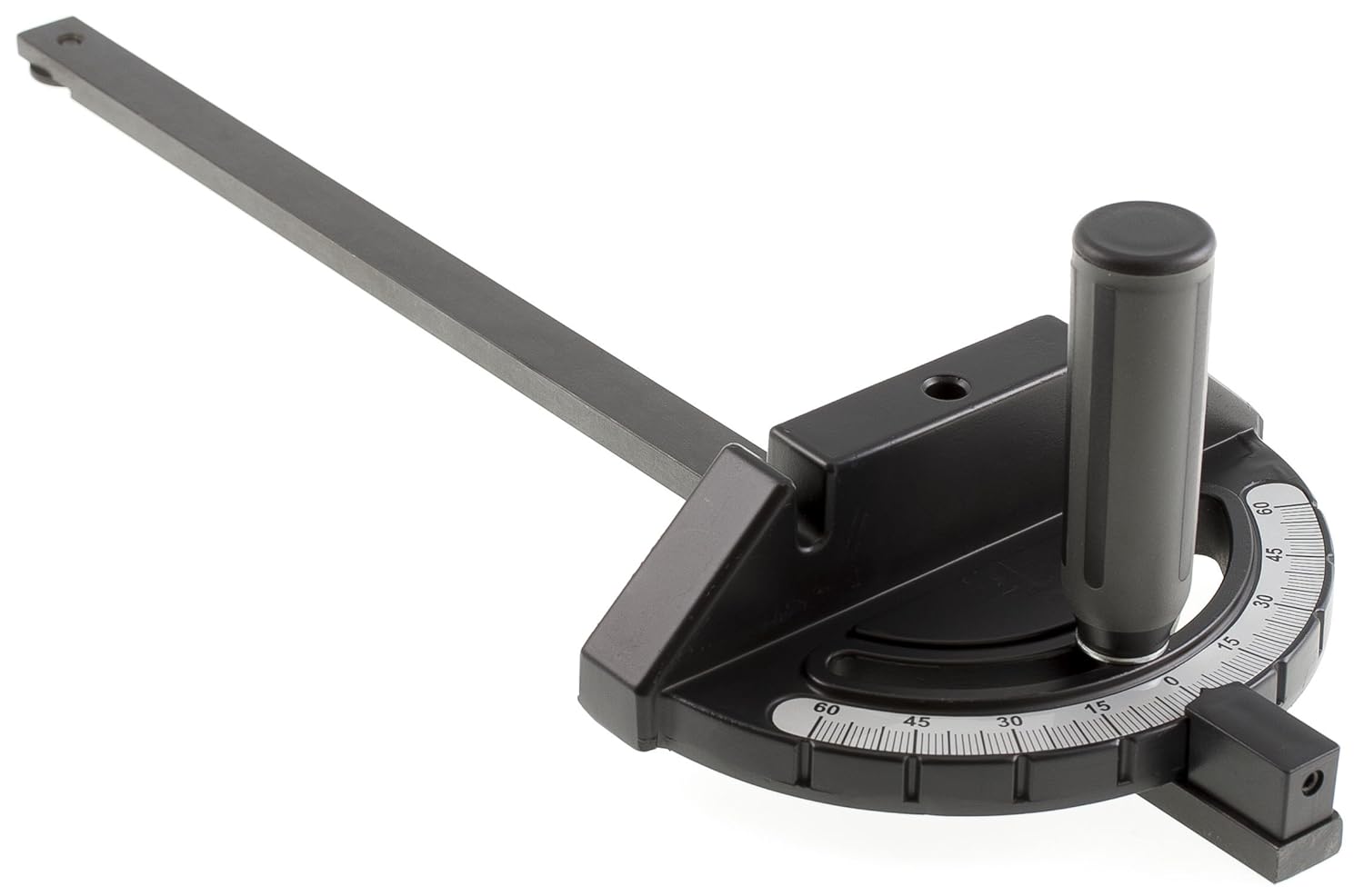

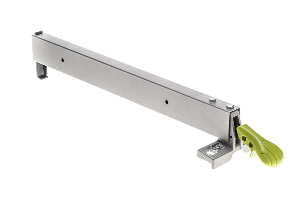

We are talking table saws here right? We may be using different terms, hopefully I can put clearly what I'm trying to say.
Below is a miter gauge for a table saw, it is used for making cross-cuts, or in your case a beveled end cut.
Below is a rip fence, made for cutting boards to narrower widths.
What I'm recommending is a cut like the one below with the table saw blade at 45 degrees.
Although you can use a rip fence to do miters it is much more setup work and I would not recommend it for 6" wide stock unless used in combination with the miter gauge.  See this article for that method http://www.instructables.com/id/Cutting-Precision-Miters-in-Ten-Minutes-or-Less/
