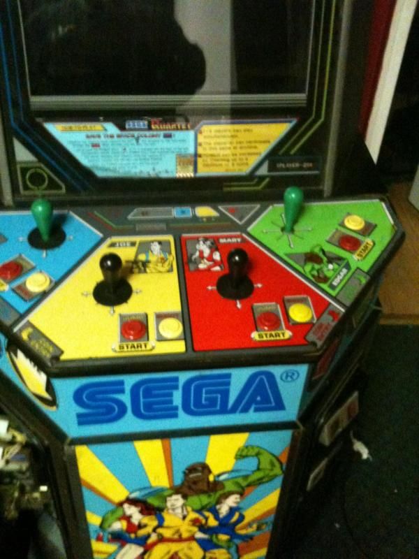

Long story not so short, I work at a somewhat popular bar/music venue in Baltimore and one of my fellow employees came into the possession of an arcade machine called Quartet. It's a terrible, terrible game, and our manager said 'wouldn't it be awesome if we could play that old school ninja turtles on it? That got me thinking about emulators and after days of searching the internet I wound up here. After reading thru dozens of faqs, convos and advice threads I feel like I could turn this crappy arcade game into a great Mame cab. I still have a few questions though..
The arcade cabinet is a bit on the thin side for a game with 4 players.
But our goal is to be able to play the 4 player game such as TMNT on it as well as 2 player fighting games such as mortal kombat 1-3, street fighters II series and hopefully the marvel vs capcom series of games. that would mean that players 1-2 have 6 buttons each and players 3-4 have 4.
I will be going in to do the measurements of the control panel tonight or tomorrow but as it is right now, I do not think I'd have enough room to give players 1 and 2 6 buttons without making it more cramped than it already is.
So I only could think of 3 solutions. First just drilling the new holes for the extra buttons on the existing panel and hoping that only tiny people want to play Simpsons.
Second option was making the control panel wider, which would mean i'd have to build extra support for the eventual drunk person who would mash down on the buttons trying to do some super combo.
or slide the 3-4 player area higher and remove the grey sides of the arcade cabinet shown here
 which would give players 3-4 more room. If I do this then I would have to completely replace the front control panel and I would have to put an LCD monitor inside the cab, since there would be no room for anything else. And I've spent the past few days playing mame games on my 40" LCD TV and I really don't think it's that bad of a picture so I'm sure drunkpeople won't mind. Anyone have any other thoughts?

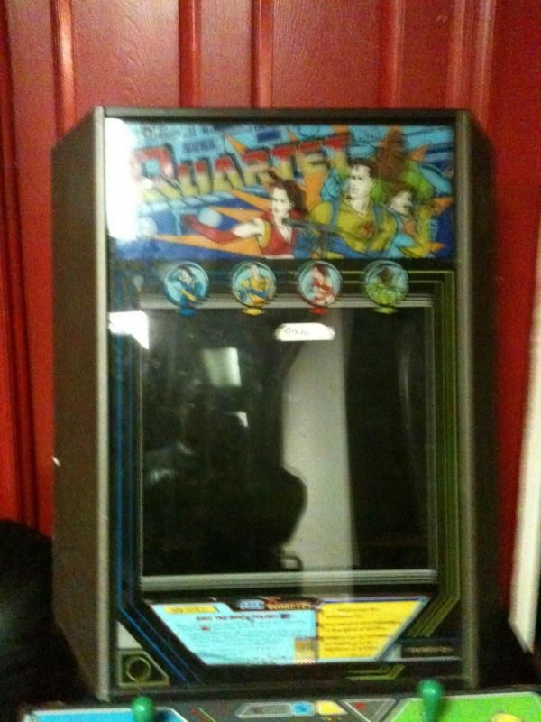

My other question is how in the world am i supposed to turn the monitor on? I understand wiring a power pushbutton to the back of the cab so I can power on the PC, but I can't figure out how I would do the same for a monitor
Since I am going with either an LCD monitor or a television If there is anyone in the Baltimore area who would like the monitor from this arcade machine, please let me know and you can gladly take it. I believe it's in great condition, as we've played this crappy arcade game on it multiple times and have seen no issues. And if you'd like to give me a hand I'd be happy for the help

I like the shape, TMNT was a four player two button game JAMMA harness, quartet was SEGA 16 wiring.
 I say pick up the TMNT PCB, see if someone makes a sega 16 to jamma adapter (or rewire it JAMMA), make some TMNT cab Decals that would be sweet (though cramped).

Since the original post was a little ambiguous on the subject I feel the need to toss this out there.  If you plan on putting this cab in your friends bar, it is amazingly illegal to be running MAME in it.  If you are keeping it at home, go for it.
As far as 6 buttons on P1/P2, doesn't look like there is enough room for it.  I'd almost say to make two swappable panels.  One panel with 2 sticks and 6 button layout and the other with 4 sticks and 4 button layout.

My recommendation is you make a non-invasive mame conversion of it. That way, you can still enjoy the cab, you never know when you will want it back as a pure quartet again. I did this to my first cab, and I am very very grateful I did. I found love for the game and was able to unconvert it from a mame cab and it is the favorite item in my collection.
First thing is do not use the original control panel, make a new one and swap it in. You can keep the old panel still up and running.
If the monitor works, keep using it. Just interface your computer with it. Ultimarc ArcadeVGA or other arcade video card is your friend. No reason to downgrade to a TV.

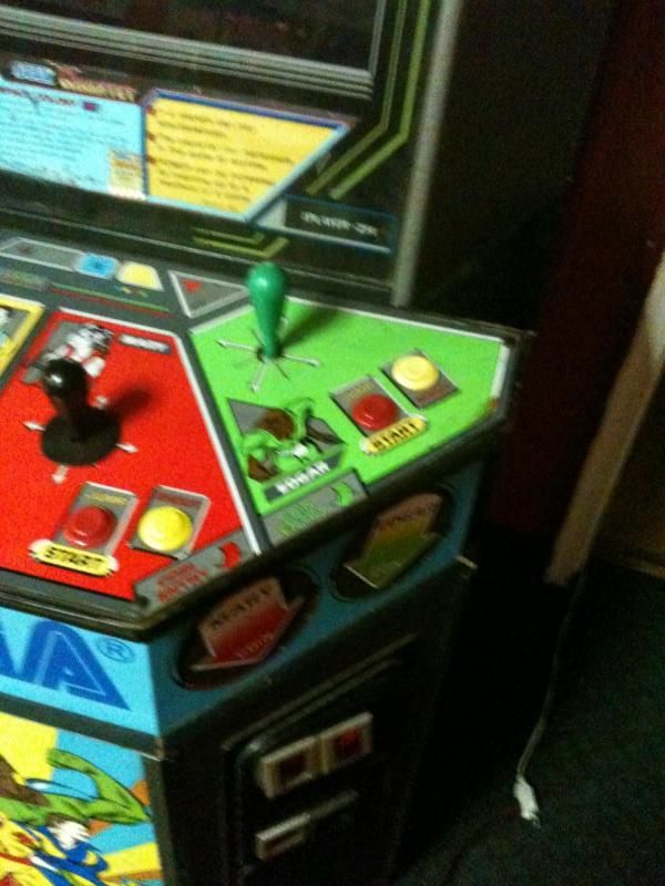

Well here are some pictures I took with my apparently horrible iphone 3gs. They are a bit blurry...
http://i7.photobucket.com/albums/y259/blitzomaru/photo1_zps028667f3.jpg
http://i7.photobucket.com/albums/y259/blitzomaru/photo2_zpse6b5c59f.jpg
http://i7.photobucket.com/albums/y259/blitzomaru/photo3_zps75f83f46.jpg
http://i7.photobucket.com/albums/y259/blitzomaru/photo5_zpsb3683973.jpg
http://i7.photobucket.com/albums/y259/blitzomaru/photo4_zps5855b971.jpg
Also I do have measurements of the control panel. And I even drew up a crude drawing of the dimensions in Paint! Cause I have no life!
I understand members aversion to modifying the cab itself. Like I said, I don't plan on painting it at all. In fact when the plan was to keep it at the bar, we were gonna just tape pictures of myself and 3 other bartenders on the sides of it and the other side would just be covered in band posters. I checked inside the coin slot tonight and there is a ton of room inside of the machine. The board is mounted on the left side so the computer Im putting inside has plenty of room. but when it comes to space it's just too tiny the way it is to do everything I want with it. I just don't want to invest money buying a $75 video card to display 15KHz and when I install the new control panel players 3 and 4 can't see the screen. But since I'm doing all of this for the first time I am more than willing to listen to any advice. If you think I could fit those buttons on a control panel using those dimensions or slightly larger with support, I'm willing to give it a shot.

For control panel, 4 players can be done on a panel like that, but there will be some bumping elbows, which is not too horrible of a thing. It is the same width panel as most 4 player games back in the day. I have build 4 player setups on that size panel before. Tight, but still works. Widening the panel is not an easy option, because that kind of cabinet does not allow for a control panel "Box". Any controls you have that are further out from the side of the cab will poke through, unless you do some bigger modifications.
I stand by my earlier suggestion that you just start a new panel, that way you can get the joysticks placed exactly where you want them. A cabinet that big, you can just leave the old panel inside the cabinet. Just paint the new panel with some black enamel, cheap and easy, and you can pick up some $10 new joysticks if you want because those old ones look kinda sloppy. Doing a test panel from some scrap wood or very thick cardboard is not a bad idea either. That way to can fiddle with your joystick and button placement and get a feel for how to best place everything.

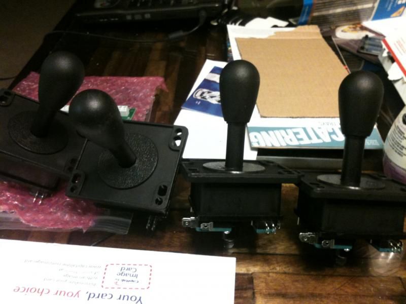

The ArcadeVGA card is 90 bucks plus shipping and handling. I found an old GeForce fx5200 that I might be able to use with Soft 15khz. I have an ancient 15" lcd monitor I could hook up so the bios screen goes thru it and the arcade monitor I have can be the primary monitor when windows boots. Is this viable?
And another question. has anyone tried Amazon for their control panel parts? I browsed there just to check and there are a lot of great deals.

Check this out for layouts.  You can print them out and affix it to the panel.  Drill pilot holes with a drill first, then remove the paper and use a hole saw for the rest.
http://www.slagcoin.com/joystick/layout.html

Another Update. Joysticks and Ipac arrived today. Also, I saw a video on youtube (will try to find it again) where a guy built his control panel using wires from Cat5 cable. I've got like 100m of the stuff, so this should work, right? wires are wires, right?
  • Posts: 7931
Re: first time builder with spacing issues
« Reply #29 on: June 05, 2014, 09:15:19 am »
Yeah, cat5 cabling works.
FYI, check out ground cables pre-made to save some time.
  • Posts: 9752
  • Last login:Today at 07:04:36 pm
« Reply #30 on: June 05, 2014, 04:15:01 pm »
Those wires are usually 30AWG IIRC:
 -- Big enough to handle encoder signals
 -- Can be difficult to strip without damaging strands if you don't have a decent pair of wire strippers
 -- Small enough to often make crimps problematic (you may want to solder the wire to the QD and crimp on the insulation)
 -- Ensure you use good mechanical strain relief to avoid breaking strands
+1 on pre-fab daisy-chain grounds, preferably one with insulating boots.

Thanks for the info. I'll search for cheap premade ground wires. Figured that if Cat5/6 works then it means I have saved money that can go towards something else...
Also, some more good news!
Buttons will be here tomorrow! I put the joysticks together and While they sound really clicky, I'm positive I won't hear them as much once they are installed. I mean my computer is loud as heck when I take the side panel off, but its pretty quiet enclosed. Brainstorming ways to make the joysticks flush with the control panel since I have absolutely no woodworking experience. Here are some pics!

Bad news: The screen on my Quartet game isn't working anymore. it's getting power but it's completely black. I'm googling like crazy but I have no idea what any of the stuff I'm supposed to look for is inside this thing. So I am most likely going the CRT/television route.
Good news is that I have found someone to cut my plexiglass holes for me for almost free (paying in pizza and beer and the first MvC2 match). I'm still a bit torn on the length of the cabinet as it is now so I'm pondering 2 different setups.
staying with the 30" 4 player and cramming extra buttons in. Very few games will require player 3/4 input so most of the space will be for player 1/2 in the middle,
Making a control panel box and cutting out a portion of the cab to fit it in. increasing the size of the cab to 34-36" to add extra space. only problem I have with this setup would be making sure that the panel is tightly secured and I'd need more wood for building the entire thing.
Other good news is that I got 95% of the stuff I want to work in Hyperspin working. Having a problem with Fusion not working in Hyperspin, but it's prolly an easy fix Im not seeing.
 :( That's no good. You should post a thread under the Monitor/Video topic. We have some great monitor gurus here that might be able to help.
