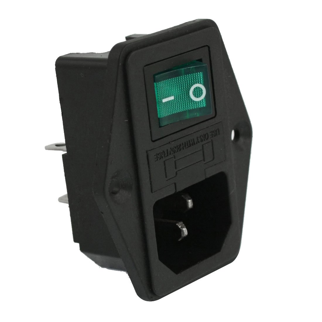

I've seen several threads in the past where people mention using something like this to connect a power cable:
http://www.amazon.com/Interpower-8301213-Disconnects-Socket-Rating/dp/B00917Z96S/ref=pd_sim_hi_3?ie=UTF8&refRID=159FSM9SRCYS21931FMQ
I have a smart strip for the inside of the cabinet.  Should I solder something like this to the inside of the inlet:
http://www.amazon.com/dp/B008X0WM5U/ref=dra_a_rv_ff_fx_it_P2000_1000?tag=dradisplay-20
Or is there a cleaner way to do what I'm trying to achieve? I'd rather just have one piece, but I'm guessing something like that doesn't exist.  If not, what's the best option for securing the inner piece?  I don't think letting it dangle from the wires would be the best option.  Also, I've seen people use one with a power switch.  Has anyone had success in wiring the computer power button to the switch?  I would think it wouldn't work since it's not a momentary switch.

I originally used a slim surface mount electrical box from Lowe's on the inside.
http://www.lowes.com/pd_153257-35681-CH48S-W_0__?productId=3544302&Ntt=mono+systems+electrical+box&pl=1&currentURL=%3FNtt%3Dmono%2Bsystems%2Belectrical%2Bbox&facetInfo=
I painted it black, used a black cover and black outlet.
It worked and looked nice, but the plug kept getting in the way of my video card due to the way my mobo was mounted.
So I switched to a very short cord with a screw together outlet on the end.
In the end, I wish I'd just chopped the plug off the end of the power strip cord and soldered it directly to the inlet.
One other thing to note.  I used a random old pc power cable that was laying around and it ended up melting the inlet due to a poor connection.
It was probably corrosion.  Spend a couple extra bucks and buy a brand new cable that's rated for a decent amount of current.
IIRC, my current one is 14 gauge.

You should cut of the plug of the smart strip and solder the cable to the back of the socket outlet (the first picture in your starting post). You can also use an outlet with a switch. Connection is the same as the one without a switch.
Check the connections on the back of the outlet, they usually use .250" QDs.
Either way, make sure you have solid electrical and mechanical connections.

I like these from amazon - search IEC

I recently purchased a similar (10A, fused) power input module and I ended up wiring it to a female socket which will sit on the inside of my cabinet attached to a power strip. I also got a sheet metal mounting plate made to fit the snap-in module. I kind of wish I could have found a wood-mount one in my local electronics store.
Hope this helps you figure out what you want to do.

Are you using the switch to turn off the entire cabinet, or did you find a way to turn the pc on with that?  I'm guessing you can't since it's not a momentary switch?

You can switch most PC's by setting them to auto start on power on in the BIOS. This way the PC will start when you switch on the power for everything (PC, monitor, marquee lighting, etc.).
I did it on my cab. Works perfectly fine. I mounted the power switch on the top of the cabinet so it can be reached more easily though...
The mains comes in from the bottom via a cable with a power plug. It goes to the top of the cabinet were it is switched on/off and goes back to the plain power strip were all electronics including the PC are plugged in. When I hit the switch on top the PC boots into Hyperspin. On exiting Hyperspin the PC is shut down.

I only use that switch when I want to cut power to the entire cabinet and still keep it grounded. I use a momentary button in a more convenient location for turning the PC on and off. Then I use a relay connected to the PC molex connector to cut power to the rest of the components.

Any power strip will do. I removed the power cord and used it as inlet (it's the black one on the picture).
