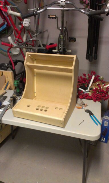

• Material 3/4 MDF
• No plans
• Hand Saw, screws , glue, oscillating  and drill r my only tools
• Wish me luck
•The hard part making  the cut for t molding  :o
• Working Table " Boxes of Directv Satellites"
•C clamps "boxes of dish parts"
SO FAR

looks good for no plans or anything. Have any tools to make the t-molding slot?
Caparo8bit
  • Posts: 504
  • Hyperspin/Maximus
Re: My first build "Bartop"
« Reply #2 on: March 10, 2014, 09:48:48 pm »
No..... And yeah im doing piece by piece my only problem is how you guys do to hold or place plexiglás from control panel to the top?
« Last Edit: March 10, 2014, 09:50:57 pm by Caparo8bit »

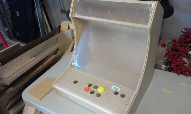

Cutting Plexiglass for Marquee. Oscillating tool is a must.
« Last Edit: April 04, 2014, 12:25:58 pm by Caparo8bit »

You didn't score it enough.  You need to score it at least 1/3 of the way through.  Usually for my plexi, I score it about 15 times.
AJ
Caparo8bit
  • Posts: 504
  • Hyperspin/Maximus
« Reply #26 on: April 04, 2014, 08:00:20 pm »
yeah but is way easier with the electric tool. Also any advice on a good marquee light??
« Reply #27 on: April 04, 2014, 08:35:24 pm »
Yeah, I use my tablesaw to cut marquees and bezels. Much easier.  :cheers:

Primer Time   " Still waiting for router from home depot"

« Reply #48 on: April 18, 2014, 06:03:59 pm »
Getting ready buttons layout..... I think looks good . Gonna end using paddle bits  $19.99 for set of 10. Home Depot didn't want to ship Forstners bits "pick up oly" weird they ship a router but not a bit set. Also in my local  hardware store those bits run from $13 and up ea  :dizzy:
« Last Edit: April 20, 2014, 01:24:30 pm by Caparo8bit »

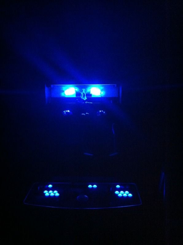

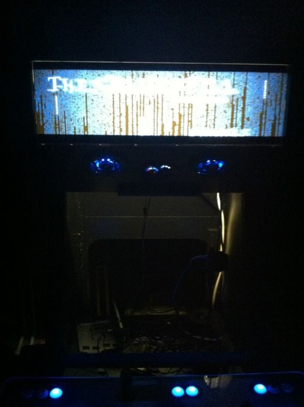

« Reply #54 on: May 17, 2014, 04:37:53 pm »
The insides 95% complete
How decased laptop is mounted to allow more air flow.
*******Still working on mounting  joystick and right side art************
« Last Edit: May 17, 2014, 04:42:42 pm by Caparo8bit »
