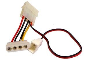

  • Posts: 9709
  • Last login:Today at 02:16:51 am
Re: A lot of noob questions
« Reply #33 on: June 30, 2013, 08:14:14 pm »
Sounds like you want something like this or this or this.
Use search terms "fan power cable molex" at your preferred vendor.

Sig-
Our discussion started with how you would power the amplifier and I had bought connectors six months ago that would allow you to connect through the power cords that Scott (PL1) showed you.  But like I said guys have been doing a setup like I posted earlier.  I apologize for not showing you a tutorial.  Hopefully I can pull something together by mid week.
