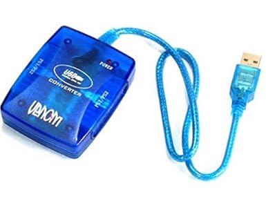

i dont have any lags with my venom ps2 usb converter
however, these are hard to find now. check ebay and amazon etc

Yes, my comment was not meant to be an indictment of USB.  One can do pretty much anything, with proper firmware and host driver support.  It was meant in the context of the converters, shown in a couple of posts up, as these are usually HID devices.  Of course there's a whole other level of data massaging in those boxes as well, with their own latencies, event ordering, etc...  This brings me to something else I thought was somewhat amusing;  not too long ago I watched a video where someone meticulously set up a test to have a single button connected to two different controllers (not one of ours) attempting to find out which had less lag in getting the event to the PC.  The results favored one fairly often, but not always.  Of course each controller was connected to a different USB port on the system.  This really demonstrates what I was referring to.  If one controller was faster than the other, even by a tiny bit, and the PC handled the events strictly in a FIFO arrangement (nearly impossible on the processing side across two different ports) then the faster controller would always, and without exception, be processed first.  This, of course, didn't happen and the "tester" didn't seem to bother swapping ports and conducting the same tests for comparison.
