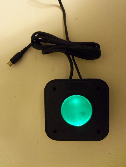

When I routed out the space for the trackball on one of the builds I had the trackball rotated incorrectly. I searched all around the forums and found similar posts but they were not the same trackball and it is a PS\2 one and I don't think I can just switch wires up...or can I?
It is one of these
For clarification, when I move left and right the mouse moves up and down, etc.
I know of the issue of rotating it will be a different spin, the games being played with it wont really matter though so now worries.
I guess what I am asking is a software way of rotating the axis, I can't seem to do it in Mame32p or anywhere else.
Thanks in advance.

Yea sorry, 90 is what I meant.
They are almost a perfect square but the clips that hold it together on the sides are a smidgen to big when rotated. The space I routed is too small when turned to the side. I would have to route out more space, and art, wring, tmolding etc is all in place.

Is it close enough to where you can pull the TB and grind down the clips?
Degenatrons mounted one of these without a top half here, so you might be able to get away with just grinding the clip (by the screwdriver tip), even if the the two halves don't stay together when you remove the mounting screws.

If it's only running MAME, you can remap the axis in MAME (TAB while in a game>Input(General)>P1 controls>track x).
It will still be screwy in windows, but the MAME games will work fine.

Only need it in MAME but I have tried messing with settings, it only allows for reversing the axis not switching them.

Mame Menu - Input (General) - Player 1
1. Clear the Track X Analog, Track X Analog Inc and Track X Analog Dec (highlight the input, press enter, press escape)
2. Assign input to Track X Analog (press enter then move trackball the desired direction)  Leave the Inc and Dec as "none" unless you plan on using a joystick to play a trackball game.  :dizzy:
3. Repeat 1 and 2 for Y axis.
4. Repeat 1-3 for Mouse inputs.
5. Repeat 1-4 in Player 2 menu.
EDIT: Forgot that you'd need to edit for all games.   :banghead:

ANyways, I couldnt find a software fix so I just flipped it around and used plastic cement stuff I found at the hardware store. He was really wanting the Arcade done tonight. Updated 4-Player thread with pictures.
