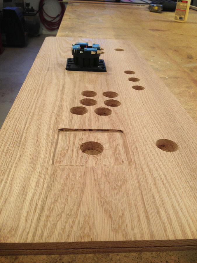

On to the creation of the CP. I rounded the corners and slot-cut this piece. Notice the slot cut is not in the middle. After slot cutting the piece we ran it through a planer and took off about 1/16th of an inch from the top of the piece. This is so the clear acrylic, once placed on top, will sit perfectly flush with the top of the T-moulding. Details details. :)
You can see here the button layout I'm going with. Traditional Japanese style, but with only 6 buttons. I'm not using the right-most two buttons from the pic. I really like this joystick spacing and wish I would have used it on my bartop. I might re-do the CP on the bartop with this layout.
After drilling all those holes, I clamped my acrylic on top and got to work with a router and a flush trim bit.
The result is a perfect fit all the way around. Note the jaggies on the acrylic - that's the protective plastic that they put on the top and bottom so it doesn't get scratched - it's not rough. The actual cut is like factory. I love that flush trim bit!
Next I got to work with the Dremel drilling out all of the button holes. This takes a while, but using a standard drill bit in a Dremel tool really works well here. The holes end up perfect.
Many holes. :)
Button test fit. Poyfict.
Now it's time to fit the joysticks. I like to recess these - not a lot, but just enough to add stability. I went about 1/8" deep here. Could have gone deeper, but I wanted to keep as much real board there as possible just in case fighting game combat gets vigorous. :)
Notice there that the top 3 buttons holes are smaller than the rest (11/16" vs 1 1/8"). Those 3 buttons are going to be Ultralux lit buttons. I have a red one, green one, and yellow one for "Exit," insert coin, and power respectively. I made custom labels and put them inside the buttons. I'll get pics of those later. I was going to use lit buttons for the whole CP, but they're a bit stiff and I really like the feel of standard buttons. I read about the spring removal trick after the fact, so I might play around with the buttons and see if I can make them feel more like the Happ buttons and might toy with the idea of replacing them.
