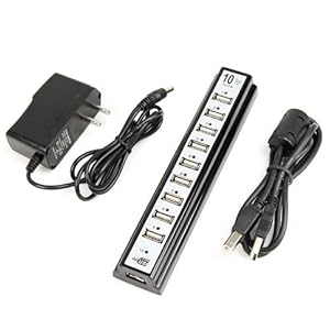

« Reply #6 on: April 05, 2013, 07:55:18 pm »
And remember that USB can only provide 500mA in total.
Minor clarification:  USB spec says that a powered USB hub port can provide 500mA.
If you are using an unpowered hub port, that it is limited to 100mA, though many hubs can exceed that spec.
