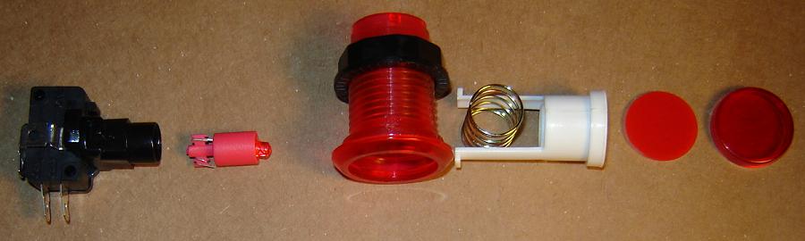

Hi there, I just got my LED-Wiz, and EZ Lights wires in the mail today. I switched out 90% of the buttons on my XArcade Tankstick with ones that include LEDs... and thats about where I am. I want to hook this up using only USB for power since I dont have alot of buttons to light and I have absolutely no idea what goes anywhere, the buttons with the LED's dont even indicate + or -.  I am just starting to mess with this stuff so I dont know all the electronics lingo.
I'm looking for just a simple, "this plugs into this" guide, pictures would be nice.  In laymans terms preferably.
Any help is appreciated, thank you.

I'm assuming you have LED buttons like this.
When you break it down, it looks like this.
From left to right, there is a microswitch and LED socket, LED holder, button body, spring, plunger, diffuser that rests in a depression on the top of the plunger and is held down by the translucent cap.
The microswitch works just like the switch in the tankstick button and is wired the same way.
The daisy chain ground goes to the common terminal on the bottom of the switch, and the input to the encoder connects to the NO -- normally open -- terminal.
The LED socket terminals hang down like stirrups on either side of the microswitch -- easier to see them in this photo where the microswitch has been removed from the LED socket.
To keep the wiring consistent and easy to remember, I connect the terminals on the side with the larger black plastic tab to black wires / ground. (the side on the bottom of the picture above)
The red wire / operating voltage connects to the other terminal. (the side of the socket on the top of the picture above)
If the LED doesn't light up, just unplug it, turn it 180 degrees, and plug it back in.

Well I must be an idiot or I somehow bought 90% non-working LED buttons. I took that harness and hooked the pos to +5 and black to ground and tried hooking all the lights up for a simple always on configuration for a test run. For some reason, only 2 of the 13 lights I had hooked up lit up. The 3rd one in the chain and the last one in the chain. By coincidence, the first one I manually tested, with the 1st connections in the chain, ended up being the 3rd one...  I can't imagine that 11 of 13 LEDs are bad?  I got these from Paradise Arcade. I also tried it with these

« Reply #12 on: April 11, 2013, 09:27:45 pm »
Per the last line of this post, have you tried unplugging and turning the LEDs around?
Since two are working, you probably just have the polarity reversed on the rest of them.

Ok so it turns out that they aren't all set with the + / - on the same sides. I figured they would be. I got most of them working except for 2.  These are numbers I can work with. Thank you guys for all your help.
