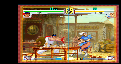

The frame sizes of arcade PCBs are designed to match the safe area of the NTSC standard, in most cases. They don't care of the 59.94 Hz refresh rate (nor 60 Hz), because monitors are feeded with RGB signals (so there's no need to work with color sub-carrier in mind), but they care about centering a picture which will be visible in every monitor, even by knowing these monitors won't have the same geometry settings (more or less overscan, slighty off centered), and the fact that most arcade operators don't take time to adjust the picture position, even if it's easier than in a consumer TV.
For example, the CPS-III (384x224) : the total frame size is 486x259. Why such numbers ? ( that aren't convenient multiples of 8 )
Because for this frame size and this pixel clock (7.5 MHz) the size of the active display matches the 5% overscan area of the NTSC standard.
The refresh rate is around 59.58 Hz (and 15.432 kHz for Hfreq), numbers which don't respect NTSC frequency (neither a 15.72 kHz@60 Hz arcade "standard"...), but that's not the point. The goal is to match the geometry and position of the picture that correspond to NTSC, because arcade monitors are adjusted according to that.
Same goes for arcade boards that display 320x240. The frame size is over the regular 262 lines in order to be sure to display the 240 lines within the NTSC safe area (because in NTSC, you do have 240 lines of active display, but the overscan is set in such a way that you end up seeing only 224). So most arcade boards designed with 240 active lines display them inside a ~ 270 lines frame. Then the refresh rate goes lower than 60 Hz, because there's no need to rise the Hfreq (and having higher pixel clock) to stay close a 60 Hz or a 59.94 Hz standard. Typically, those boards are around 57-58 Hz, accordingly a 15625 Hz Hfreq, which is a very convenient number that seems to be the real standard over 15720 Hz. These boards are designed with frame of 270 lines (and more), not with the operator adjusting his screen in mind...
Arcade boards work with pixels clock such as 4,6,7,8, 10 MHz, which come from the division of common oscillators values. They usually work at 15.625 kHz, and often under that. The active display of the game is always within the active display of NTSC, with overscan taken into account.
So, when you specify modelines close to those parameters, you have more chance to match the exact frame duration of the original game, and there's no trouble to get a centered picture with a size close to full screen (with little adjustements of H and V size on your monitor).

Let's consider the CPS-III case you pointed. This would be the theoretical modeline that preserves the original frame time (the totals are what matters, the porches are guessed):
Modeline "384x224 15,432 KHz 59,58339 Hz" 7.500000 384 400 432 486 224 236 239 259  -hsync -vsync
I'm going to keep the original number of lines. Now, when porting this to normal PC hardware, the first thing we have to do is normalizing the htotal to the next 8-multiple, otherwise the video card will silently do it for us, ruining our timings. With this in mind, we can no longer use the original pixel clock. For this new htotal, I'll take the closest real pixel clocks from my look-up table, and this is what I get:
Modeline "384x224 15,427 KHz 59,56581 Hz" 7.528643 384 400 432 488 224 236 239 259  -hsync -vsync (-0.0175 Hz)
Modeline "384x224 15,445 KHz 59,63435 Hz" 7.537305 384 400 432 488 224 236 239 259  -hsync -vsync (+0.0509 Hz)
As you see, we come close, but not enough to get a perfect 59,58339 Hz figure.
Now, let's try adding a line. Again, I take the closest pixel clock from my look-up table, and this is what I get:
Modeline "384x224 15,491 KHz 59,58231 Hz" 7.559804 384 400 432 488 224 236 239 260  -hsync -vsync (-0.0011 Hz)
Just -0.0011 Hz off, not bad!

See the thing :
This is the 488x259 frame. The timings of the NTSC standard had been reported to this frame size. Black is blanking, red border is 5% overscan, yellow is 10 %, blue lines are the 720x480 active display and show the center of the picture (which you set according the center of your own screen, whatever size it is, flat or curved, Trinitron or regular). Choosing between 16 or 24 (the closest values allowed) won't let me reach the center. The picture will be off centered anyway, and the active display of the game will have some lines outside the 5% area I had set, and a black border at the other side.
So, back to service mode...  :-[

Well, at this point, you can think of getting a Matrox card ^.^ , or simply double the horizontal timings, in order to get a better granularity equivalent to 4 px. By displaying a 976*259 frame (with 7.53x2 = 15.06 MHz Dclk) I can get something close to the original duration, and manage to get an almost perfectly centered picture, that evenly matches the 5% overscan I set in my TV (because every screens are supposed to have at best 5% overscan) :
( here the Vsize is doubled too, for better visualization ).
See how the active display nicely matches the 5% overscan area (something that explains the 486*259 frame size), and the fact that even if the game is displayed by an old monitor with larger overscan (10%), all HUD informations are still visible. That's the way to do it.
