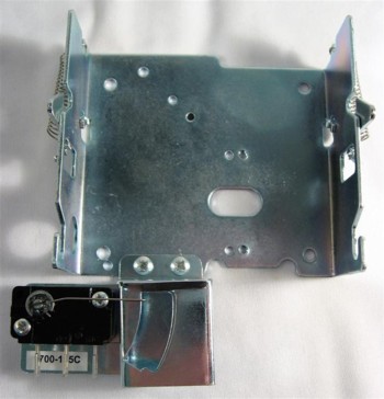

Something like what is attached to the bottom of this:

« Reply #15 on: March 16, 2013, 11:08:18 pm »
Dgame:  where did you find this pic?  I think this is what I have.
I think I'll see what I can do with a switch...i picked one up today.

Re: Coin Mechanism - will it fit?
« Reply #16 on: March 17, 2013, 04:17:49 am »
Product Description:
A channel assembly with latch ears and coin switch & chute only - no coin mech.
http://www.coinmech.com/product_profile.cfm?id=465
