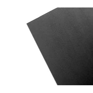

I'm looking for something with a texture similar to Formica laminate, but with greater bendability so i can wrap it around the front of my radius'd control panel lip. Does anyone know of a plastic that would fit the bill?

« Reply #2 on: July 28, 2012, 02:55:50 pm »
Not sure what color/texture you are looking for.
If you find a polycarbonate that looks good, it bends fairly easily.
Another great choice is Kydex.
Example of working with it: http://www.defensivecarry.com/forum/defensive-carry-holsters-carry-options/39371-make-your-own-kydex-holster.html
Different colors and thicknesses available: http://www.amazon.com/Kydex-T-Sheet-Thick-Calcutta-Thickness/dp/B004U6TNTE/ref=sr_1_1?ie=UTF8&qid=1343299612&sr=8-1&keywords=kydex

I should say, I haven't tried doing any of this yet, i'm just trying to plan ahead. I cut out blanks for my interchangeable control panels yesterday out of 3/4" plywood and radius'd the front of them, as they will be sort of a lip that sticks out in front. I've never worked with laminate before, but it was quickly brought to my attention by my dad that it would probably crack if i was trying to make a bend that tight. After visiting the hardware store today and holding a piece of laminate in my hand, I figured he was probably right. The internet made it sound like I'd want something with a MUCH larger radius if i planned on bending Formica around it. Which is why I thought some sort of plastic would be nice.
Yep, the stuff shown above looks about right. Black, kinda glossy, with a fine texture. Whatever the X Arcade panel is covered with feels perfect to my hands, and i'd like to use something with that feeling. What kind of store do I buy the stuff you guys posted at? Is that something that'll be in a hardware store like Home Depot or Menards (if anyone here knows what Menards is...) or will I need to go somewhere special? If it IS in the hardware stores, what department? I'm tired of asking their employees where stuff is and getting walked around to a bunch of different departments until someone knows what I'm talking about. Home Depot didn't know T-Nuts the other day. Sigh.

Kydex is a bit specialized, so Lowes, Home Depot, and Menards don't carry it.
I doubt you'll be able to find it in stores, unless you have a specialized reseller or someone making custom gun holsters/knife sheaths in your area.
Second online source to consider:  http://www.knifekits.com/vcom/index.php?cPath=41_54_136
