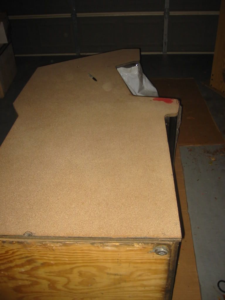

Well I've got the cab completely stripped at this point and I'm still sanding and getting everything silky smoove for priming/painting.   I have a question though, I need to take the monitor out before painting and I'm almost positive it's been replaced.  What I can't figure out is how it was done!  The back of the cab comes off in 4 sections. A small section with the screen/vent above and behind the monitor, a larger 3x2.5 section RIGHT behind the monitor, and two more below.  My problem is that I can't seem to figure out a way of removing these piece of wood without destroying them!  Anyone here with more experience on removing a monitor from an MVS?  The two smaller pieces do have screws in them so the come off real nice and easy.
You would think it was designed to have several pieces removable via screws, so what I'm thinking is that this arcade op (I met him, he was really weird and.. well.. weird) just stapled in the other two pieces when he replaced the monitor.
Any help is appreciated. I guess I could just rip the pieces off and replace them with 3/4" plywood pieces, but I don't want to risk hurting the rest of the cab. Help!

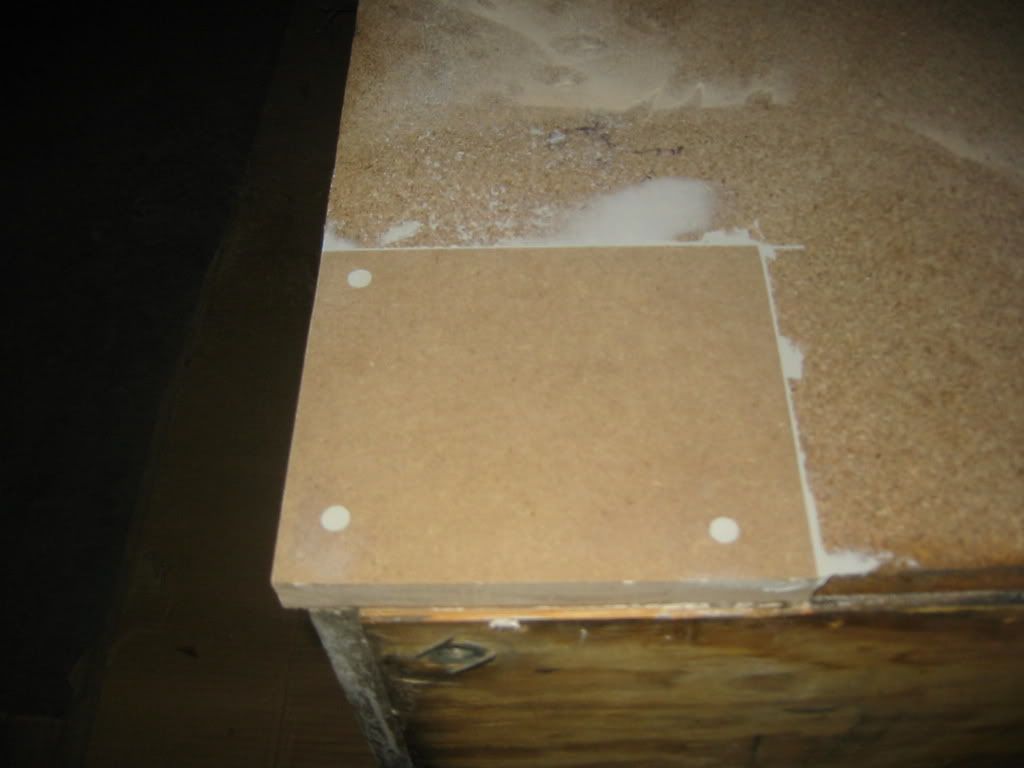

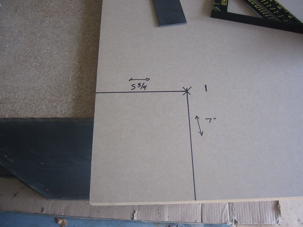

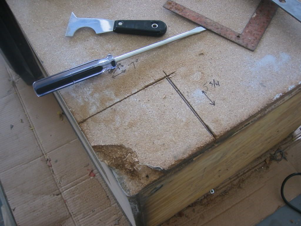

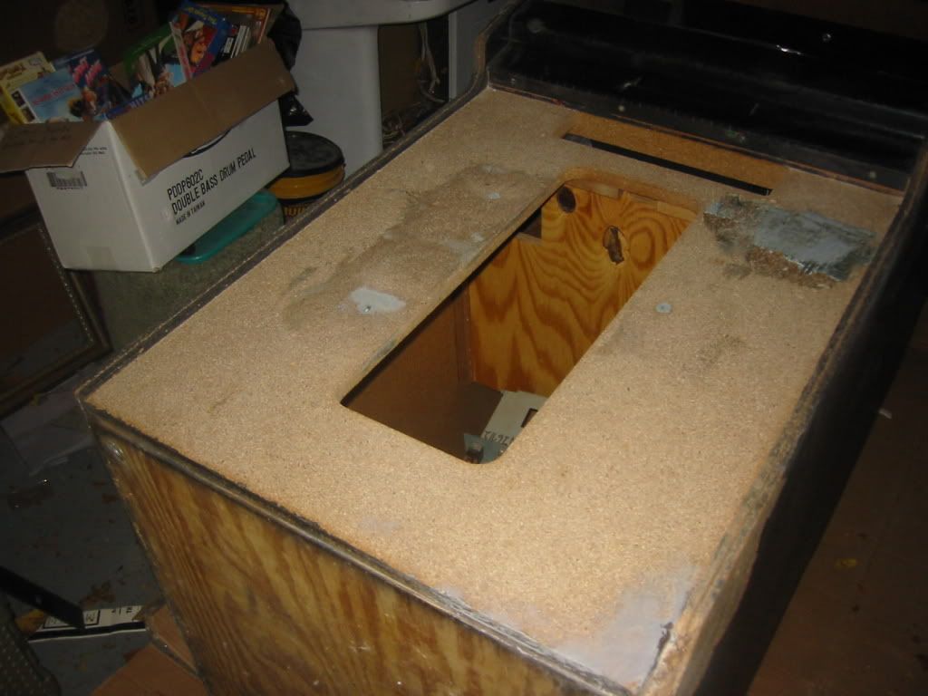

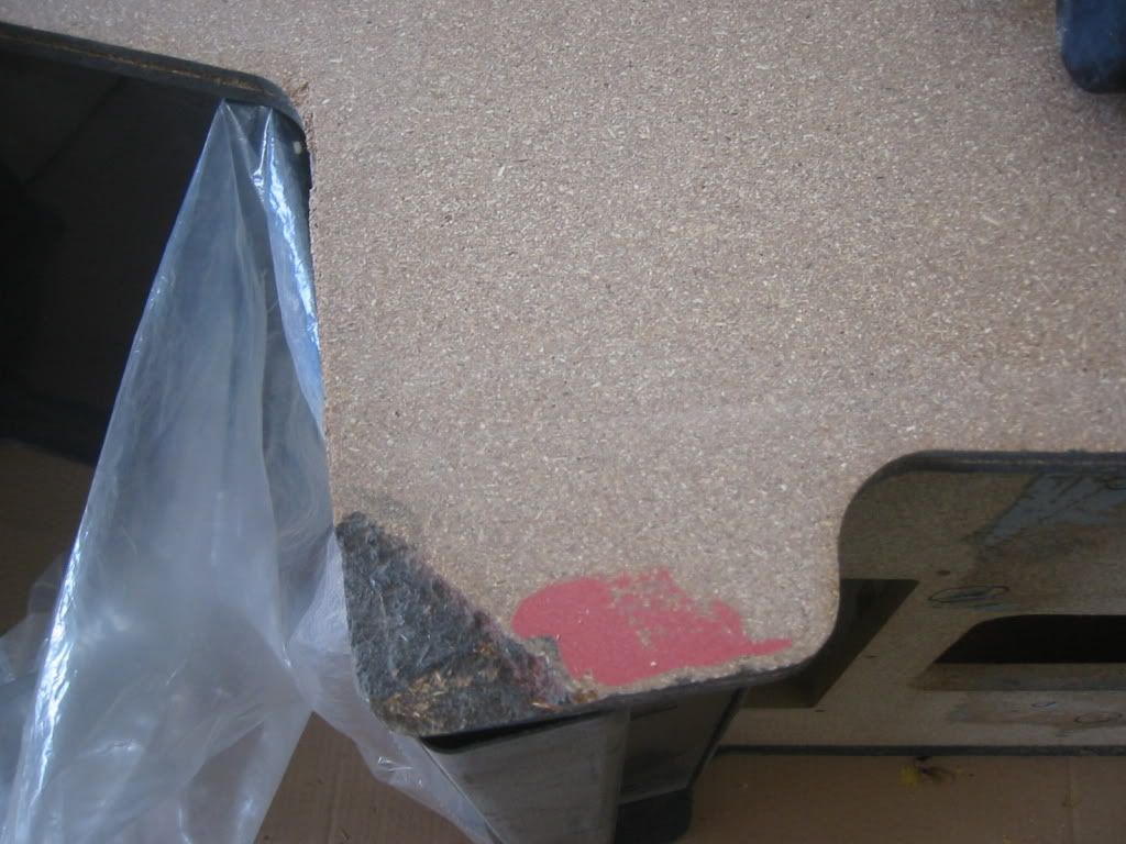

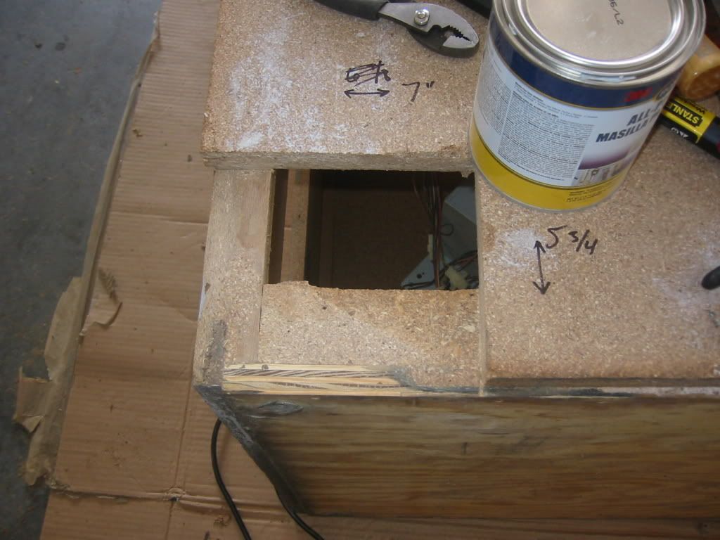

Hey all. I still haven't gotten around to removing the monitor, but only because of two things. Laziness and bad weather that prevented me from working on the cab.  But I got some nice 70 degree weather today so I decided to do a little more work. I've begun the reconstruction of the bad pieces of MDF.
Not sure if I've posted a pic of the bottom right-front corner of the cab, but you can see the damage even though I've already made the first incisions.
Here's the piece removed:
I still need to fill some of the lower part with some bondo putty to make sure it's level.
Here's a pic of the new piece that I hadn't cut out yet.
Once I've got that filled in and ready for replacing, I'll glue it down with some woodglue, and then secure it with some countersunk wood screws.  Here's the CP damage
This one might be tricky because there's damage further up that you can barely see up toward the top curvature.  I don't have a router so replacing this one will be a challenge, I think.  I probably won't get started on this one today though since I have some other things I need to take care of today.
my MAMEcab progress blog: http://www.lealmedia.com/mame/

« Reply #7 on: December 26, 2008, 06:15:32 pm »
I am a carpentry MASTA!  :afro:
It's not 100% perfect, but for my needs, it will work great. Can't wait to see it painted so it won't even be noticeable! Now to work on the other damaged section.

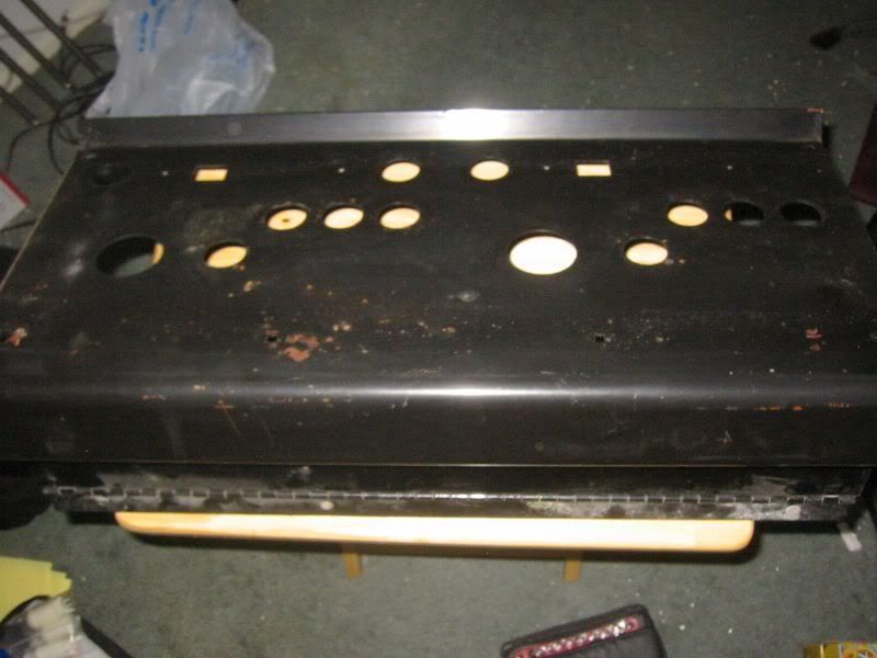

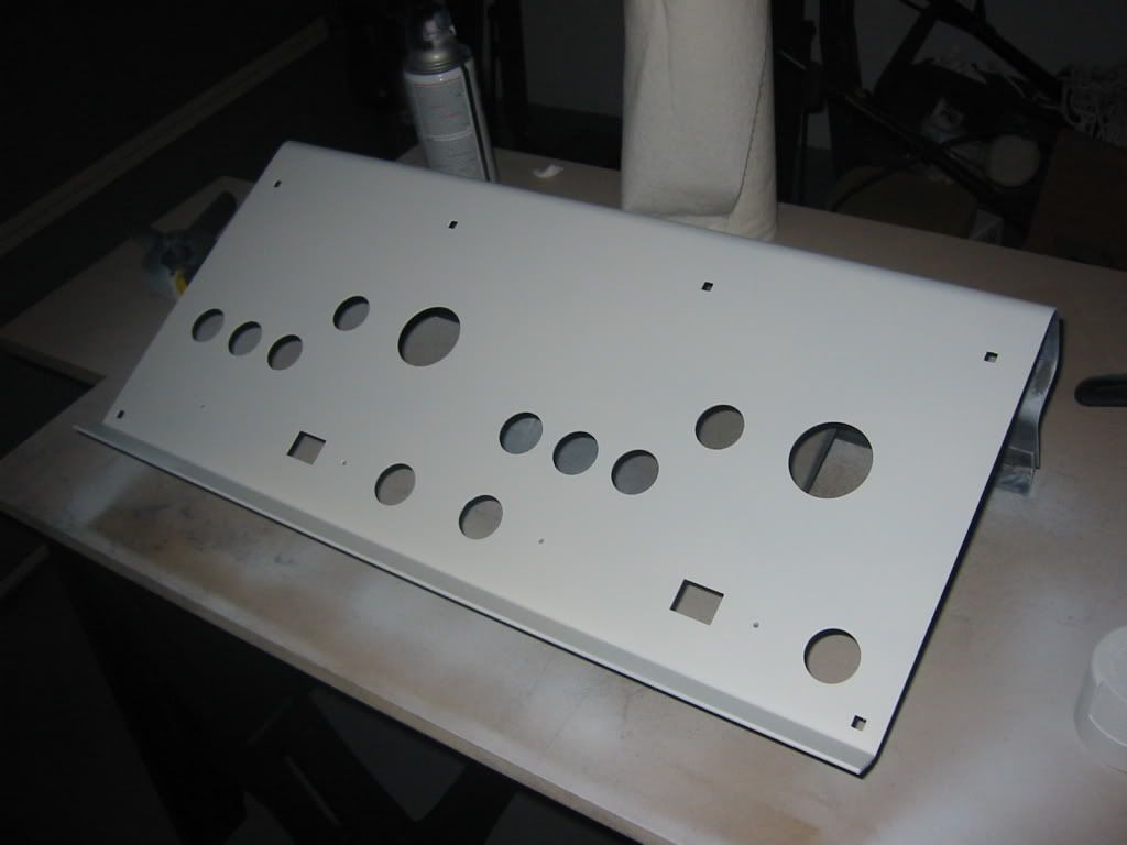

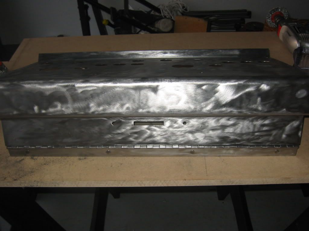

Been forever since I worked on my MVS but I finally had a few extra dollars for some tools and paint so I went to work on the control panel.  Here's the original, sorry for the blur:
Stripped and ground with a drill/brush attachment:
First coat of primer. Still drying so I haven't sanded it.

2nd coat of primer is now on and has been drying for about a day. I was informed that I should wait 7 days or so to let the primer cure completely before painting so I guess my plan to put the CP back together this weekend is not going to happen.  Oh well.

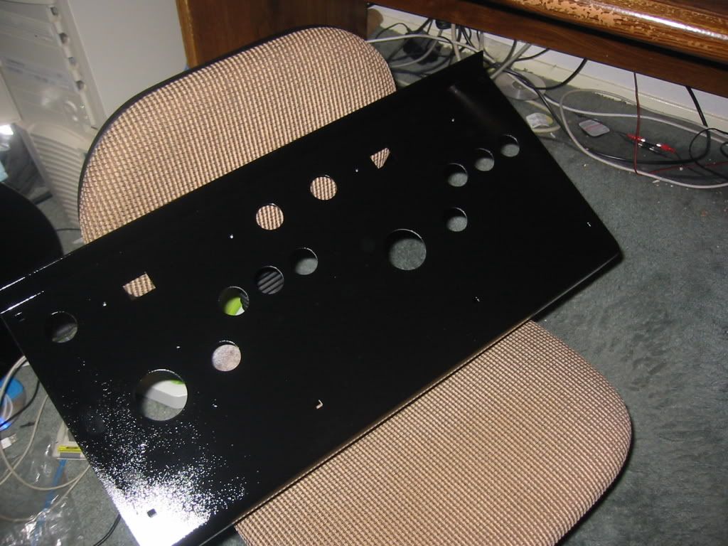

« Reply #17 on: March 24, 2009, 02:06:57 pm »
Alright! The paint has been applied.  I'm sure a better job could have been done but since this is just a personal restore it's not that big of a deal. If I ever decide to actually make some money on this cab I'll just strip the cp and do it again.  you can see a bit of texture on the paint, and honestly I don't know why that is.  It's got 2 coats of primer, sanded after each coat and cleaned nicely with a soft brush and some windex after I let the primer dry completely.
Then, it's got six coats of Krylon Rust Tough gloss black enamel.  I sprayed each coat lightly, and let it sit for about 3 or 4 minutes between coats, then let it dry overnight. It's still curing so I'm not going to attempt to apply the CPO yet. Probably won't do that until at least Wednesday evening at the soonest.  Here's a pic.
