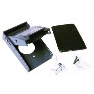

Well after years I finally finished my cab. And it works great. And it looks the nuts. Hurrah! Only trouble is, when I was at the design stage, the stage where I decided to put my three admin buttons Pause, Quit and POWER, at the bottom of the CP, I didn't have a little two-year-old boy who really likes pressing buttons (you can guess where this is headed, right?)
I really don't want to move the buttons to the top of the cab (above the screen) which is my only other alternative - I don't want three 29mm holes showing under the panel - so I was wondering if you can buy purpose-built covers for the buttons? IE, flip the cover open, press the button, close the cover again. Nothing too taxing but certainly enough to deter an opportunistic two-year-old.
Any/all ideas gratefully received!

If you don't mind putting a couple screws in your machine you can get some sort of recepticle cover. The kind of thing they put over outdoor outlets.
