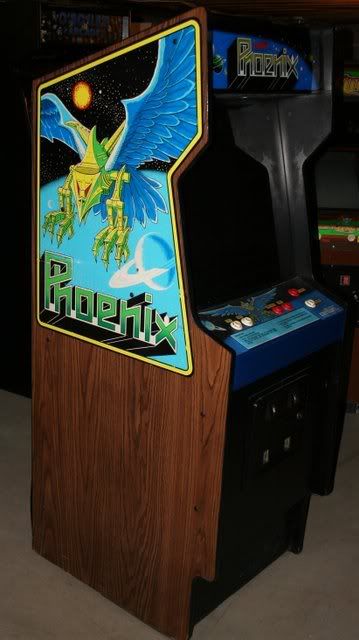

A PHOENIX rises from the ashes

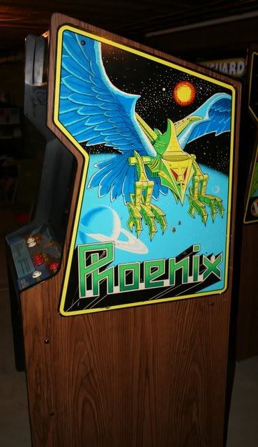

« on: February 10, 2010, 12:00:42 pm »

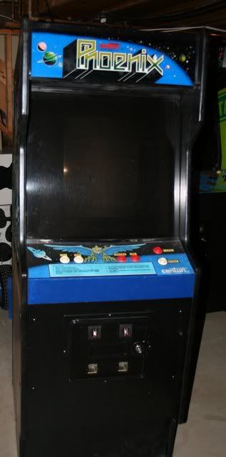

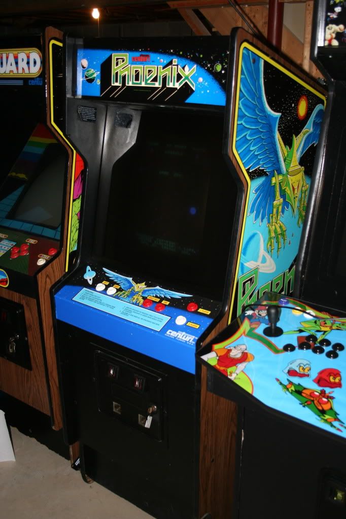

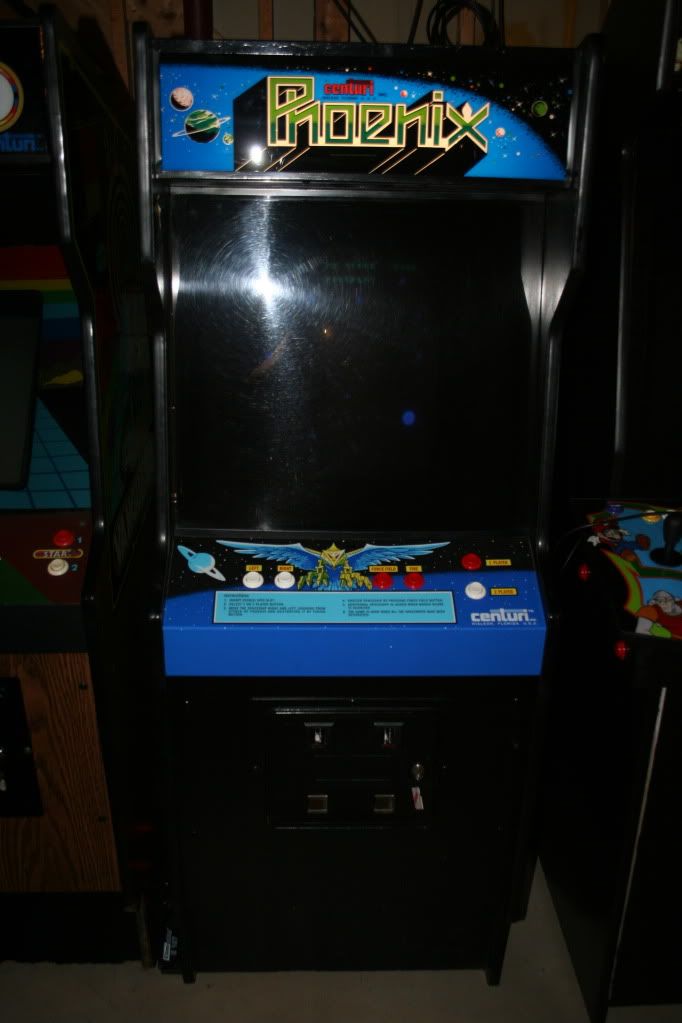

Okay, not really rising from the ashes as this one is in pretty good shape...but I liked the title   ;D
One of my favorite games growing up.
Overall in nice shape.  I'll need to do some work on the bottom as cab doesn't sit straight (might be a structural issue and not just an issue with the leg levelers)
Game is working, but the monitor colors are off.  Also, after a few minutes, the monitor gets very dim and eventually goes dark.  A few minutes later it comes back on but repeats the process.  I'll do a cap kit on it and see where I end up.

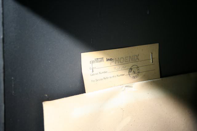

Serial #3401 and the envelope beneath the tag contains all the manuals and schematics.  Always nice when the originals are present and by the looks of them, never touched

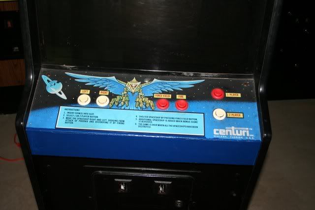

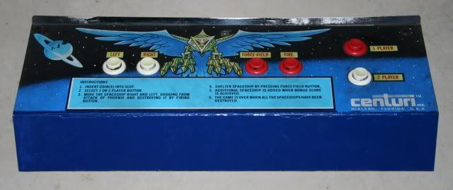

The major cosmetic issues are the control panel and the marquee.
The control panel has been painted blue on the front to cover up some damage
and the marquee is flaking badly letting the light just shine through

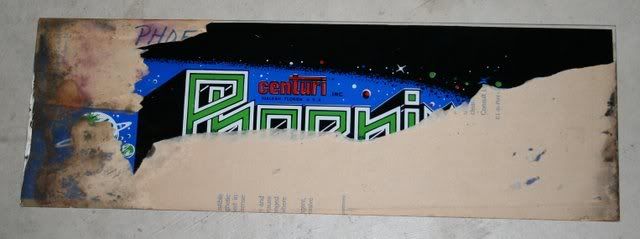

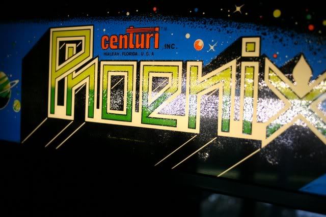

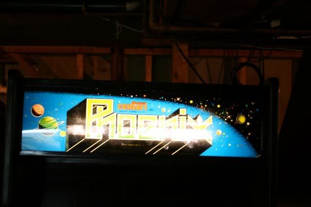

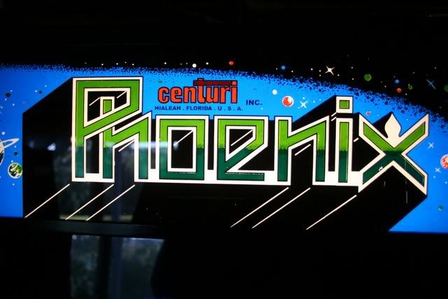

Let's tackle the marquee first.  MikesArcade had reproductions available, but now are down to just the seconds.  I picked one up and while it does have some scratches in it around the "X" (hence the seconds), it still looks a ton better than the old one.
Original one for comparison
I thought I had solved the scratch issue when I picked up a NOS marquee
After removing all the paper masking, I went to put it in the cab and found out that it was too big.  I'm not sure what cab these were designed for but it doesn't fit.  Looking at the graphics, they didn't stretch anything, but just added more black around the edges.  If I want to, I guess I can cut it to size.
« Last Edit: February 10, 2010, 12:45:16 pm by Spyridon »

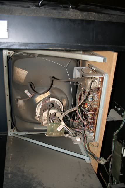

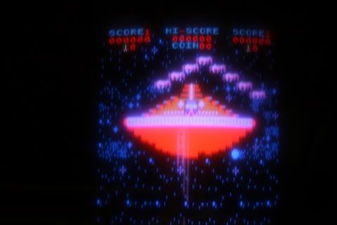

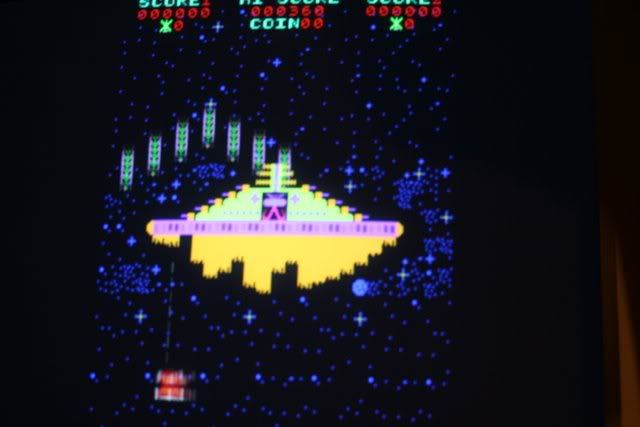

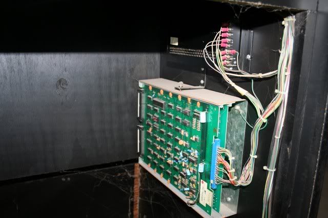

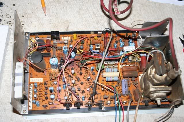

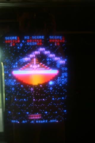

Next up was the monitor issues.
The monitor is a Toei CM-A20HC monitor which is something I haven't encountered before.
Pulled the chassis and installed the cap kit
Picture was much brighter but the colors were still off.  I also had a degassing issue as colors would change in different locations.  Not having the appropriate tool to handle this, I improvised and used a magnet.  A few waves with the magnet and some tweaking of the colors and I was able to get the color corrected.
Before cap kit and adjustment:
After:
At first, I still had the monitor going dim on me but that has since gone away.  I have been running the game regularly and the monitor has been perfect.

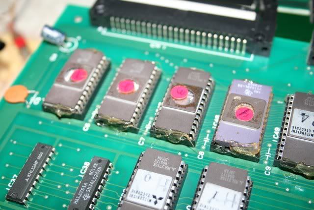

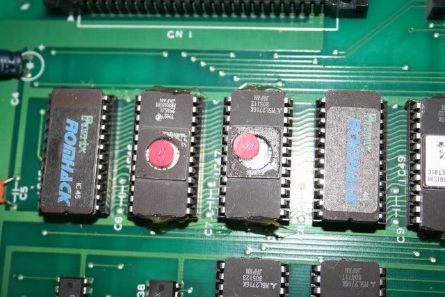

Since Phoenix has no freeplay, I installed the freeplay ROM hack from Jeffs ROMHACK.  (now if someone would only come up with a way to save high scores)
I've never seen someone use glue (or some type of epoxy) to hold the chips in place.  It peels off without too much trouble.

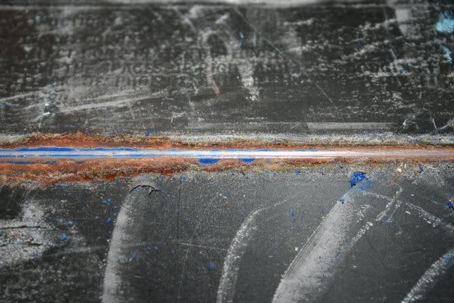

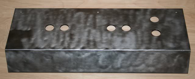

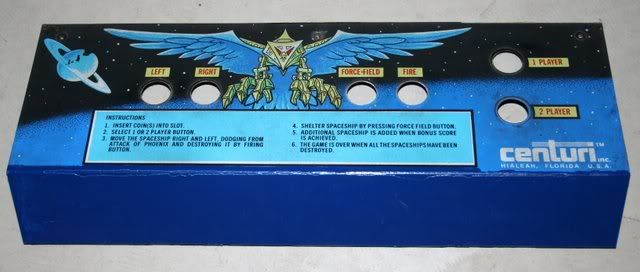

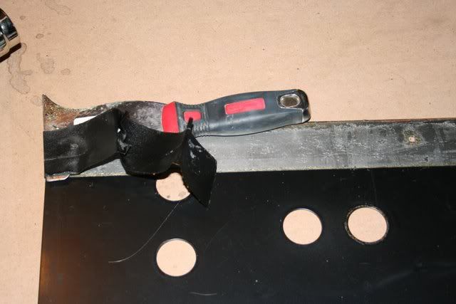

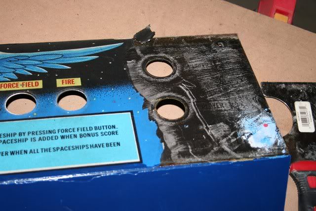

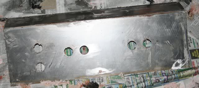

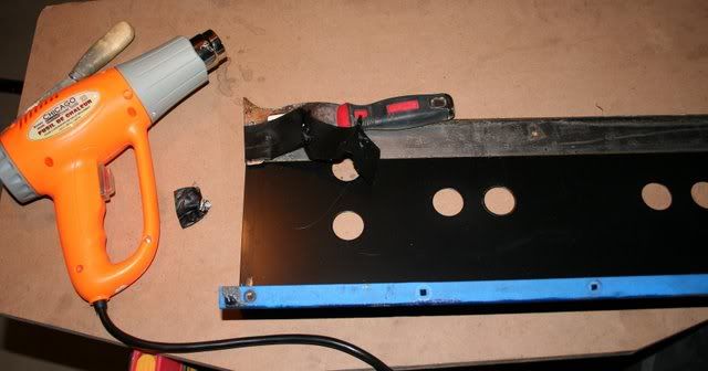

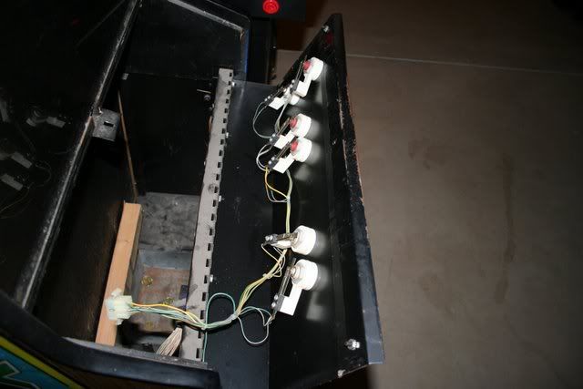

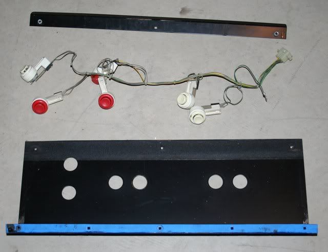

Time to start working on the control panel
Panel was removed from the cab
and depopulated

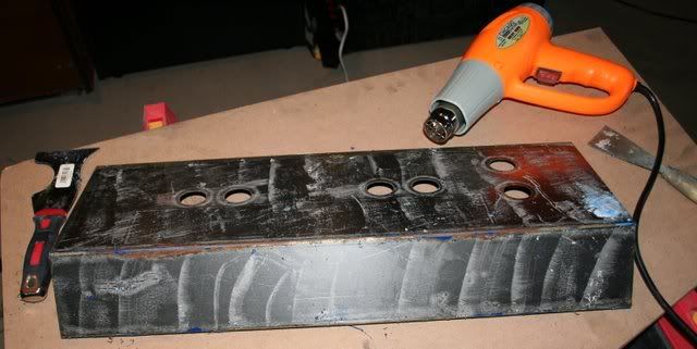

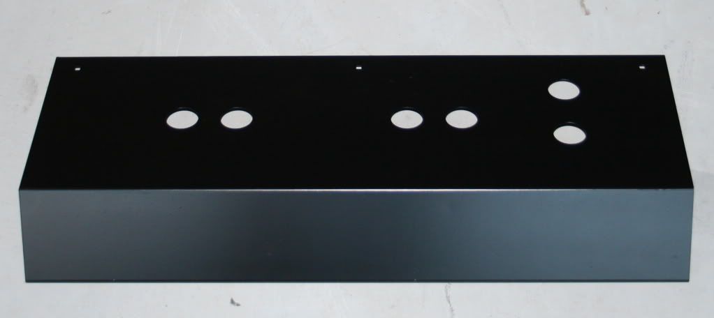

Heat gun and a scraper made short work of the overlay
I have some rust spots I'll have to deal with
A coating of Citristrip takes off the remaining adhesive
and leaves you with a clean panel
I picked up a new overlay from QuarterArcade that will go on once the panel prep is done

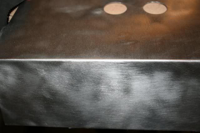

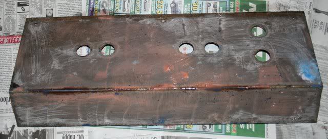

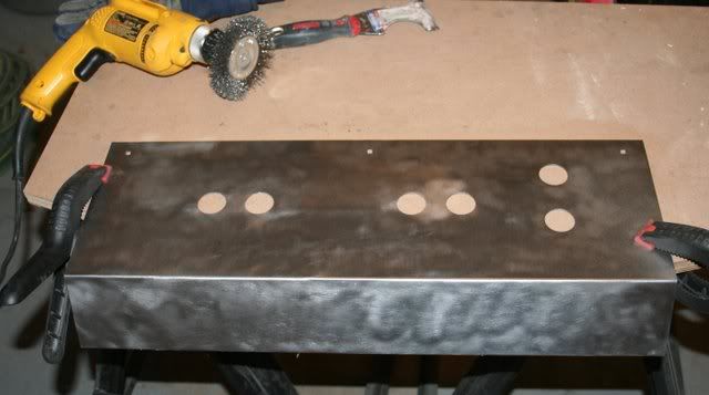

Today, I used a wire brush on a drill to take off any rust and what little residue was left after the Citristrip
This easily removes the rust
And the panel is now ready to be primed

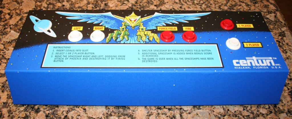

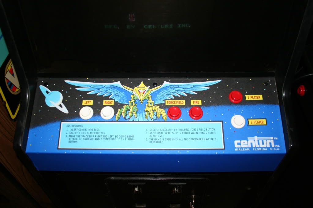

Okay, it's been a while but I'm back!  Work has keep me on the road quite a bit, so all the restorations I had planned didn't get done.  Finally got some time to work on Phoenix.
When we last left...
The control panel had been stripped bare.  This week, I painted the front and back with a coat of Rustoleum Satin Black.
Once that was dry, I needed a few items.

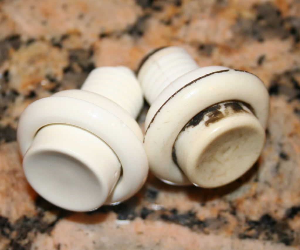

New overlay...check

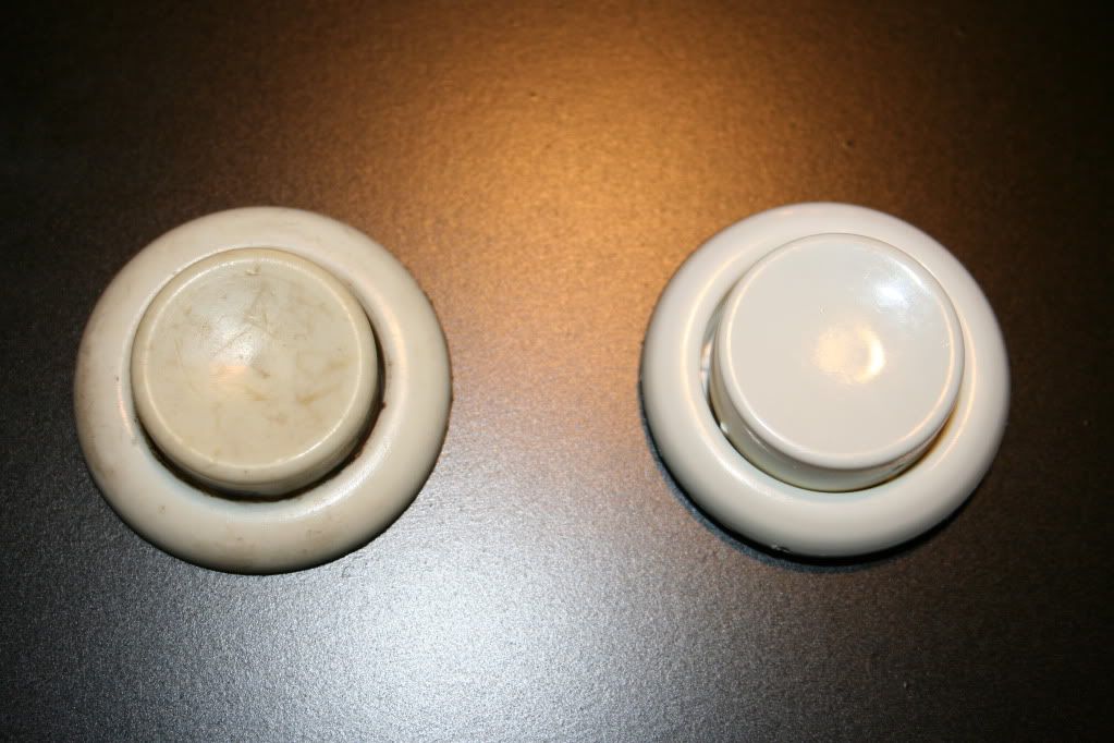

New buttons...check
The ones on the cab were too filthy to spend the time cleaning (especially when new ones are so cheap)
Much better:

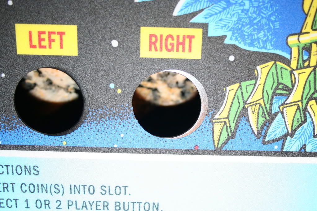

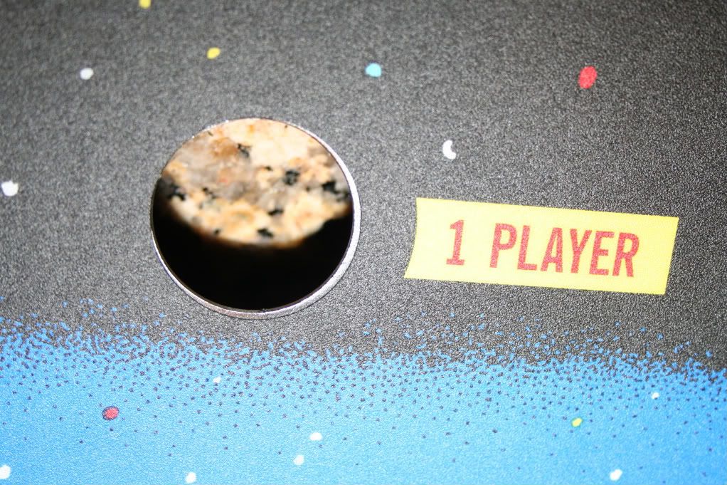

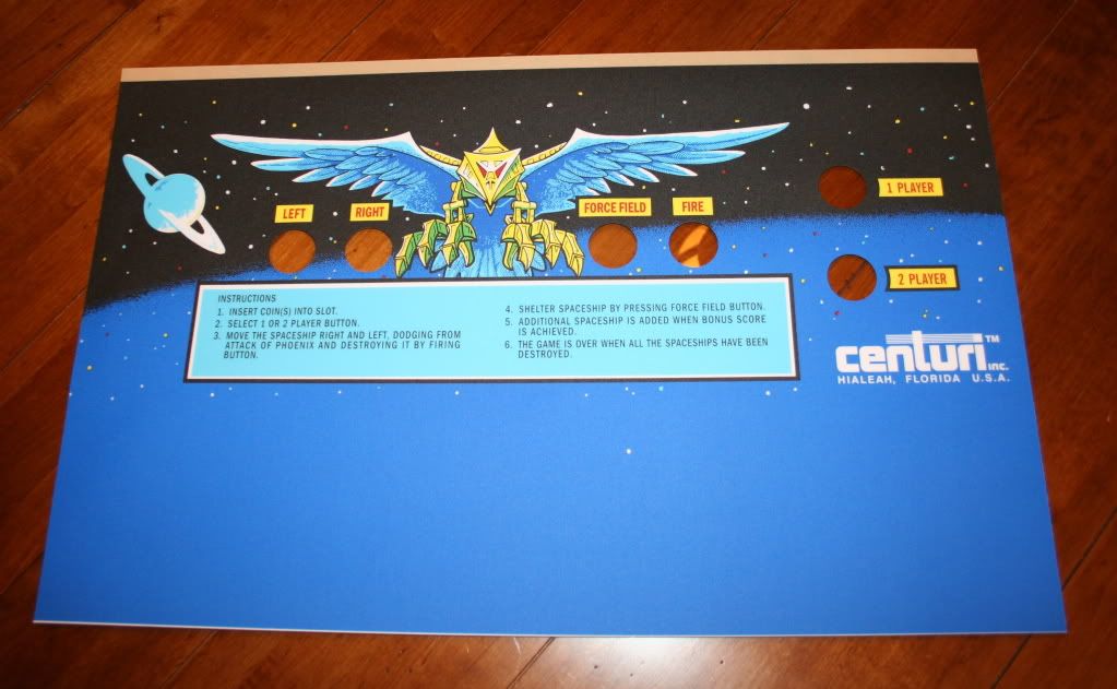

Overlay went on smoothly, but I was a bit disappointed with it.  While the material and printing quality were top notch, the holes were not lined up perfectly with the control panel.  There was no way to get them all to line up so I had to find the best spot.
In order to get the buttons on the right side somewhat close (but not perfect as sacrifices had to happen across the panel)
by the time you got to the left side, you were left with this
In the end it's not that big a deal as the outer edge of the buttons covers up any imperfections.
Finally, new buttons and harness installed

Looks like a nice light resto for you, looks like the cabinet was really well taken care of over the years. Though, the structural leveling might be a PITA.
The side art and wood paneling looks great!
btw, I find a quick way of cleaning buttons is removing the spring and e-clips, and putting the plastic parts in the dishwasher. They're perfectly safe, and comes out looking great most of the time, either that or it gets a lot of the work done for you.

The buttons on my phoenix were too bad for a simple cleaning too, so mine were replaced also. I had the same problem with the overlay, but in my case it was compounded by the fact that when I settled on the ideal positioning, it meant a bit of uncovered CP - like 1/16" to 1/8". I painted my cp white because I've heard that the whites in the overlays can sometimes look less brilliant with dark paint underneath. So I need to touch up the uncovered edge of my cp.
Anthony told me the poor alignment of the holes is due to variation in the hole positioning in the cp itself. I'd be fine with that explanation but why not make sure there is plenty of overlay to extend to the edges of the cp regardless of where the cp holes are. :( Oh well, not a big deal really.

Painted the carriage bolts and the metal piece at the top of the control panel and installed it on the game.
Spyridon
  • Posts: 1480
Re: A PHOENIX rises from the ashes
« Reply #18 on: August 04, 2010, 10:06:05 pm »
Before and after control panel comparison:
IG-88
  • Posts: 2042
  • Posts: 48,764
« Reply #19 on: August 04, 2010, 11:03:16 pm »
The CP colors/details look a little faded out in the second pic. I take it thats due to the camera flash or angle? (I hope)
Was it typical for player one to be on the right side?
Overall fantastic job! I really enjoy your restores!
-HarumaN
  • Posts: 6173
« Reply #20 on: August 05, 2010, 02:29:14 am »
You're a machine! Great work! :applaud:  :cheers:
Spyridon
  • Posts: 1480
« Reply #21 on: August 05, 2010, 09:43:14 am »
Probably the flash as the yellow on the new overlay is very vibrant compared to the faded old one.
It's just a single player game.  Left / Right buttons are in white and the Shield and Fire are in red.
