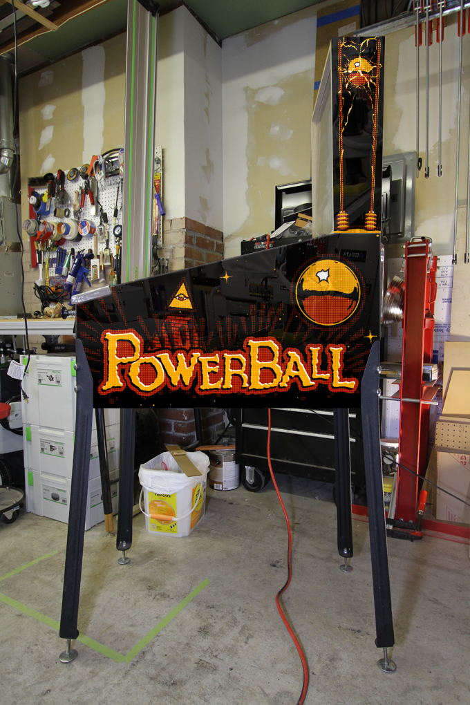

Post #7: Where Mike decides his runner-up theme name is cooler...
« Reply #13 on: July 05, 2010, 07:30:38 pm »
Thanks Doc, mighty kind of you!
Post #7: Where Mike decides his runner-up theme name is cooler than his former first choice.
I spent a little time in photoshop mocking up the cabinet visuals today... My goal is to cover a majority of the cabinet in acrylic, backpainted like the Léon control panel in my sig (which is also why the color palette is limited).
The visuals are supposed to be DMD-inspired, although a little fancier, and the acrylic (if I can pull this off) will allow me to backlight some of the imagery (probably the "PowerBall" text). The stars are also a prime candidate for some sort of LED-controller attract-mode, which would be cool, since I've never played with those controllers before).
Anyway, just a first draft... hopefully I can figure out some ways to refine (and I'm always open to suggestions).
« Last Edit: July 05, 2010, 07:35:00 pm by MikeDeuce »
  • Posts: 2019
  • Last login:February 23, 2026, 02:55:37 pm
Re: PowerBall: 24"/17"/5" TZ-themed mini-pinball
« Reply #14 on: July 06, 2010, 04:06:25 am »
WOW!  :applaud:
Getting the sides lit up will look spectacular I'm sure, considering the skill you've show off in your previous posts. Hat's off to you sir.  :notworthy:

Any chance you live in NE or IA?  I would love to come check this thing out.  Amazing!
What kind of video card are you running and how do you have the outputs going into the 3 lcd panels?  One video card with 3 outs?  I kind of grasp the playfield and the top art panel outs but how you are managing the middle small panel is crazy, unless the software does all that for you.
What is the function of the ball plunger rather than the button?  Obviously very authentic and cool but does it have full functionality, the harder you pull it back the farther the ball somehow goes?
