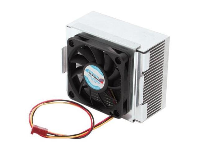

Today the replacement PSU for the laptop arrived. Previously I resurrected the Acer with a PSU from a different Acer so that wasn't a long term answer.  The replacement came in from, you guessed it, eBay, for under $9 delivered. I decided to give it a burn in (upper left resting on the bezel), and at the same time hook up the ELO:
The new PSU seems to run hotter than I expected, even though it is not charging a battery. If it lasts the next couple of days, I might break it open so it can breathe better. You can see it alligator clipped to the broken power jack on motherboard in the lower left of this pic:
My son calls this one "oodles of noodles":
Because the laptop is decased and all the supports for components are built into the bottom half of the case, I had to come up with a way to secure the HDD. Utilizing an upside down PCB mounting foot in one pre-existing hole, and drilling out a second hole, I was able to lock the drive down:
Finally, a couple pieces of aluminized tape for my HVAC holds the fan in position to cool off the heat sink:
And I'll let everything sit all night and maybe into the weekend.

I also discovered that the Dell Dimension 3000 has a MONSTER of a heatsink, and a really annoying big ass fan+shroud setup for cooling the CPU that attaches to the case itself (not the h.s.), so it doesn't play nice with decasing. I've got a much lower profile heatsink+fan combo that arrived today that I will be using...just as soon as the new heatsink bracket arrives (to replace another Dell custom p.o.s.).
Heatsink bracket arrived today and smoothly replaced the Dell bracket. Here's the before with the big copper monster and no fan, and after with the lower profile hs-fan unit:
