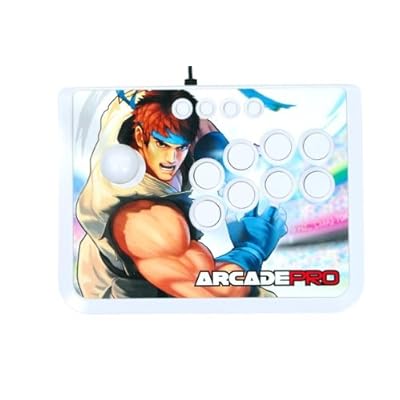

check amazon for the datel stick . its the same pcb as above for 54 $ . i ordered 2 of it for 23 euro each some time ago . lately they rised the price to 28 euro . its the best 360 pcb u can find . very small , all com ground and idiotproof soldering. far better than the madcatz shitsticks i used .
http://www.amazon.de/PS3-Xbox360-Arcade-Pro-Joystick/dp/B00361GDJM
