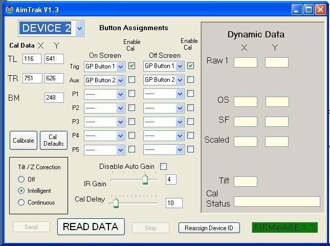

Some questions i hope some one can help me with :)
1. I have enabled light gun=1 lightgun=mouse dualguns=1 in the mame config
the first gun seems to work fine now..
but when im in game it appears the second gun is allocated the same device (mouse) is there anyway to get it load as a separate device?
2. do i need to change any axis data within the game configuration as with alien3 i couldnt get it to register the input at all, if i say select an axis it always comes up with "mouse X"
3. is there anyway to get the x and y axis working with the aimtrak game controller option rather than a mouse, the reason i ask is because my pc games - house of the dead/virtua cop etc (the m2 emulator stutters on my machine) will only allow me to allocate one mouse (i.e player1) if i allocate the game pad to controller 2 the x+y axis dont seem to work - i also tested this from the game controllers section in windows.
4. is there any way to calibrate the gun within mame itself
thanks you :)

1) in the Aimtrak utility did you make the second gun device 2?
2) the Aimtrak is seen as a mouse and you have to configure your X and Y in mame (by "tabing" into mame) X axis is left and right, Y axis is up and down.
3) not sure what to do there
4) You can calibrate in mame as long as you didn't dissable the calibration in the Aimtrak utility....you should be able to initiate the calibration by holdint the trigger down for 5 or more seconds.
Hope this helps
The pic below I have player one configured.
This is the configuration from the Aimtrak utility.
« Last Edit: January 31, 2010, 12:13:25 pm by Drakin »

plug just the gun you want to make gun to into the computer and start the Aimtrak utility,,,in the utility click the box at the bottom that says "reassign device id". The next box select device 2 and send. now see if the gun shows up as gun 2.

right finally figured it out.
firstly i spoke to andy and he said he would look in to developing movement of the x+y axis on the game controllers that windows detect (instead of just the mouse) in the next firmware release
so we can play pc games like hotd 2 player + psx etc
the reason i couldnt get multiple guns to work is i was running some ancient mame version so to any one else who has this issue.
download latest mame : http://www.emulator-zone.com/download.php/emulators/arcade/mame/official_version/winmame/mame0136b.exe
enable multimouse, lightgun mouse  and mouse
Then to configure the x+y axis within mame follow the following - http://derrick.mameworld.info/lightgun/Act_Labs_Light_Guns_on_XP.html
hey presto :)
