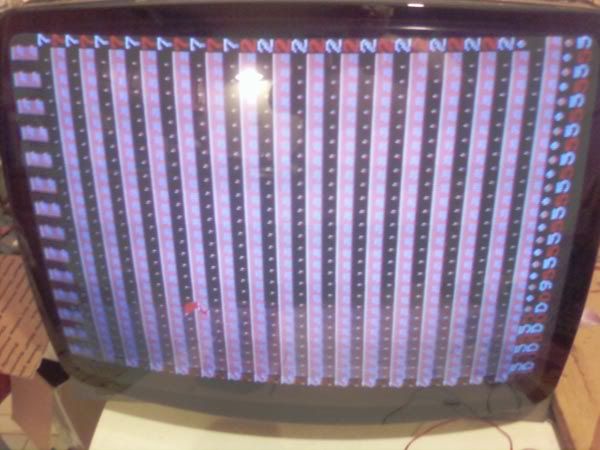

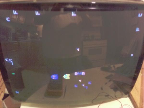

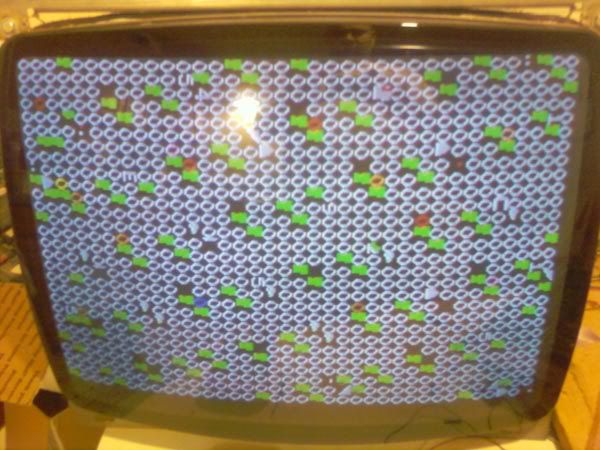

4th board here
this one seems to be fun
power up all 0's and fruit cycling
replaced all 6 vrams to see if it cured the matter
0's went away now i have random garbage
incert abc diag board gets worse garbage and once 0's came back
un socketed reincerted all socketed chips nothing has changed
put orig aux boasrd back on sometime get little garbage and sometime get much garbage
replaced eproms and proms now exhausted all easy fix stuff (socketed)
ran down traces for vram none are broken from scratches etc
here is what i see so far
two of many garbage screens with aux board installed bars dance other crap moves around
after abc diag board installed game rom
after diagnoistic rom installed
from the picures you can see the diagnostic board is workign i can slect and use buttons etc jsut have no clue what im looking at lol
