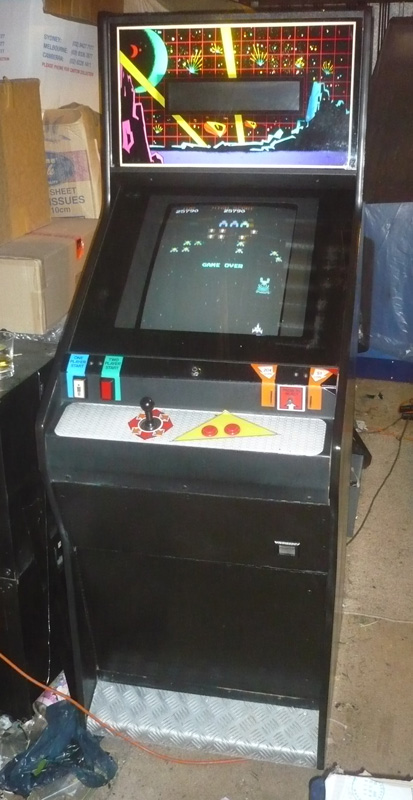

RGB through SCART to a good quality TV will give you simply superb results.
Here is a project I have just finished. It is a lowboy cab with a 20" Thomson TV (SCART) mounted vertically. Thomson TVs respond very well to the VGA->SCART hack, and the cable can be pretty simple. I even wired this cab as JAMMA-SCART so that I could plug in a PCB (in this case, a 48-in-one PCB).
The pinout posted by "commander" looks good - except that you can make it even simpler by just joining up all the RGB grounds and "grounding" them to the same point as all the other grounds (they are all common anyway - test with your multimeter if you don't believe me!) :) (edit: when the cable is plugged in)
Review our pinned SCART thread for more details!

« Reply #6 on: October 08, 2009, 06:08:45 pm »
It's difficult to see much in a picture, but yeah, they look pretty sweet.
I noticed you've posted a lot in the RGB SCART thread (and you obviously know what you're talking about!), I'll post any further questions I may have in there if I get stuck. Assuming I don't blow something up, or electrocute myself removing my arcade monitor.
I'm not very hardware savy....
