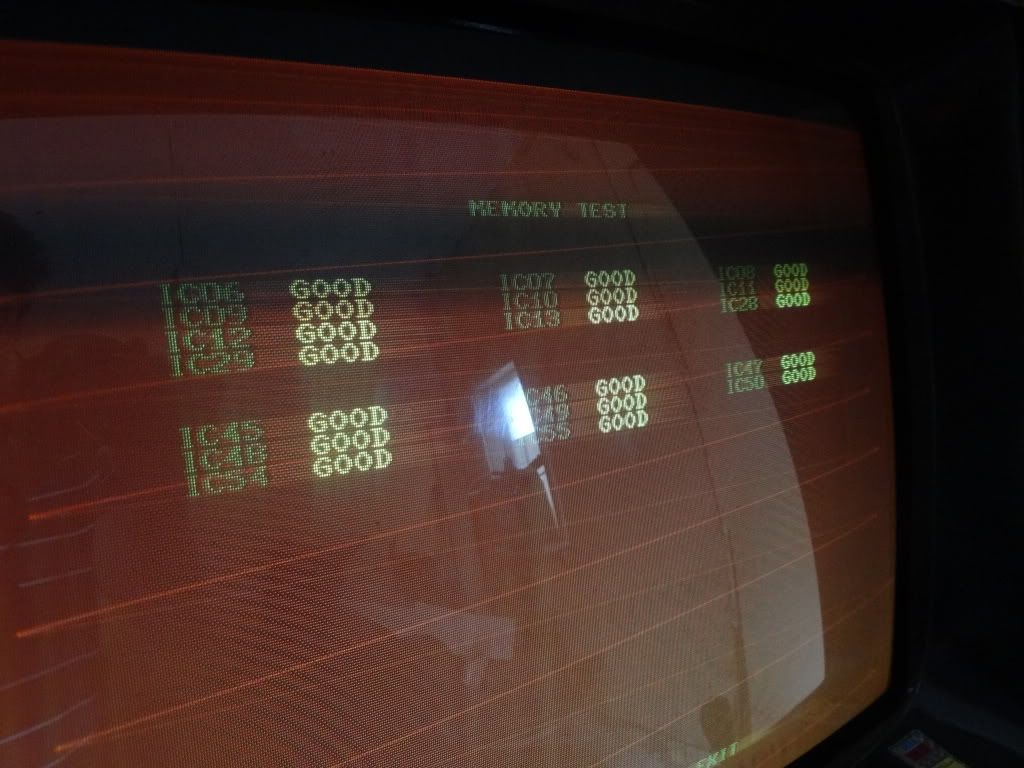

I'd forgotten that I had another med res Polo. The CRT came with the fuse blowing chassis has a suspected cracked neck, so I'm also going to try and fix the other one that has the good accompanying tube.
It's very red and has retrace lines. I guess I need to turn down the voltage on the LOPT?
grantspain
  • Posts: 6177
Re: Hantarex Polo 25 - keeps blowing fuses.
« Reply #11 on: August 07, 2011, 10:19:11 am »
red drive tranisitor or red background too high
sevenleaf
  • Posts: 30
  • Last login:April 02, 2013, 10:08:35 am
« Reply #12 on: August 07, 2011, 05:29:15 pm »
Thanks mate. Changed both transistors and the capacitor (on the red path) that Randy suggests and its now all turned green! Will change the rest of them next weekend.
Also the lopt is already turned down as low as it will go...

« Reply #16 on: August 10, 2011, 10:39:53 am »
something is shorting straight to earth,ic101 is possible and r103-which i think is a ntc
Changed IC101, still blows the fuse. R104 is NTC10 but I can't find a replacement one online :-\
you need to change a few other caps,4.7uf 250v on the neck card will be a good start-also there are a couple of 100uf 250v and a 47uf 250v (c14,c177,c168)
I changed T2,4,6, T3,5,7, C1,2,3 and IC1 (yet to order the ones you said) and got the best picture yet. The picture was bent in on the edges and the blacks and whites were displaying wrong so I adjusted the pincushion board, turned down the R and B pots on the neck PCB and turned up the screen voltage on the LOPT.
Do you think it could do with a whole cap kit or just the ones you mentioned above? Or just setting up properly (the tube and chassis didn't come together you see)?
grantspain
  • Posts: 6177
« Reply #17 on: August 10, 2011, 03:50:10 pm »
just looks like green overdriving to me
sevenleaf
  • Posts: 30
« Reply #18 on: August 10, 2011, 05:19:57 pm »
There's no green pot on the neck board, do I just have to balance it with the r and b?
grantspain
  • Posts: 6177
« Reply #19 on: August 10, 2011, 05:39:55 pm »
there will be a green cut off pot-you should have 3 colour cut offs and 2 colour gains on the neck card
